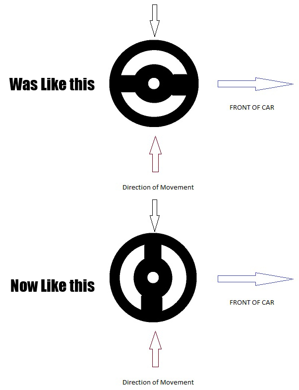

ive had the exact same problem with mine so what ive done is this... (Hope its Legal)
ive got myself another bush & turned it 45 deg then re fitted it like in the pic below.. its now solid & no movement at all.. BUT will it be legal.? :confused:
is the TRW parts genuine or near as..? as thats what make the bush was.. 11 quids better than 150 quid for a new arm..

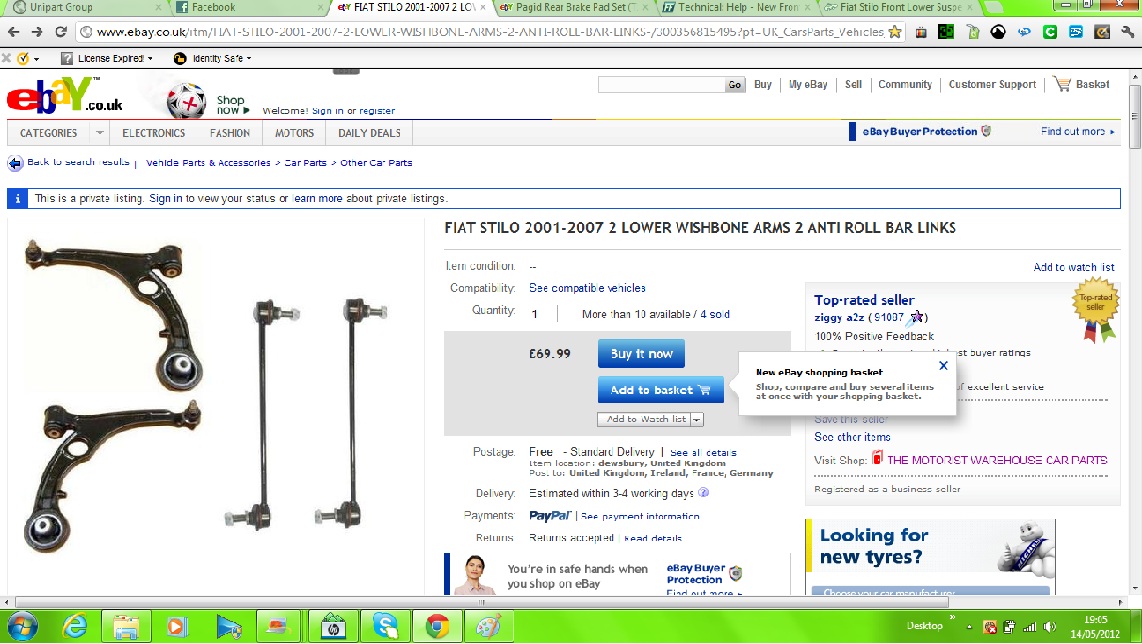

Hi Steve148, I was just wondering where you purchased your first set of wishbones from, ebay? if so do you know who you brought them off. Im in need of a pair as my Stilo has failed its MOT today and the garage told me the greatest joke Ive ever heard
"your looking at about £360 including labour mate and if you need the 14mm bushes instead of the 12mm it could cost you more"
Ive found a shop on ebay, (attached a photo of it) not sure if it would be worth buying these parts or paying roughly £100 for the lower wishbones from the aforementioned shop, Shop for parts. The final option I have is to pay about £56 including delivery for breakers parts. Would appreciate any feedback or opinions.

Yes, I used shop4parts to replace the dodgy ones, and they were fine. I've used them many times, always had high-quality parts.
This opinion is now under review. The shop4parts wishbones failed dangerously after less than 20,000 miles, and the proprietor advises me that this is a reasonable service life to expect from the quality he supplies. :eek:
