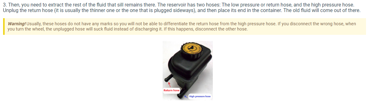

Which hose is return on power steering reservoir? It should be the big one in the front, right?
I tried to flush power steering fluid out of my Doblo. I removed big hose from reservoir and plugged the reservoir where the hose was. Then I poured a bit of fluid in reservoir and started engine and started turning the wheel. I expected oil would flow into the small hose (and the old oil would come out of big hose, which would then be captured and discarded) but opposite happened: oil started filling and raising in the reservoir and it started flowing out and spilling everywhere... It seems as if the return hose is the small one in the back and that front hose is intake?? Is this possible or is there something I dont understand here? I thought this way a super simple job to do..
