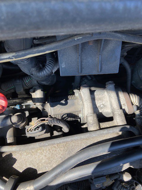

S stratpod Member Joined Feb 11, 2019 Messages 15 Points 54 Sep 2, 2023 #1 On my !>9 2005 can i just remove the plastic part on the EGR and clean , or do i have to remove the whole unit ?
B bugsymike Patron member Joined Jul 2, 2022 Messages 4,959 Points 1,554 Location Torbay Sep 2, 2023 #2 To clean it properly would mean removing completely , but many of that age 1.9s have simply bought the blanking plate for the two bolt flange on the end and have bypassed it quite happily, your choice. Upvote 0 Downvote
