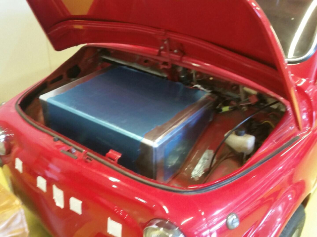

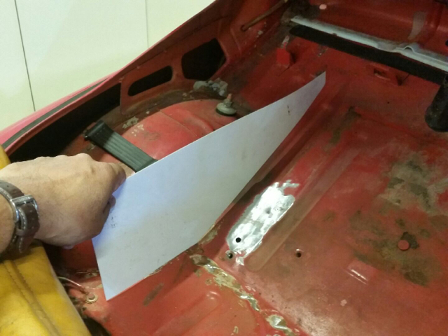

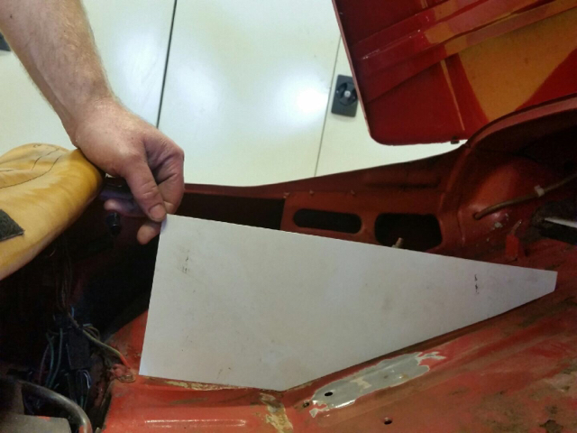

Short update, working on a custom fuel tank with my fabricator. Not fussed about losing front boot space, as without back seats I'll have plenty of space for overnight bags etc.
Test profile to get a feel of free space etc. I will keep about 100-150mm gap on the side nearest to left wheel arch to allow space for better placement of fluid reservoirs, additional fuse box etc.
I need to relocate the standard fittings to make room for the adjuster on the new dampers.
With this profile and the target width, we should be able to get 35-36 liters, which will allow me to cover a little more ground on the highway without having to stop at every petrol station I drive past.
Tank will be aluminum, internally baffled, with 5 zones, and modern fuel sender unit, rollover valve, and foam-packed.

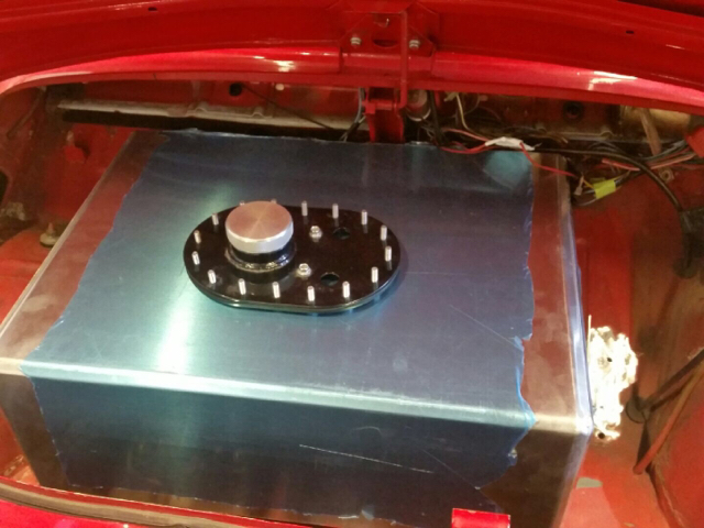

Re: Enzo the Cinquecento - 500L 110F RestoMod
Fuel tank body is nearly done. Will need to do a proper fill-test for exact volume, but on my high-school maths we're looking at 35/36 litres. Now just trying to source a suitable filler spout, flange, spill tray etc
Thinking a Monza filler will look best on the brushed alloy.

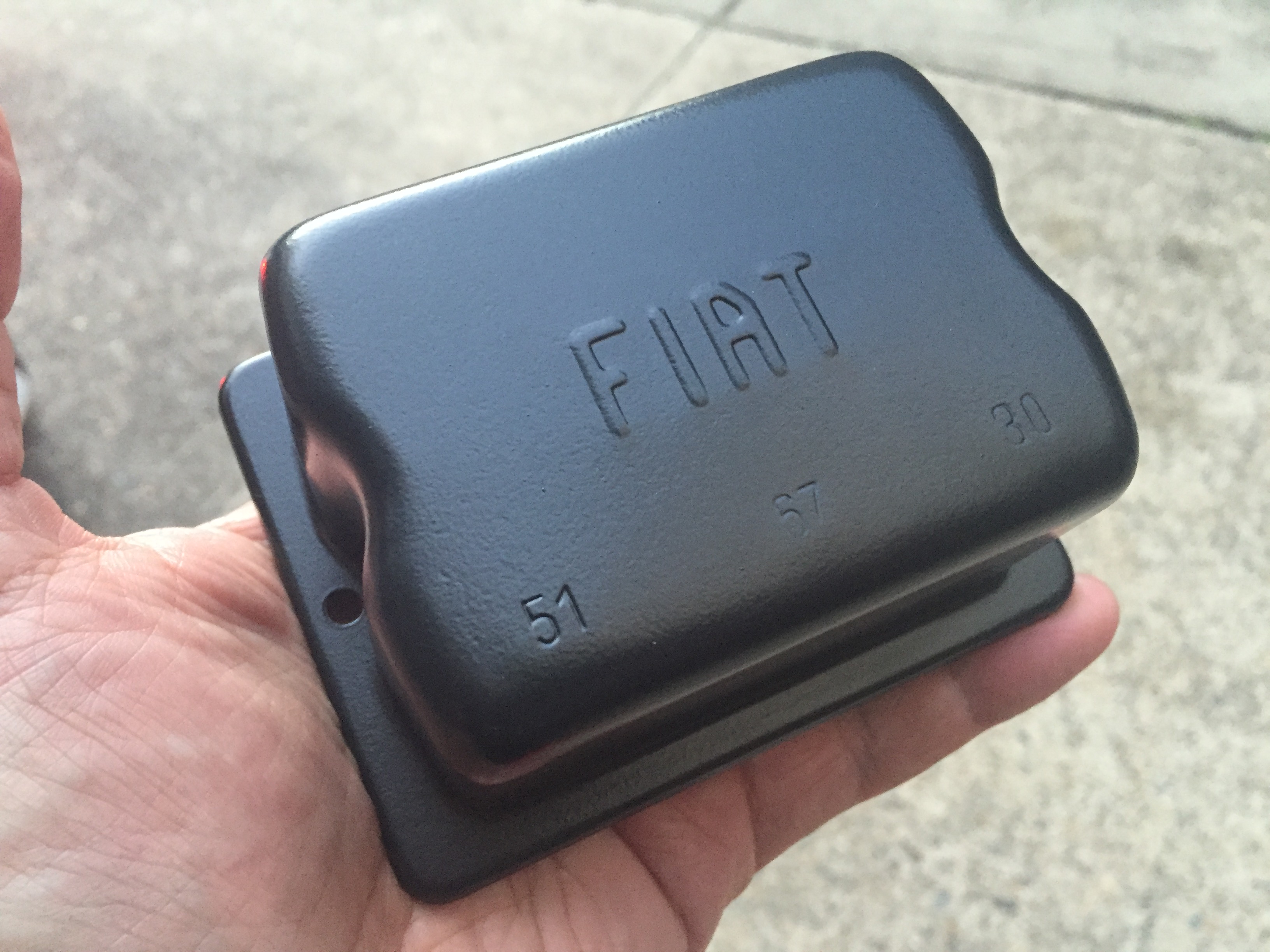

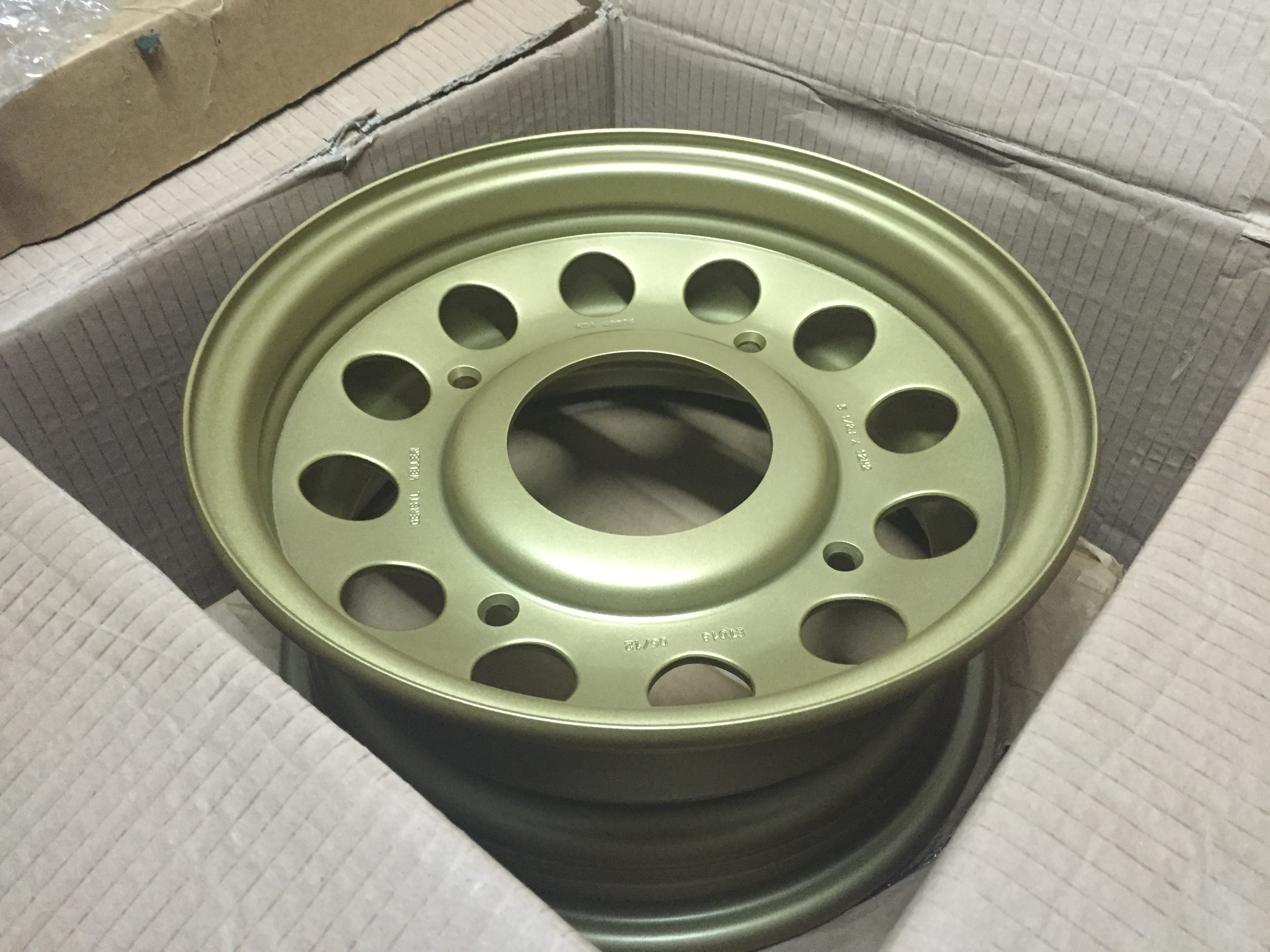

I picked up some parts from the powdercoaters yesterday.
Original Logotech/Wheeltech 12x5.5 +18 wheels. These are no longer available and I contacted the manufacturer to see if they knew where I could get some. They had a set sitting in storage that didn't pass quality control back when they were manufactured due to poor painting. I got them for a very good price, got them x-rayed at an NDT lab, then zinc-coated, and powder coated "Gold Tarnish". They look brand new and will look great on the finished car!
I also had the voltage regulator cover re-done too. In a hi-temp black powder coating. Looks very good, but also shows a bit of it's age with a slight wear on the letter/numbering, which I'm really happy with.
There was evidence of at least one engine fire prior to the one I had when I first got the car, so this cover was an absolute mess beforehand.

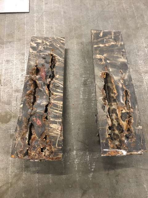

Agree, they look good. So Axel Gerstl has stopped selling them I take it. That's a shame.
btw - not sure that an X-ray on a steel would have been very productive. I've always found a lump hammer corrects any problems with a steel wheel. ;) ;) ;)
Yes, AG don't have new stock but did help me source this set.
I had to X-Ray to check the welds as the wheels had failed quality control at the factory in the past. Structurally they were ok, however they needed to be completely stripped and recoated so I could do a visual inspection too.

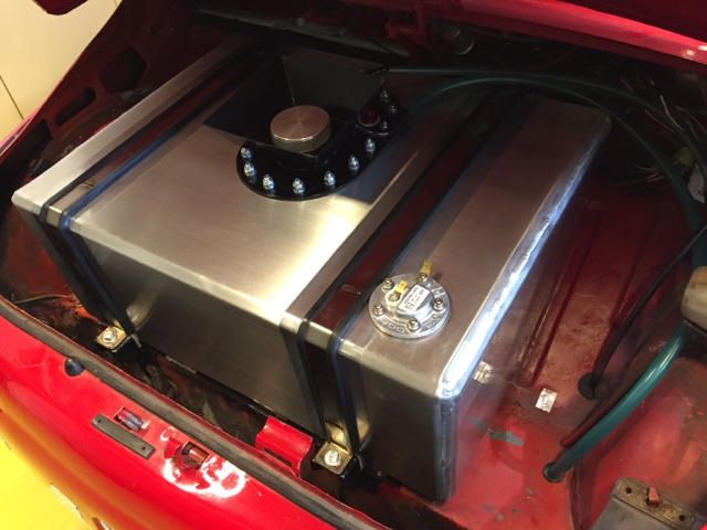

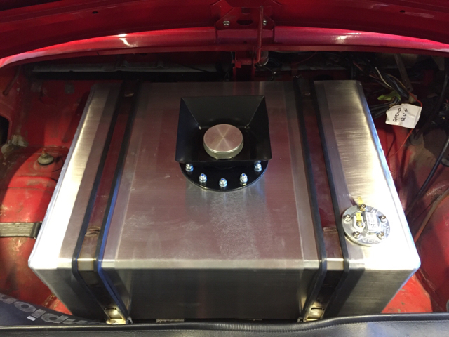

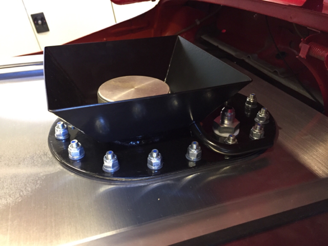

More progress shots.
Nowhere in Australia stocked the screw-on flange required to mount a Monza-type filler cap, so we went with something retro race car instead.
Picture doesn't show final filler location. The filler will be dead center of the tank, with breather and pick-up lines routed to the back. Steel straps wrapped in rubber will be mounted using existing tank tabs.
VDO tube-type fuel sender unit will be installed driver-side front corner.
Breather pipe will be routed through the drain hole at the base of the A-pillar.
Pick-up bag in baffled swirl pot, and rest of tank will be foam-filled.
Tank is aluminum and will be finished in a longitudinal brushed scotch-brite.

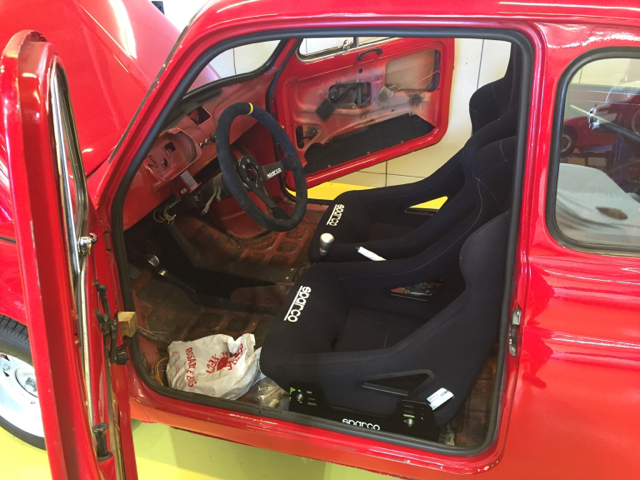

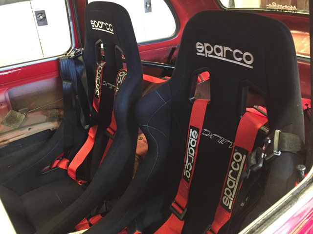

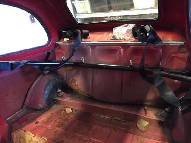

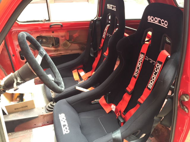

Final seat-fitting completed, whilst lowering steering rack slightly, we re-centered the wheel to the new seating position. I'm 6ft1 (183cm) tall and I have perfect arm position now, clear line of sight to instrument cluster, and about 4.5-inches of head-room.
The anchor points for existing/original seat belts have been integrated into new tether points for the floor-mounts, and using the existing mount on the b-pillar.
Bar-work now sent off to powdercoaters to be finished in satin black.

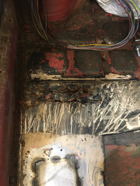

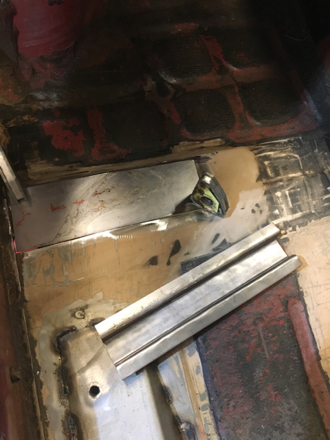

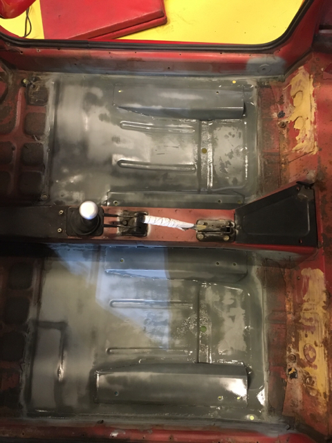

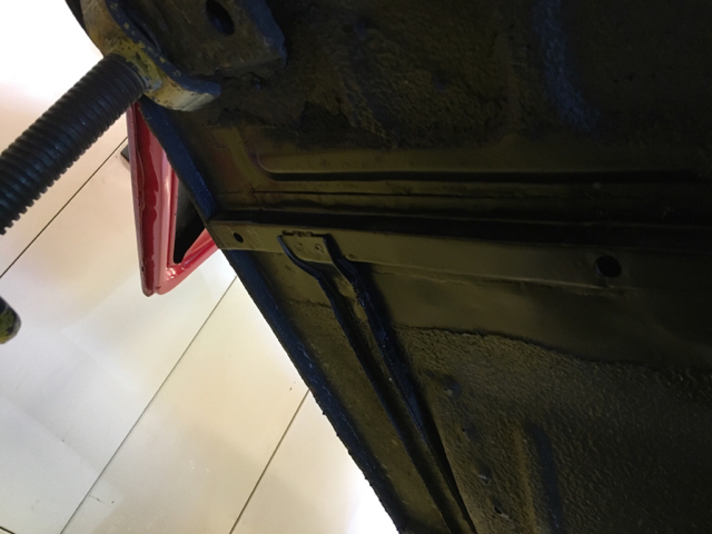

So there has not been much progress. I am still renovating my unit (very slowly) and therefore my little FIAT has not had much love. During the final install of the bucket seats we stripped back the floor tar to do a final check of the body and found some bad rust. To have it at this point and not fix it would be silly, so we cut out the sections, welded in some new fabricated channels to match, and gave it a hit of primer.
The footwell area located just along the door will and adjacent to the wheel arch.
Paper weights, anyone?
The new fabricated piece
Welded in place with a shot of primer
A good match to the original I think.

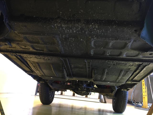

The underside re-done with stone guard
I have tiling, painting, and carpet going in next 2 weeks, and then I can move all my furniture back upstairs and have a garage back. Only 7 weeks until I need it for my wedding.
Cue the mission impossible music.....

Interior bar-work back from the powdercoaters and installed. Upper pick-up points for original seat belts have been retained; bolted in with bars.
Petrol tank nearly complete. VDO fuel-sender unit installed, central baffle chamber, fuel pick-up Matt, and full foam fill. 34.9L capacity!
Just need to install the Ae:ROFLMAO:ow plumbing up to the old fuel line.

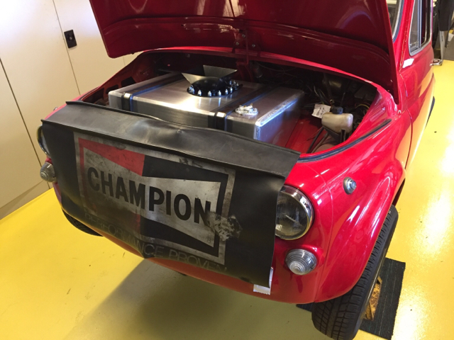

Seats and bars finally installed.
Fuel tank plumbed in, new hard lines front to back.

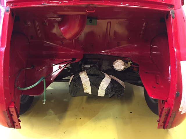

Engine bay stripped of all old tar and matting, re-sprayed with pressure pack for now.
