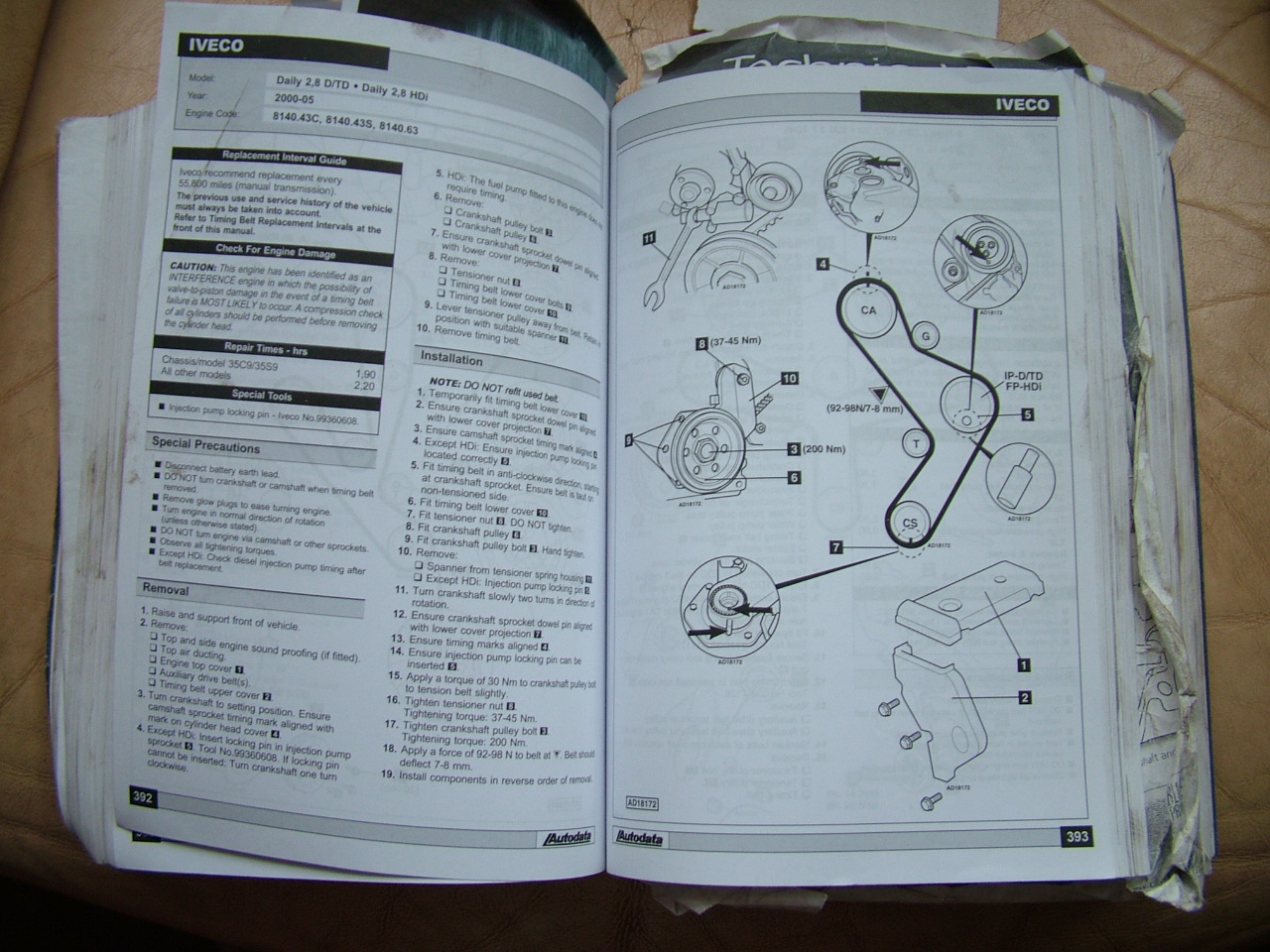

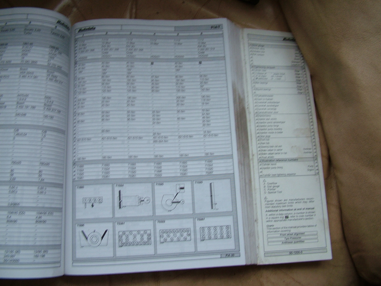

Sorry for picture quality, the 2012 book gives some detail on the 8140.47 but the 1995 book is only for the earlier version.
Re crankshaft pulley I would use an impact /pulse wrench to slacken it as it should not disturb the timing of bottom pulley.

Thanks, super! Some picures are blurred but I think I understand most of the concepts.
The second picture is what fits well I think..
The first is for high pressure pump for JTD engines (no need to timing)
So on the second there is no reference to crankshaft lock pin..
It only says to align the camshaft sprocket timing mark to the mark on the cylinder head mark and try to insert the pump pulley timing pin into place.
If this don't work, turn crankshaft 1 turn CW and retry.
At this point the crankshaft sprocket should align with the mark on the lower cover protection.
Am I ok?
One thing I don't understand. How can I screw the crankshaft bolt to 200Nm if I don't lock the crankshaft???

There is no fan belt pulley, but the alternator/water pump one, number 6 in second picture
Under that there shoul be a small pin used as a reference point for the timing
