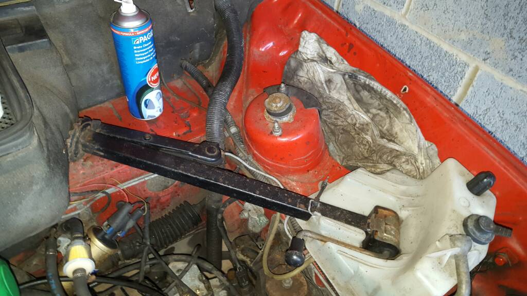

Managed another few hours today cleaning round the bay a bit.
I know it hardly looks super clean but it was really bad in there so the fact you can see bare metal anywhere at all I'm quite proud of. Sure Didge can confirm I have defo made big difference so far lol.

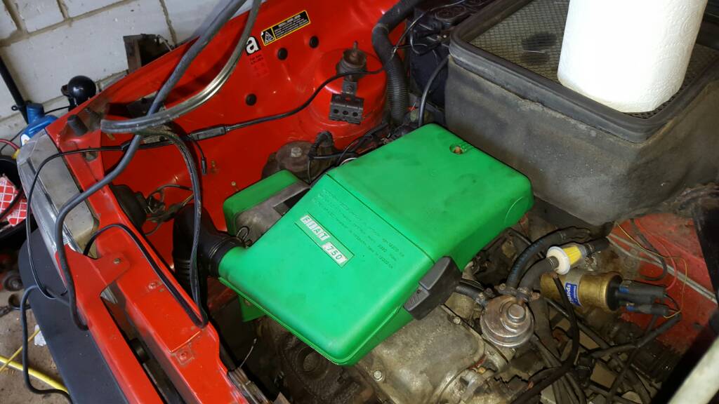

Spent quite a while trying to clean the airbox up. Happy with the results and also found the little mechanism that opens the flap once warm was broken so it's been constantly sucking hot air from the manifold - just took the flap off for now. Stuck in new air filter while there and a fuel filter too. Will do oil and coolant change once bay is cleaned.
Drivers side of bay is mostly clean now but as you can see I still need to do passenger side.
Engine bay definitely looks cleaner (y) Just need to get that engine cleaned up now :rolleyes: I always wanted to get the cam cover all clean but never got round to it :eek:
The airbox flap got stuck before so I jammed it to the cold position, maybe that's what caused to to eventually break... :confused:

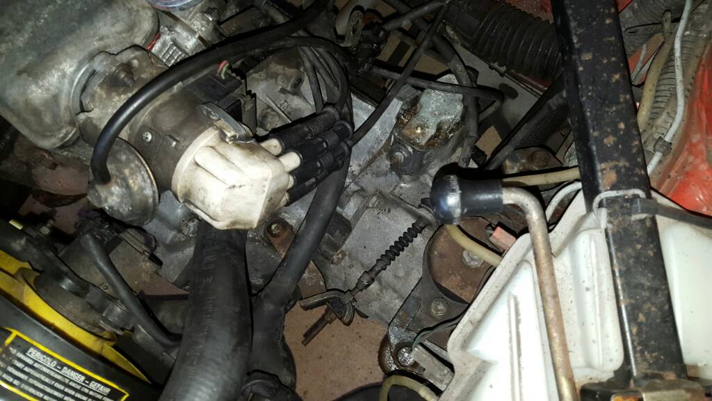

OK so had a little mess today and its defo not fuel that is causing the poor start that defo works fine it turns out. So if its not fuel it has to be spark thats weak - well i remember Dom saying he changed the coil in his thread, does seem that long ago and certainly the coil itself looks pretty much brand new. I have also put new plugs and leads on the car recently so not that... So today took the dizzy cap off and my mind went 'AHA!' when i looked in there, the contacts were mighty crusty (what there is left of them). Cleaned them up, stuck it on and it now starts pretty much on the button. Have ordered a replacement as although it is working now its clearly near end of its life.
I have also got one of them ignition modules i seen a few members have fitted, one of these. I got a little confused by the wiring - yup to me injection really makes more sense, not really sure why there is a wire coming from both +ve and -ve posts of the coil across to the distributor, and there is another (non standard wire) there i have no idea what is, well i think its for the aftermarket tacho but i not really investigated where said wire goes but thats my theory without doing any testing - clearly unplugging it and seeing if the tacho still works would tell me but not even done that, left it for another day - prob wait for the new cap to turn up before i mess more.

Yup as you said I replaced the coil somewhere within the last 2 years, the wire that comes from the +ve side of the coil and disappears behind the heater airbox is indeed for the tacho (y)
ok cool, so do you know what the little wire from the -ve side is (yellow iirc)? I was thinking one is prob power for the tacho (from +ve) and the other could be the signal wire for the tacho (from the -ve). Not sure that would even work, never was good at how carb/dizzy/coil things work
It's been forever since I've looked at it but if it goes in the same direction as the one on the +ve side then it's for the tach as well, don't think there's anything else that connects to the coil other than the distributor of course....
ok so, new dizzy cap fitted and having not run for few weeks it was miles easier to start than it previously was.. I let it run a while and then decided to get this electronic ignition module fitted finally - all fitted and Char seems to be running really nice now, will have to wait and see if its improved cold start even more but it certainly is silky smooth running with all the new ignition parts compared to before. (y) The rotor arm does have a little pitting on and i'm slightly annoyed with myself for not just ordering one so i could replace at same time as cap but hey-ho, its no big deal to do that later on.
