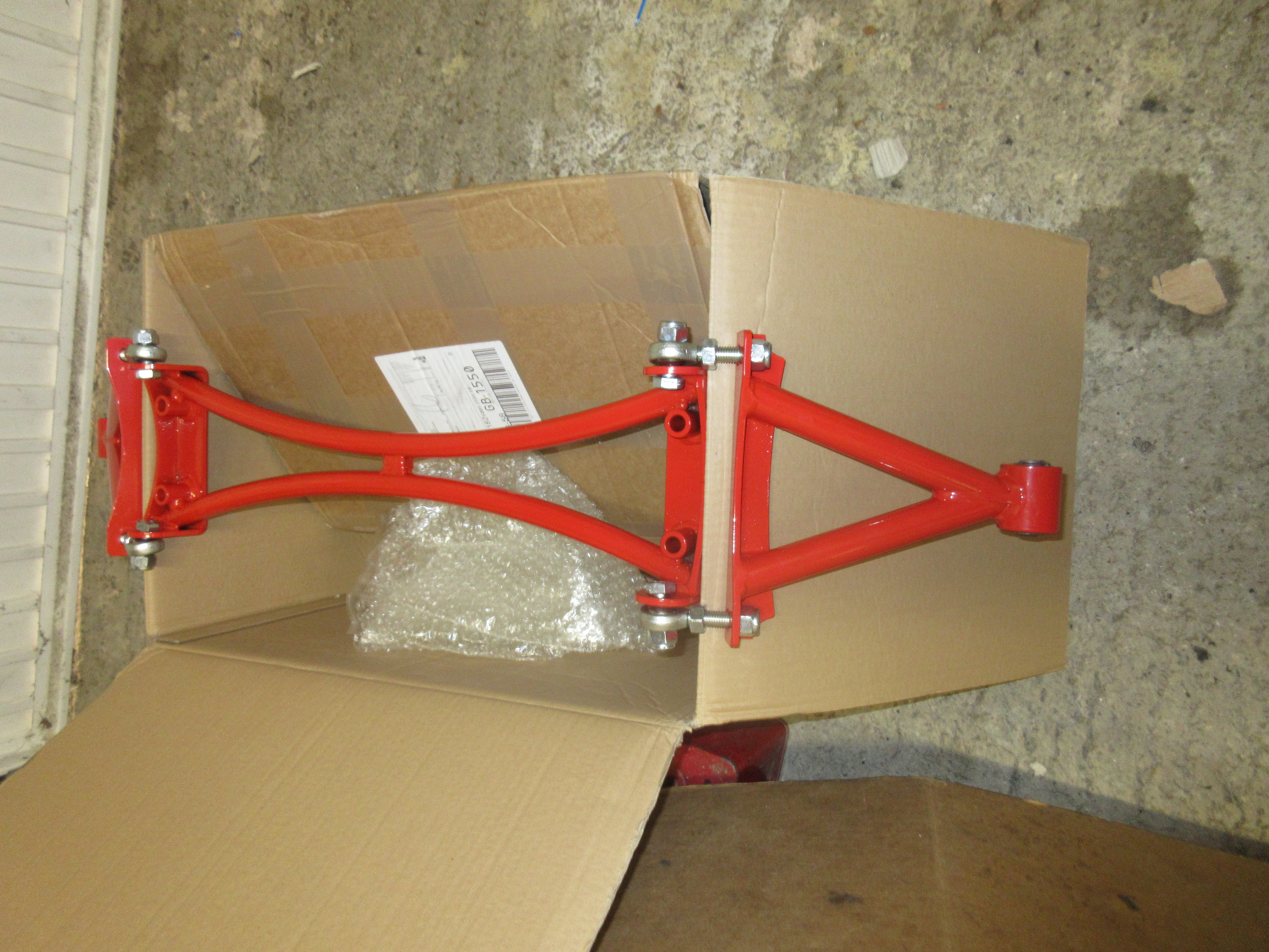

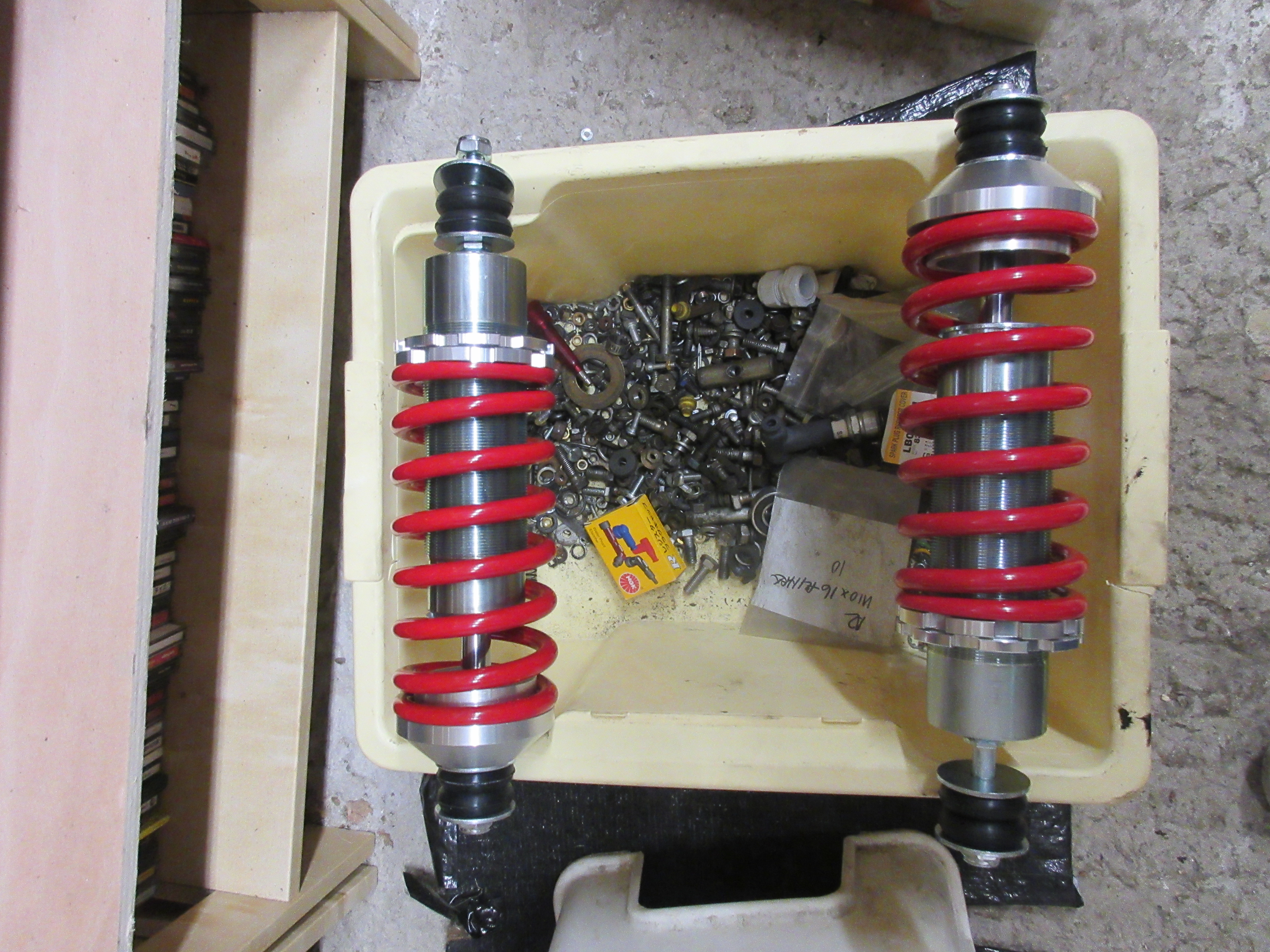

Independent suspension has been delivered!
Just need to make two reinforcing plates to sit over the top of the shock absorber to act as a stronger top mount
Shiny bits!!
Just need to remove the spring hanger bracket thats fused to the stud - and make two reinforcing plates to stop the shock absorber appearing theough the inner arch.

Hi Andrew; congratulations on your progress--the 'wee beastie' is alive and kicking at last!
With regard to removing seized ally spring mounts, the only way really is to VERY CAREFULLY grind the front and back of the mount, ALMOST to the stud and then split what is left at the front and rear with a chisel so as to open up the hole that the stud runs in. The mount can then, with a bit of leverage (an OLD, big chisel can be used to start the mount moving, with the chisel being used between the body and the mount) slowly ease the mount down. It is tedious and you must be careful not to damage the threads on the studs, because they are a real bugger to replace.
