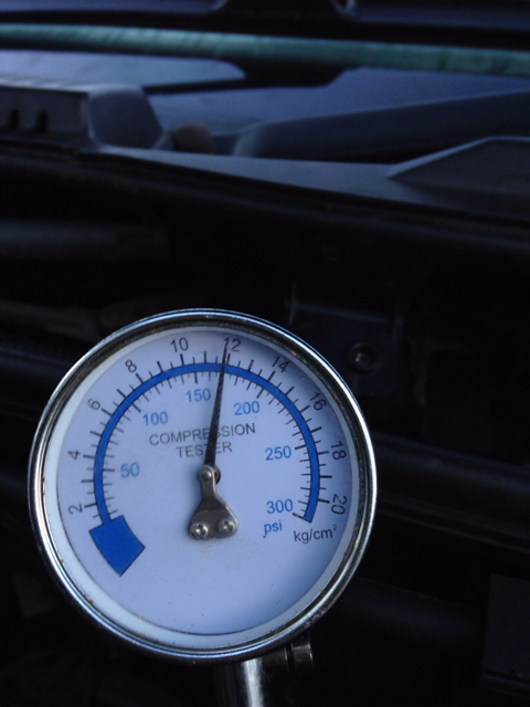

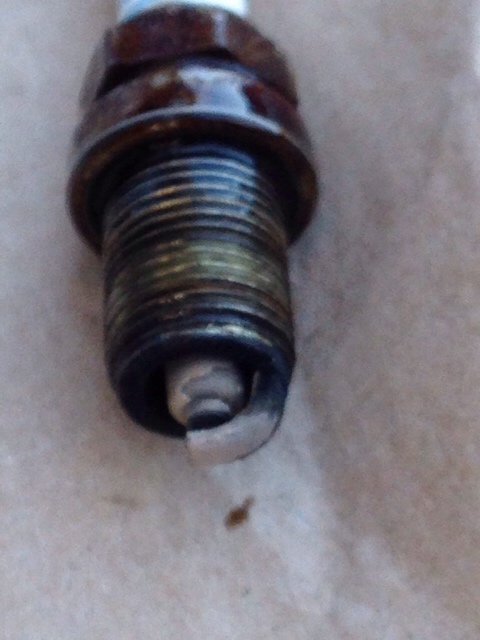

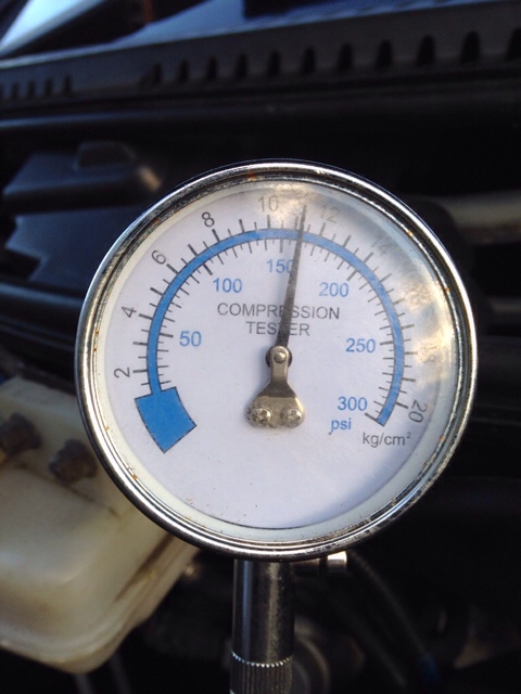

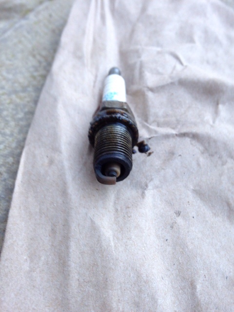

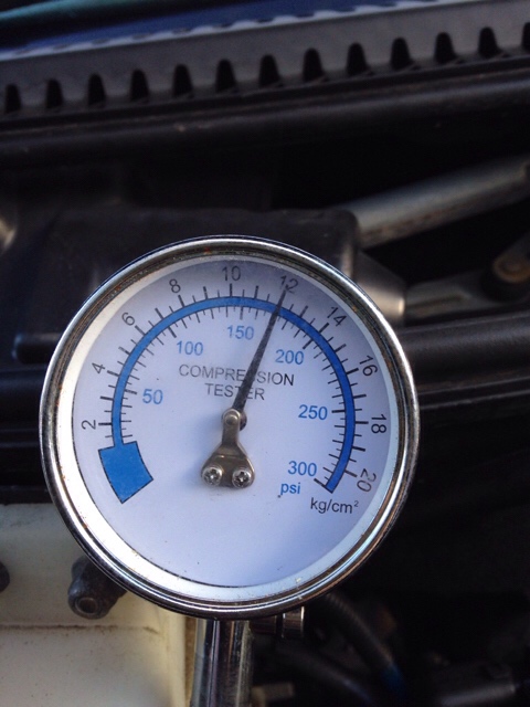

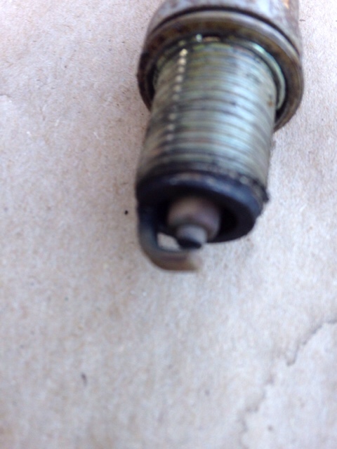

Ok done a cold compression test today. Changed the spark plugs at the same time as had new ones sitting waiting. No difference to idle or revs sticking.
ImageUploadedByFIAT Forum1455299779.452453.jpgImageUploadedByFIAT Forum1455299799.669087.jpgImageUploadedByFIAT Forum1455299815.738564.jpgImageUploadedByFIAT Forum1455299845.492013.jpgImageUploadedByFIAT Forum1455299878.902466.jpgImageUploadedByFIAT Forum1455299907.754521.jpgImageUploadedByFIAT Forum1455299936.691785.jpg
First pic is spark plug condition and then corresponding compression test. Results from 1-4.
All low so I'm thinking head gasket. Started easier with new plugs and no oil on plugs etc. So Questions.
Can I get away without skimming the head the fact that all the compressions are lower? Am I better changing timing belt and water pump at the same time?
