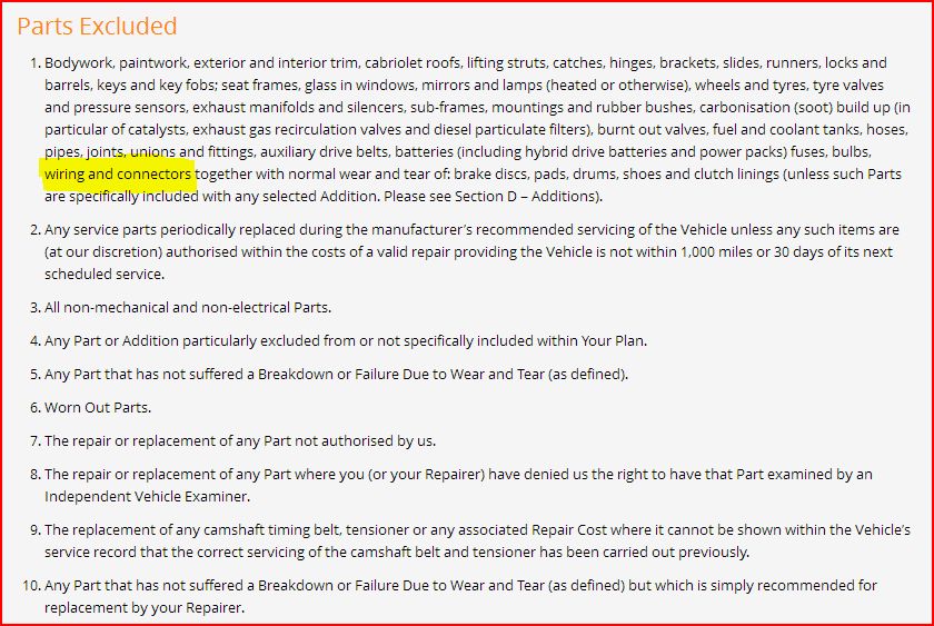

You'd need to read the small print of the warranty; I've attached a clip taken from one supposedly comprehensive typical third party warranty which clearly excludes all wiring. As an aside, that warranty would exclude at least 90% of what folks commonly post about here when having problems with their 500. The consensus of opinion with regard to such warranties is that they are easy to buy, but difficult to successfully claim against.

I rang my warranty place and they don't over anything like that, or wiring loom problems
