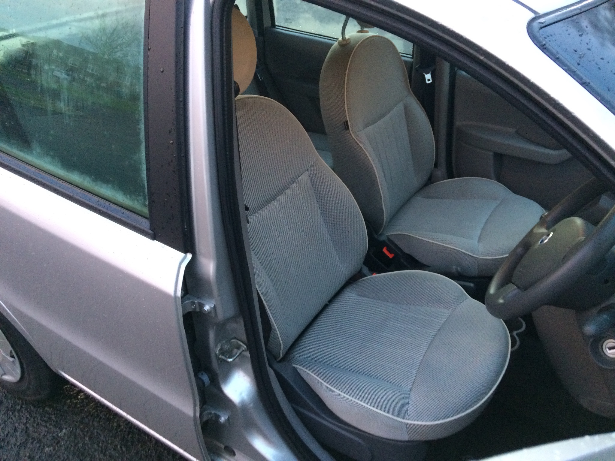

Anyone know if the 500 seats fit panda, (5 door)
ive heard the fronts do..but do the rears bolt straight in?
been looking for a set of panda ones but theres none around,
but theres loads of 500 ones.
thanks inadvance....

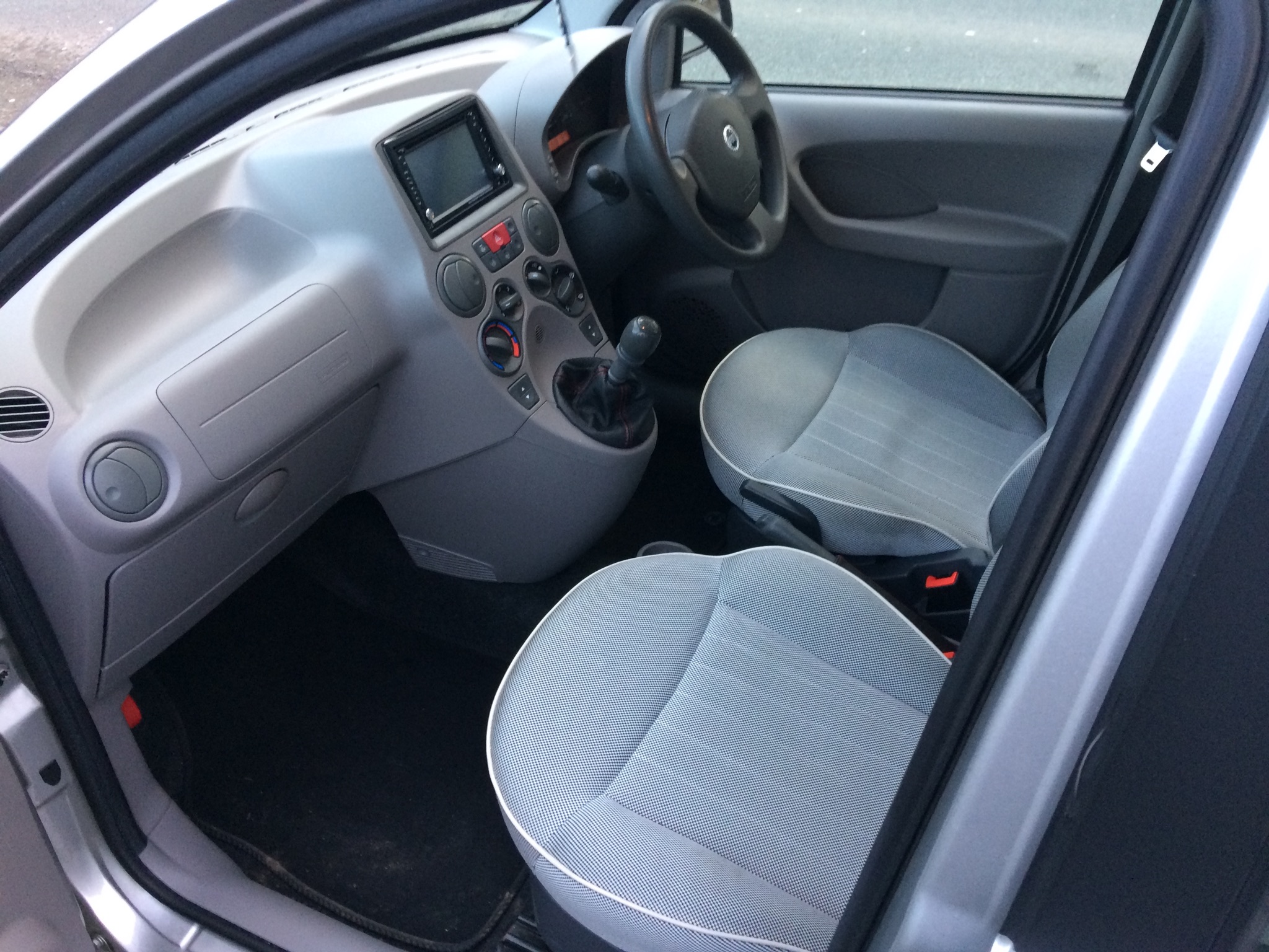

Hi, yes all seats should bolt straight in after swapping over the brackets from your panda seats, and as for the rear they should bolt straight In as long as you have split folding seats. But if you don't like me then you have to source a bracket to support the centre of the seats. I managed to get hold of some fiat 500 cordura seats cheap to replace my ugly active seats. Hope this helps?
