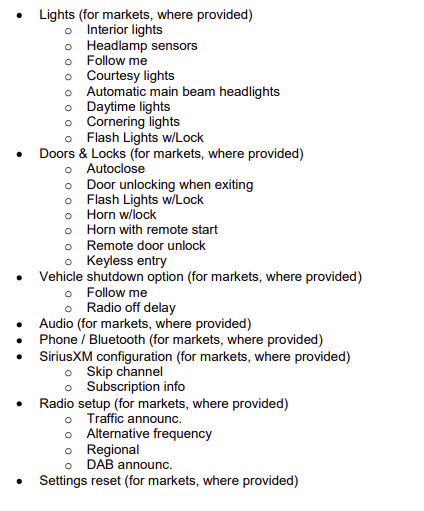

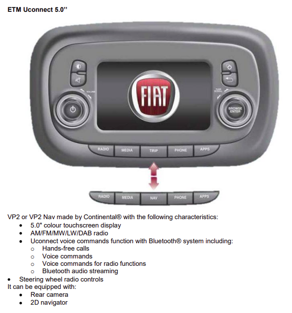

Below are the difference between the 3" and 5" systems.
With the 5" system then many of the vehicle settings are on the uConnect Unit. I assume that some/all of these are on the vehicle dashboard settings menu when a 3" uConnect system is fitted.
Putting the 5" in place of the 3" will at least require the Body Computer Module (BCM) to have a Proxy Alignment done (flashing mileage indicator). I've no experience of doing a 3" to 5" uConnect swop and neither do I recally seeing elsewhere anybody who has done this. Most seem to upgrade to an alternative aftermarket unit with the correct addition control module.
