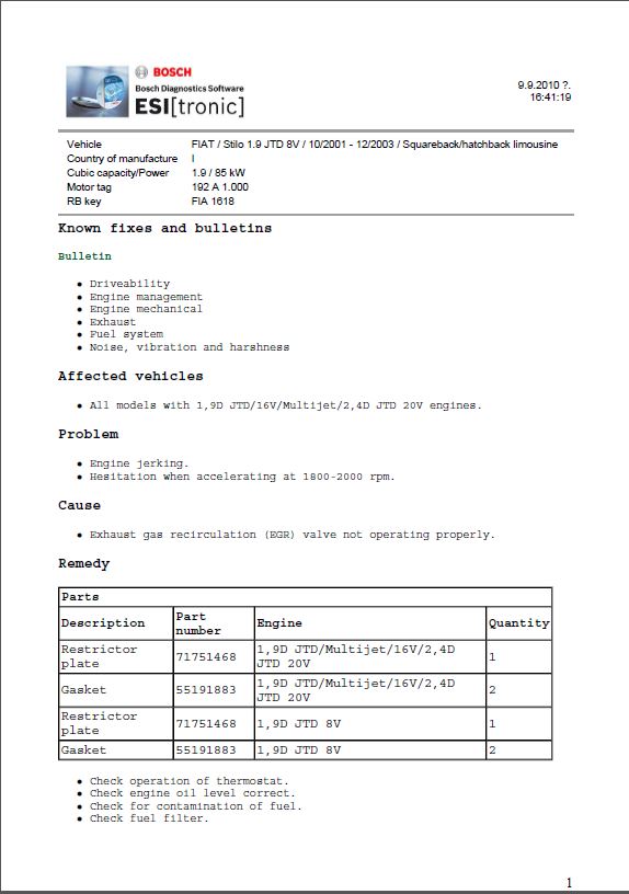

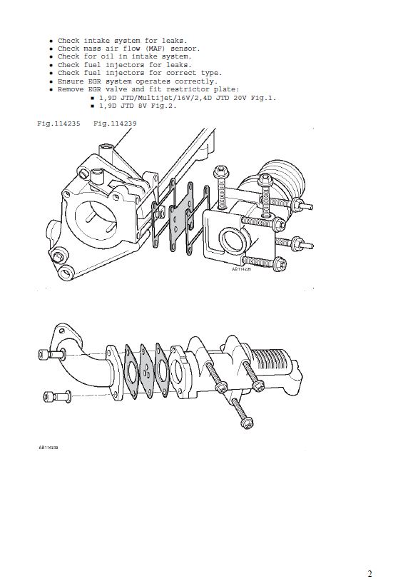

I'm fairly sure Fiat released a technical bulletin about fitting a restrictor on the EGR valve, although this could have been for the 16v motors not the 8v more commonly found in the Stilo. Either way you could get away with fitting a restrictor (possibly even blanking completely) which would help eliminate EGR issues.
I know later models if you blank it completely should give an engine warning light and an air quality / pollution fault but there is every possibility the earlier (lower euro class) engines didn't have this fault code.
It's available for both.
