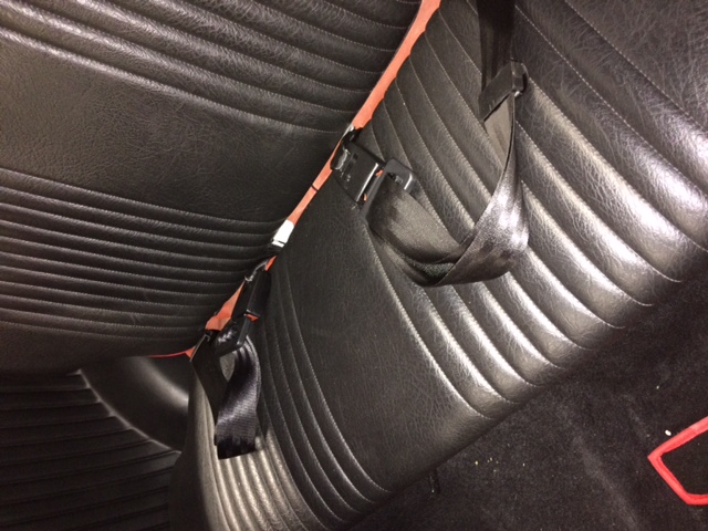

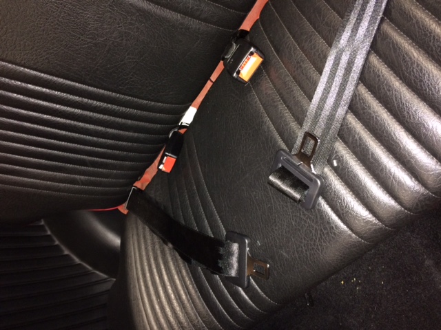

Hi Gordini8
Here are the rear lap type seat belts I fitted. These are from Van Der Laan and come with all the fixings and lock plates required. The work just fine.
Cheers
Hugh Jarce (y)

Looking nice although I need something more than lap type belts. Can we have some detailed pictures please? How they are attached under the seat and the shelf?
Thomas
One bolt through rear "parcel" shelf - bolts slid through the 2" hole behind seat back
One bolt through fire wall at lowest extremity for the "pivot" and one more centralised bolt for buckle
so except the top parcel shelf the others are attached to the firewall and nuts through the engine bay? No screw bolted at the flor right?
