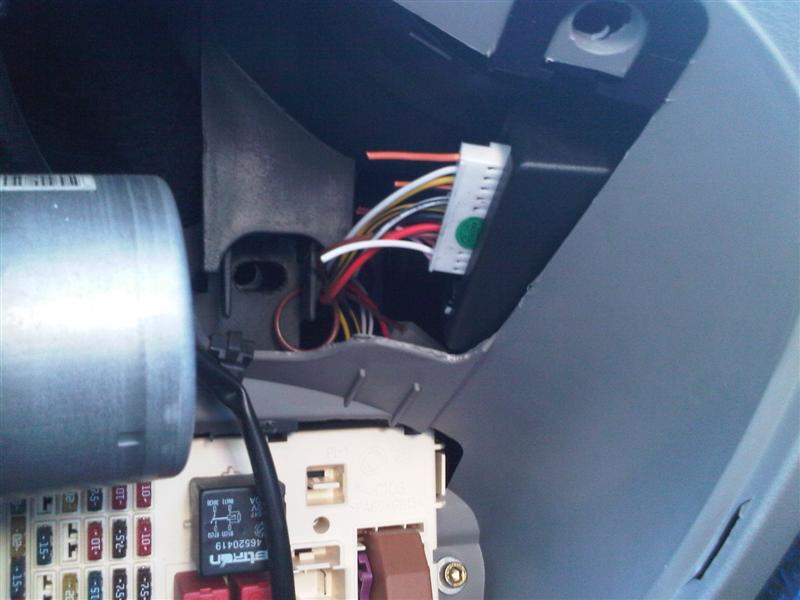

Okay last things last, grab your velcro with adhesive backing, stick some on the hawk black thing, and the other side just past the lip of the nook bit. See picture:
now grab your cable ties and tidy all the excessive wires from the hawk kit.
As for the rest... it's just a reverse of the preparation instructions! Oh! One thing first thou! Check it works!!!!
Reconnect your battery and check your fob operates correctly! Then disconnect it again!!!
Then put the lower steering wheel shroud back on and put the fusebox cover back
Jobs a goodun!
