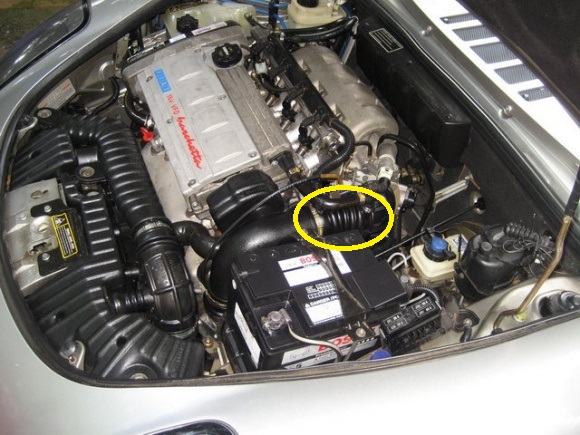

Remove and check your intake rubber one more time for leaks. The one between the MAF and idle valve. If you have a plastic intake manifold, check for cracks.
You might want to take it to a tester - if the engine light is on, there will be an error code indicating the faulty component, if the problem is component based. If not, then it's most likely an intake leak.

If the car idles ok, but stalls when you try to rev it, I would suspect an air leak in the intake rubber hose. When the engine accelerates, it moves a bit and bends the intake hose, causing any cracks to open up and suck air. whereas if the crack is small, it won't cause a leak during idle or steady revs.

EDIT: A new rubber hose may be difficult to find, but if you wash it first it can be easily fixed with Sikaflex or similar rubber glue.

hmm I have checked for cracks without taking the whole hose off because of the dreaded fastening clips which are impossible to put back without proper tool and there really doesnt seems to be any..
Think its good idea just to get electric tape and tape all around the hose to see if it changes anything and detect the leak in that way if there is any?
If you want to test it without taking the hose off, you could put some piece of a plastic bag around the hose and then use duct tape to seal it.
This way you can easily remove it later.
The cracks may be underneath the pipe in the bottom corner of the bellow, so it can be difficult to see without removing. The original clamp is useless, buy a pair of hose clamps http://img.directindustry.com/images_di/photo-g/worm-hose-clamp-65240-2514041.jpg before disassembly, they cost a few € but make things a lot easier.

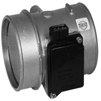

The fuel pump can be a answer for Itaa, but i would really go for the intake problem.
It the lambda sensor was faulty, the car would run in degraded mode, and will drive ok with no stall or idle problem, but with a very high fuel consumption.
It can be a leak, but i really think it's something with the flowmeter.
I had a similar problem, and i disassembled the intake system, clean the flowmeter sensor with brake cleaner, it was better, and then check for connection of the sensor itself, cables and outlet. i had little bit of oxydation and a loose connection of the flowmeter 3 pin outlet, wich was the real problem.
