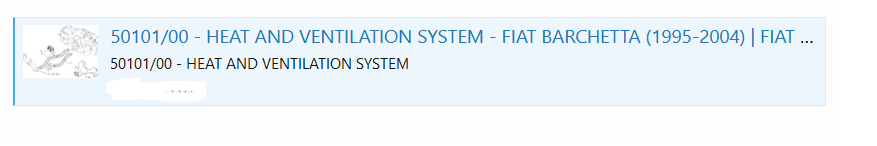

To, partly, answer my own question. Looks like we need to support og meta tags
Using info gleaned from here Medium info
I stubbed up some html with og meta tags and that now shows a reasonable preview in the unfurl dialog
<!DOCTYPE html>
<html lang="en" class="h-100">
<head>
<meta charset="utf-8" />
<meta name="viewport" content="width=device-width, initial-scale=1.0" />
<meta property="og:url" content="https://eper.fiatforum.com/en/Drawings/Detail/F/F/BAR/PK/501/ALL/ALL/0/Group" />
<meta property="og:title" content="50101/00 - HEAT AND VENTILATION SYSTEM - FIAT BARCHETTA (1995-2004) | FIAT ePER - Online spare parts catalogue" />
<meta property="og:description" content="50101/00 - HEAT AND VENTILATION SYSTEM" />
<meta property="og:site_name" content="ePer" />
<meta property="og:image" content="https://data-84-eper.fiatforum.com/54/54AEF1D27F862A88E20785678935CC28.png" />
<title>FIAT BARCHETTA (1995-2004) | FIAT ePER - Online spare parts catalogue</title>
</head>
<body>
Hello from the web
</body>
</html>
We get a preview that looks like this (URL redacted as it's some private server I don't want to share!):
With a bit of fine tuning that could work?
