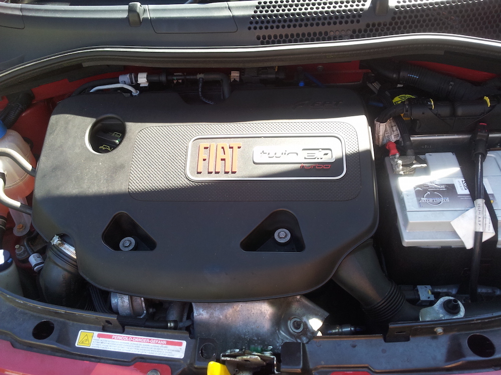

What is the huge TA air filter box actually for?
It takes up quite a bit of space under the bonnet. Does it fulfill a particular requirement?
Why isn't there a simple filter unit connected straight onto the turbo inlet?

And it's partly there for esthetic reasons. Personally I prefer to see the engine, but most people seem to prefer black plastic...
Mick, you are lucky to have the old version with red and silver accents; the current version is completely black.

I would say both:
The whole engine, including the whole intake tract and the exhaust is an precisely tuned system.
In the intake system we have a specified air resistance defined by filter surface and material. Additionally it is a balanced resonant system.
If you replace it, you change the whole system.
The filter housing is part of the engine sound insulation as already mentioned, including the under-bonnet cover.
It is also a mechanical protection for the ignition system and looks nice.
Lars
I wonder why?
Surely the KN filter just fits in the same box and passes the induction air just as easily as the Fiat one?
The benefit of the KN filter is that it's re-useable.
Not that it makes much of a difference. The original one in ours is 18,500miles "old" and is clean. When I looked at it, I fitted it the other way round because there was a dark-ish patch where the inlet was. I reckon it'll be fine for another 10,000miles.
https://www.shop4parts.co.uk/?name=...Turbo%5FTwinAir%5FAir%5FFilter&cat=Air_Filter
At £17 for an air filter that lasts (say) 30,000miles as opposed to a KN filter that will last the life of the car for £50 .........................it's a close call. :)

The constructions and the materials are different. The FIAT filter is a combination of two different filter layers. One layer is a traditional (paper?) filter; the other layer is a foam filter. The K&N filter is a cotton filter though.
