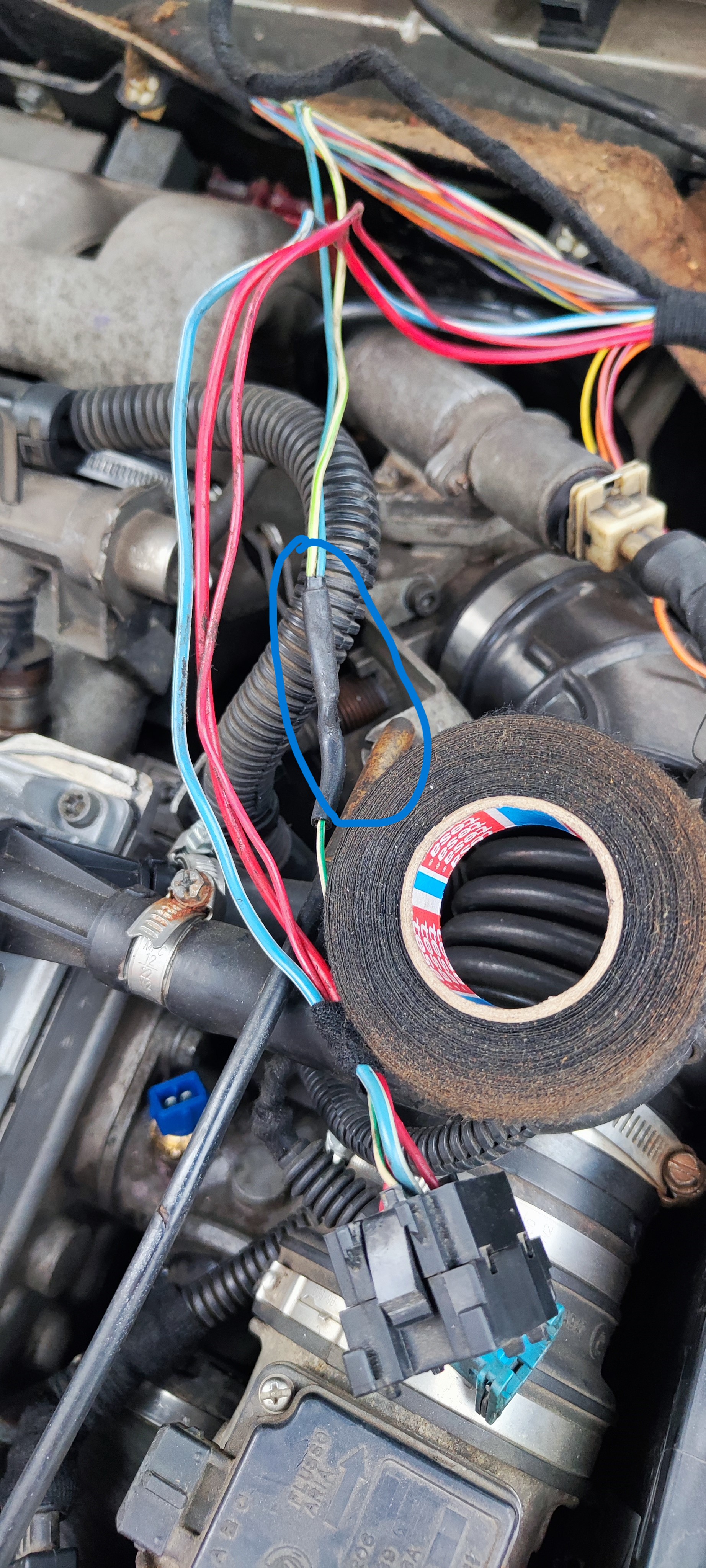

Hello, I have an issue with the Barchetta, the model is from 1997, it doesn't have AC it's with just with one fan on the radiator. The issue appears when the thermostat sends the signal to the fan to turn on. The moment when the fan turns the rev start to go wild it doesn't stay in a stable point, like between 800-1000 rpm, and I need to rev it to keep the engine going, if not the engine will stall and this happens while driving to so its not good. So I checked the relay, the thermostat is new, and the temp sensor was changed recently, I checked the relay and the cables for it and I found this which was weird for me so could someone confirm if this is correct, like one of the wires from the relay goes to a point and then it splits into two wires. Is that oem or it was modified, and did someone else have this issue with the revs like the fan consumes to much electricity and the alternator can't keep up?Thank you.
