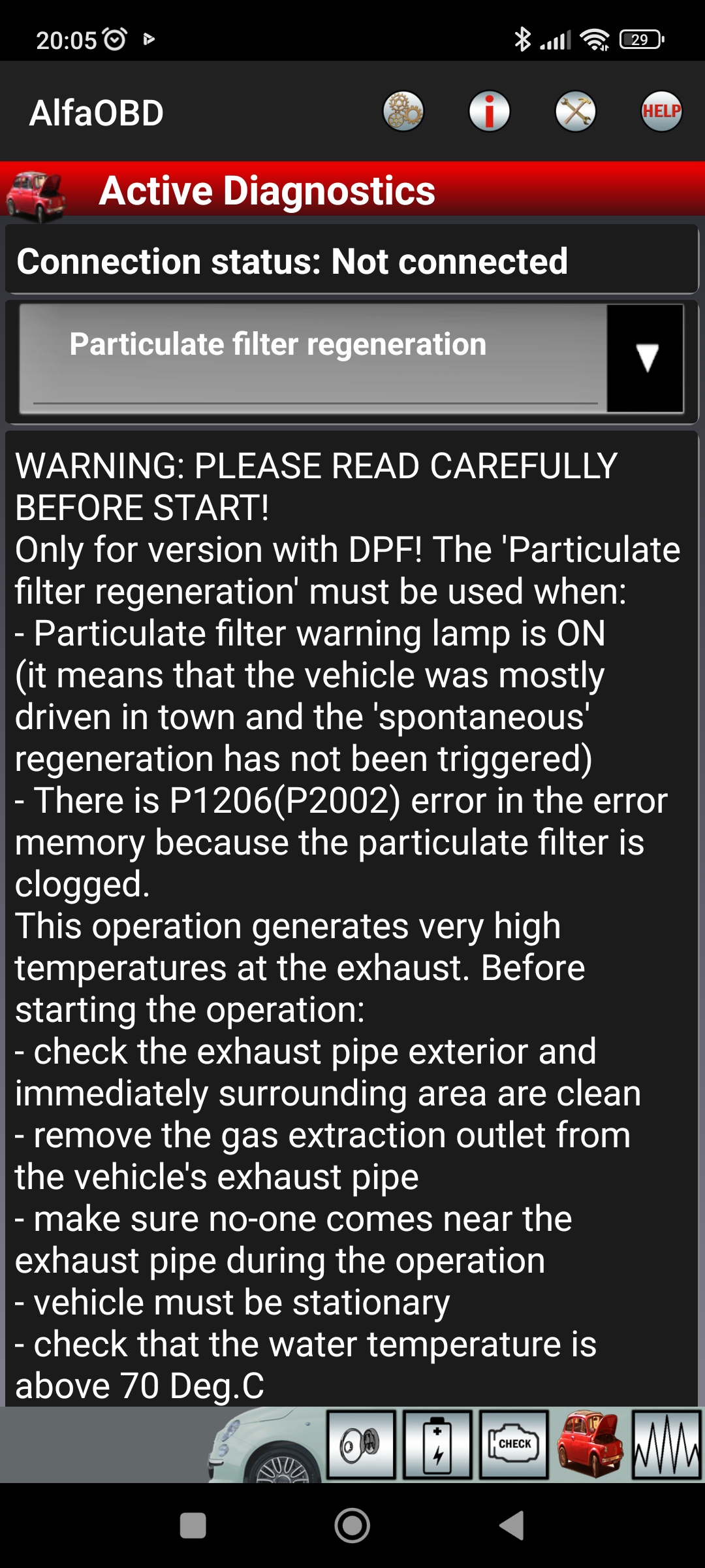

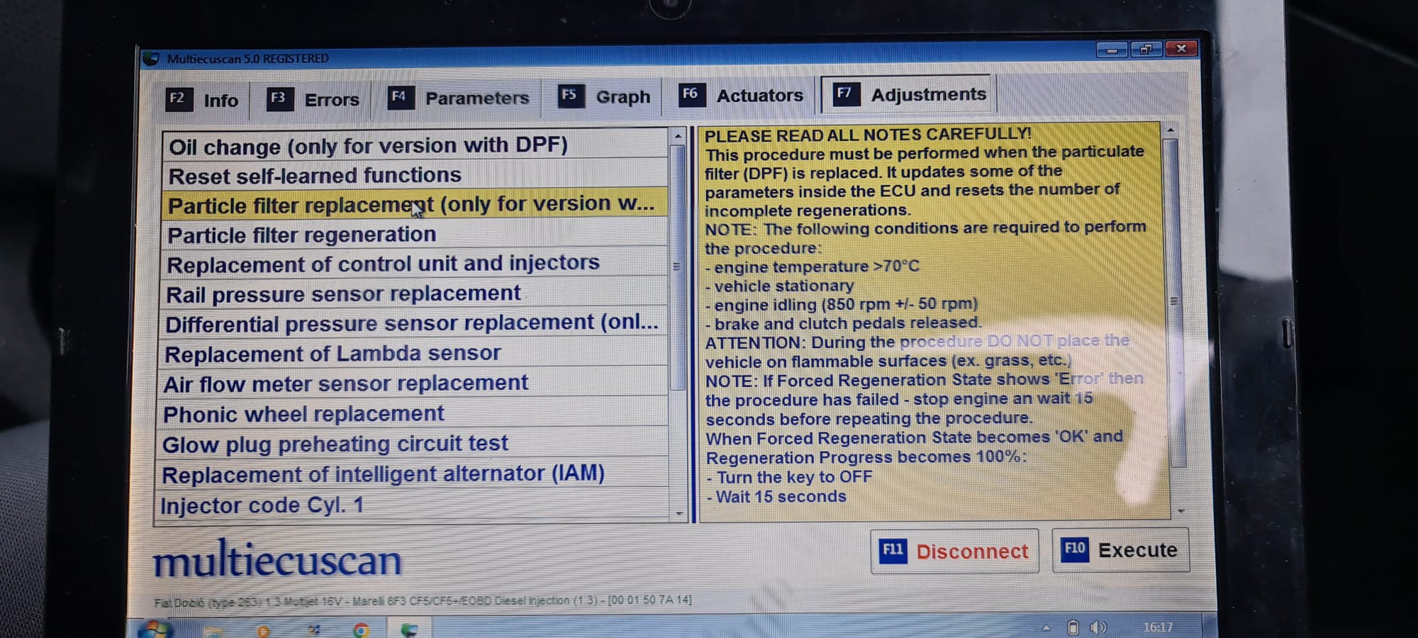

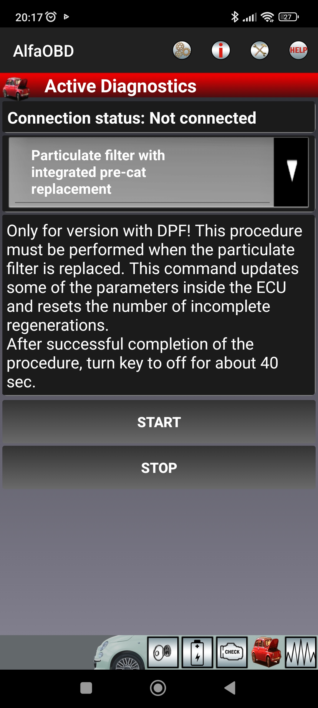

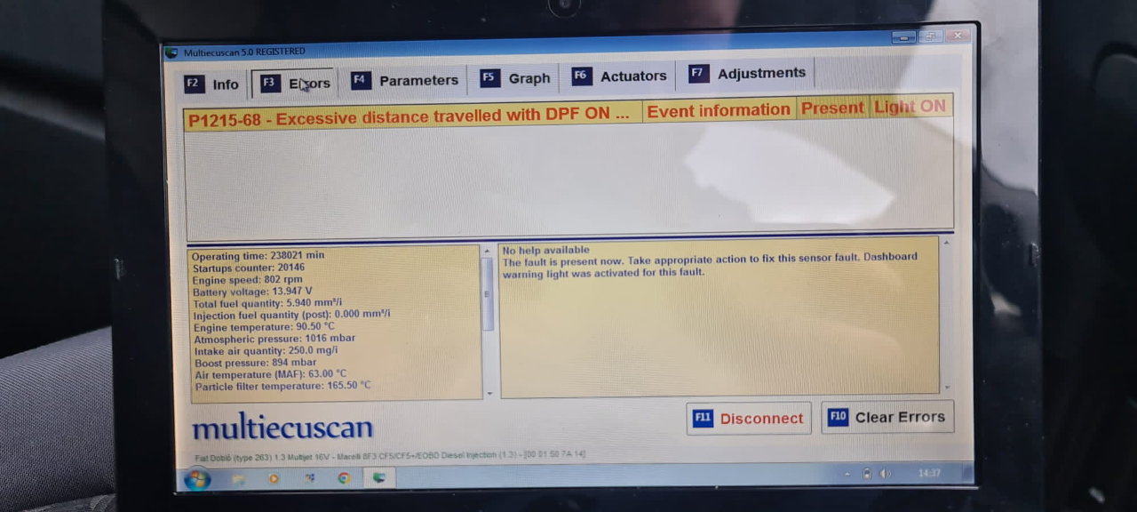

Hi,
My friend has a Fiat Doblo and had the error code "P1215-68 - Excessive distance travelled with DPF On..." on the Multiecuscan. He has therefore replaced the DPF with a new one, but the error won't clear.
Does anyone know how he can clear this? - see attached image
Many thanks
