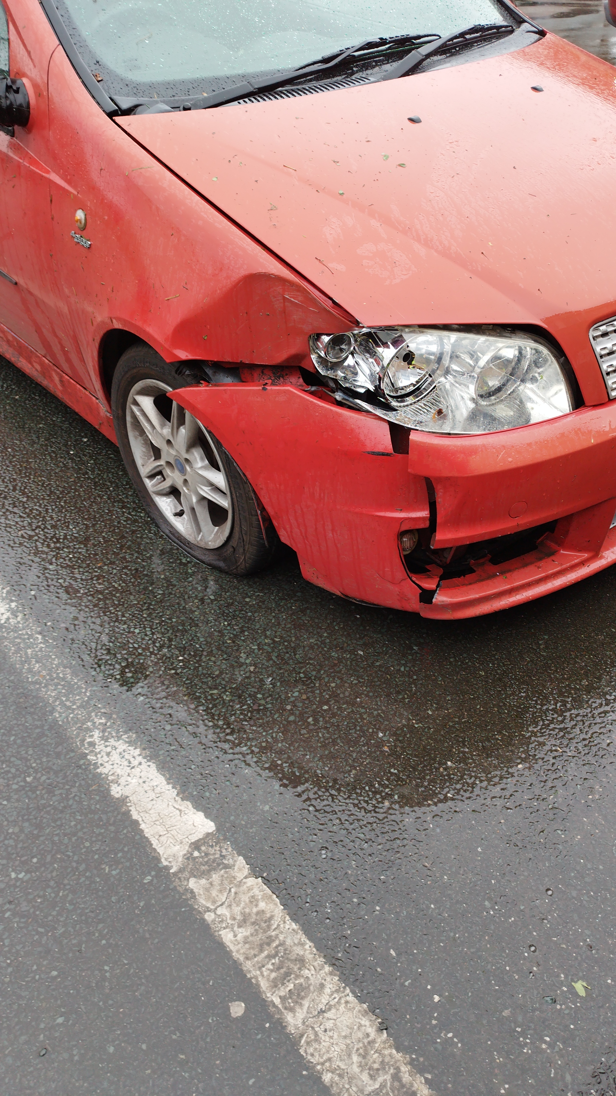

Will a standard active wing fit on my active sport?
And would a 5 door wing fit/are they the same??

I was only doing about 25mph coming up to a bend when the tyre blew out. Aqua planed over the road into a hedge with a steel post in it.
You're right it is a cheap runabout but absolutely fine otherwise and just passed its MOT so due to current financial issues I'd rather just get a wing and headlight and fix the bumper.
I can do the bodywork well enough myself to make it safe to drive again.
I just want to make sure any mk2b facelift wing will fit this 3 door active sport including one from the same model 5 door.
Just to give me a fighting chance of finding one that fits (hopefully not requiring respray to red) !!

It looks like there is almost certainty damage to the inner wing which may put your metal being skills to the test, the bonnet may also now be twisted. You can easily get it all “good enough” but it’s not going to be perfect by a long shot

Good enough will have to do unfortunately. It's a lovely little runabout and it is very "pretty" but at the end of the day it's only valued at £299.
To me it's a perfectly fine vehicle that does what it's supposed to do so I'd rather spend £80 on a used headlamp and wing and use my trusty (and cheap) plastic staple welder on the bumper followed by some filler and colour matched paint.
Where else would I find a lovely little motor like this for £299 plus £80 for the fix?
That's my argument anyway. (If I'm being honest I would rather have the previous MK2 16v Sporting or HGT but there aren't any about!)

When I said to make sure nothing it bent I was referring to the suspension you need to make sure the lower arm strut and steering arms are all ok, it looks like the impact was big enough to have caused some damage there
Thanks mate. I've just put the alloy wheel back on and it does look a bit close to the rear of the wheel arch!
It's a bit hard to tell with all the original damage still there so I'll have to see how things look when I work out how to get it all off.
Some bedtime reading of the Haynes manual for me until the headlamp and wing arrive!

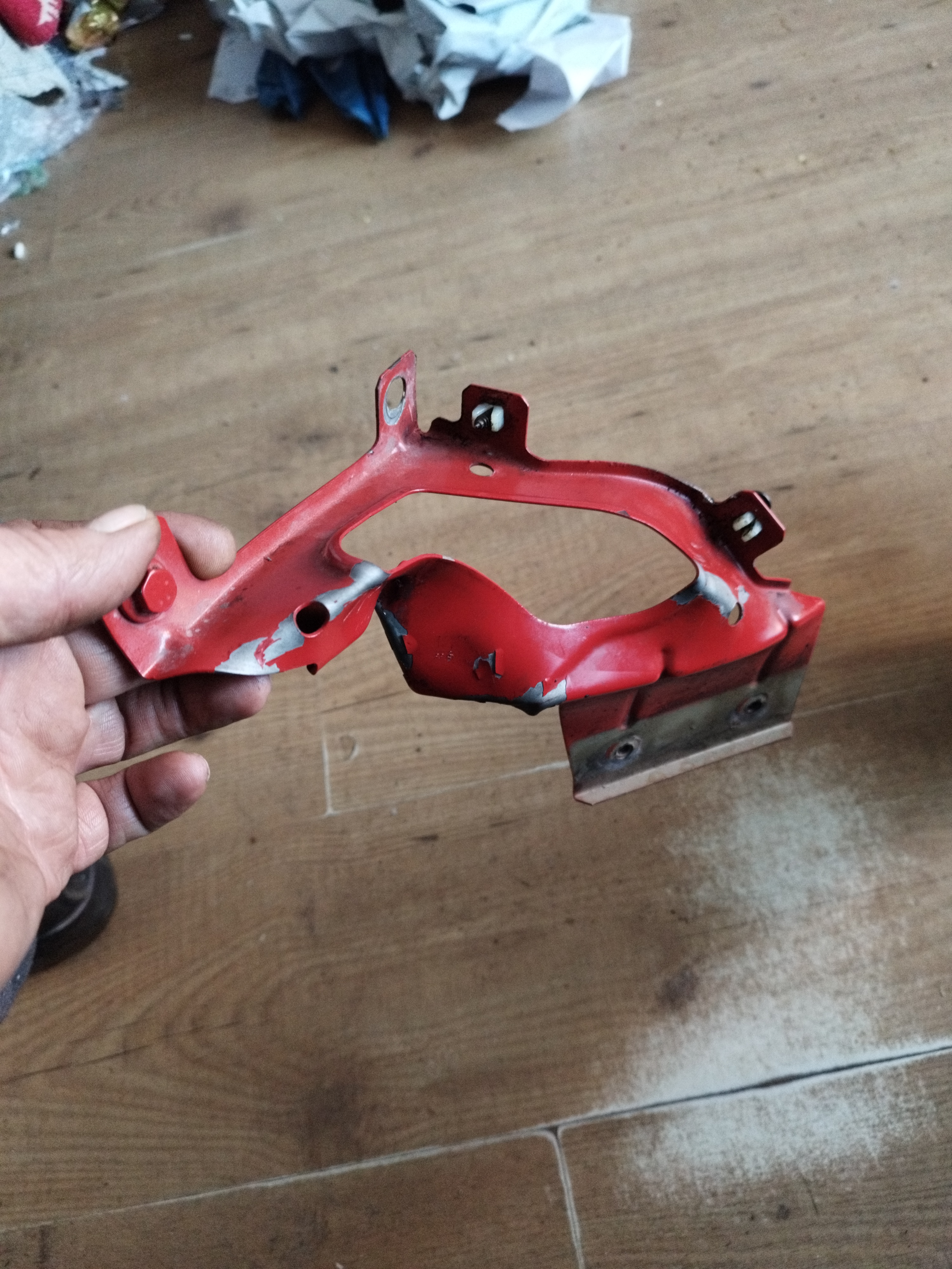

I'm looking for this bracket that connects the wing to the bumper and wheel arch liner.
It has 4803DX and A898 stamped on it
