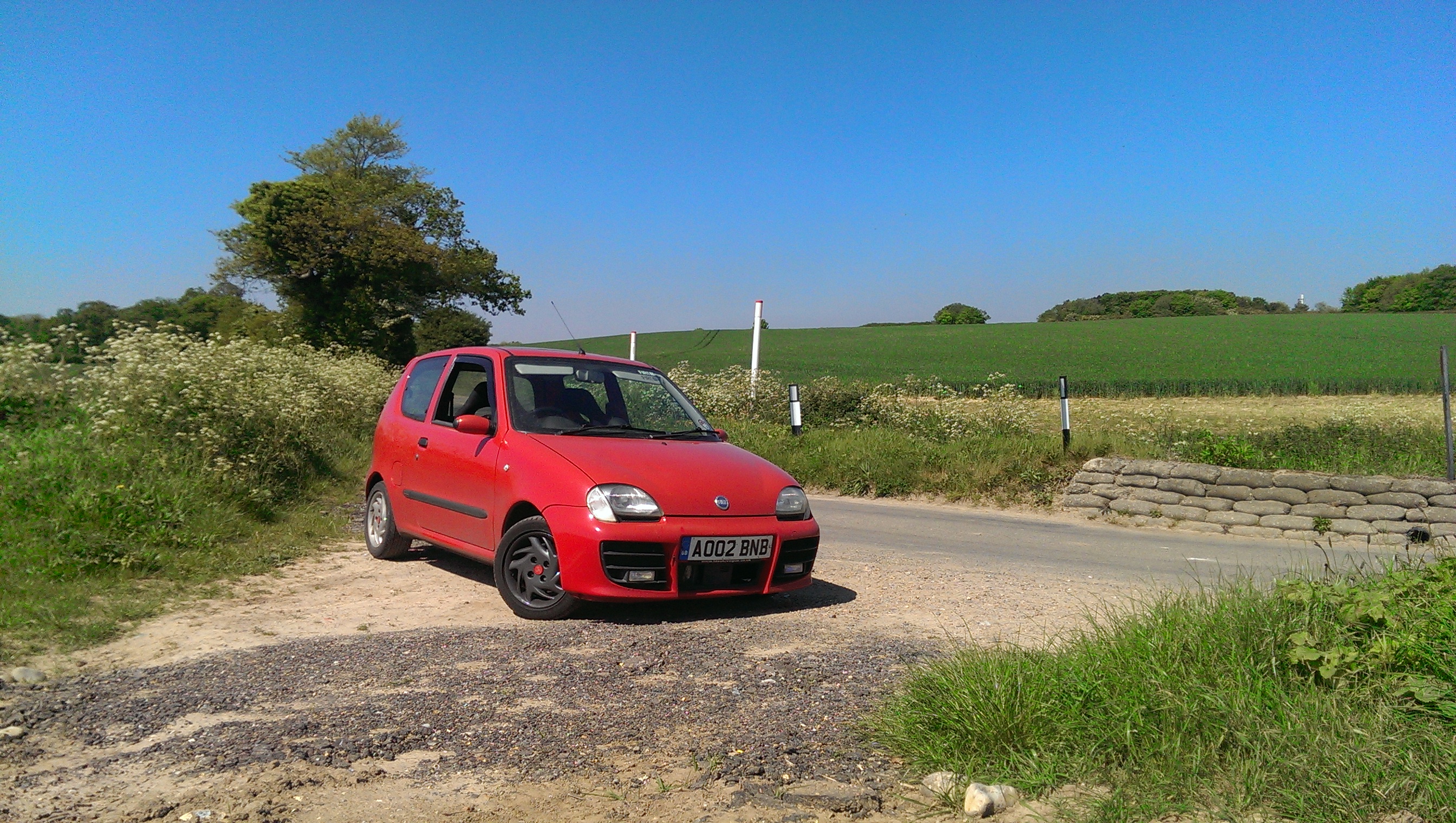

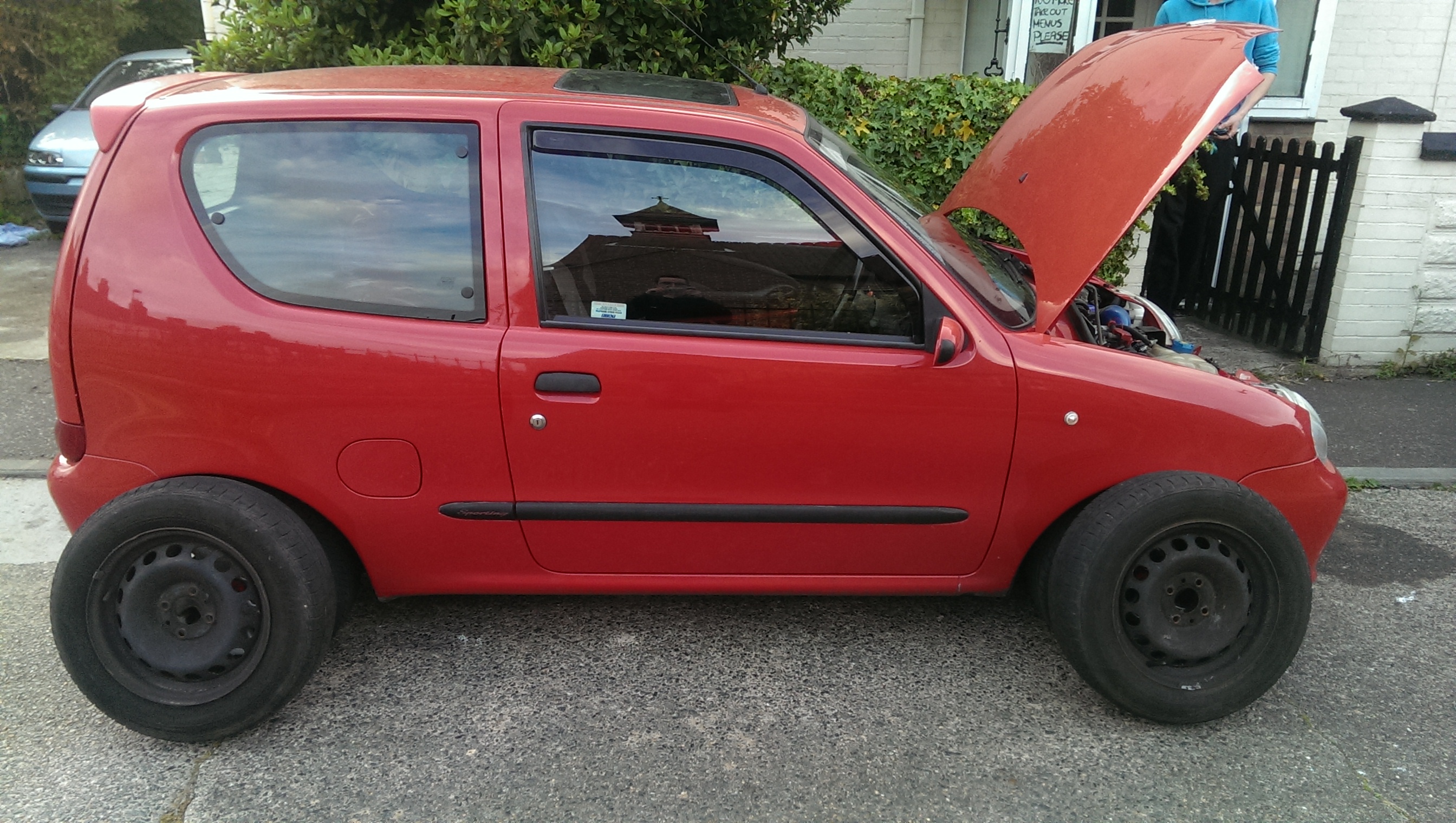

Well this is my pretty much standard Red(ish) Seicento...
I've had it since September last year, was at 71,000 miles and we're now up to 78,000 and now going stronger than ever :)
I haven't done much yet, mainly due to my insurance being so high since I'm 18.
Had an oil change & an ITG Foam Filter. Also got a new clutch and rear wheel bearings along with a new handbrake cable.
And of course I had to fit Abarth centre caps and black/red floor mats ;)
I've got some drilled discs and new OMP Sport pads to go on sometime soon.
(Sorry about the picture quality, I used my phone)

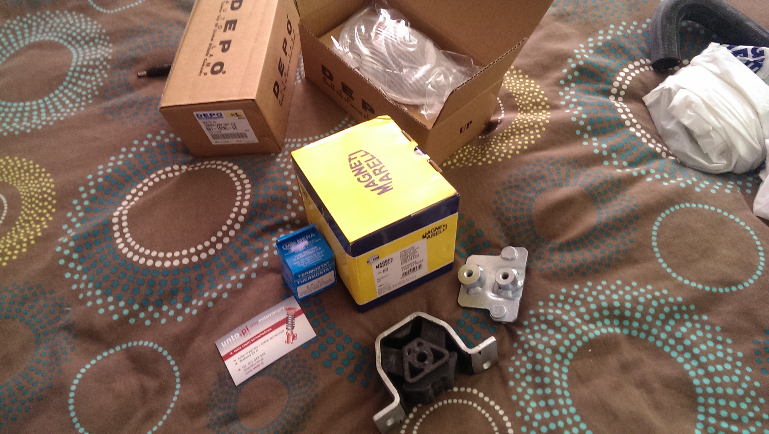

The Unto.pl parts I ordered turned up today too!

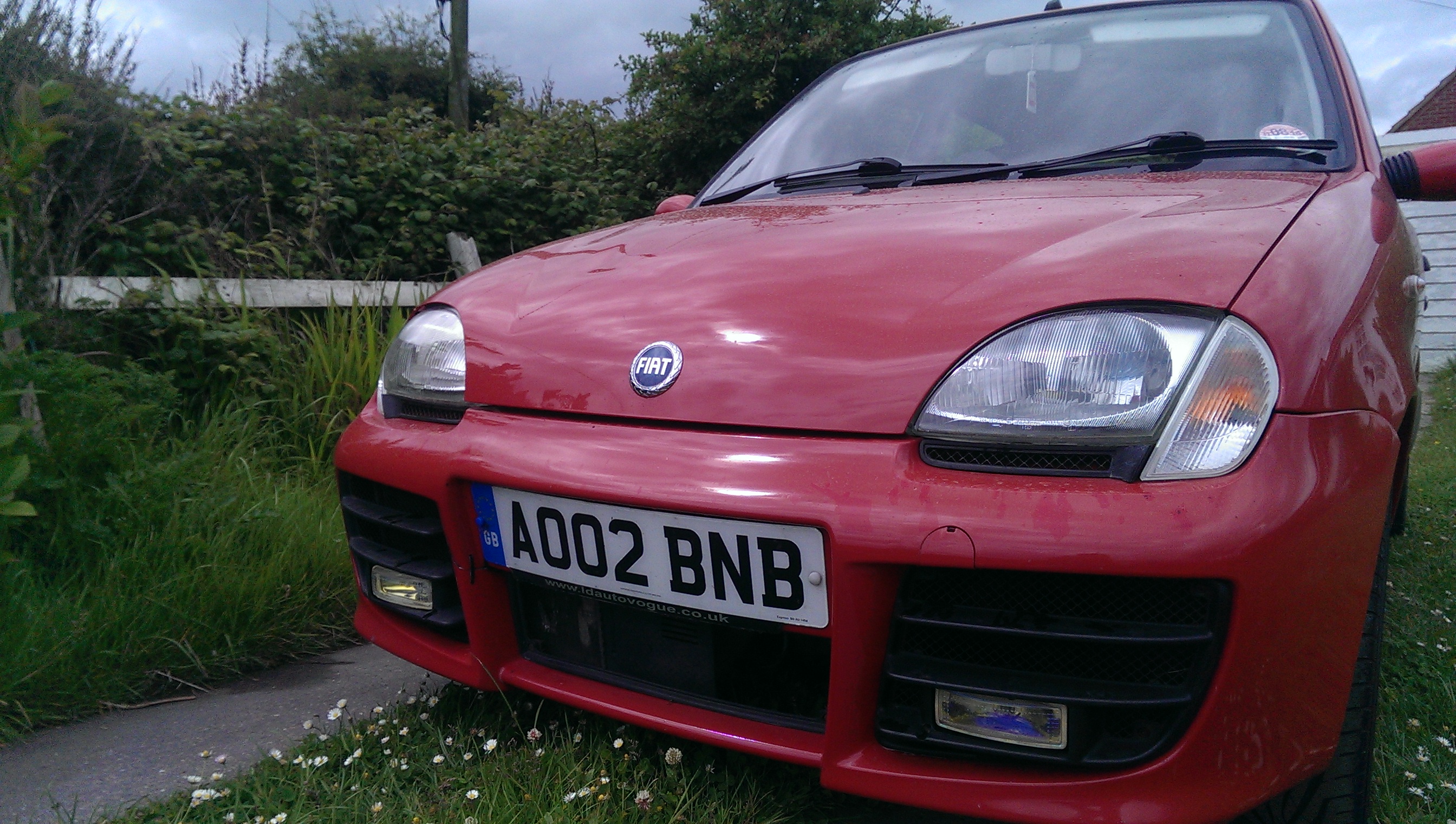

Engine Mount, ARB Bracket, water pump, thermostat and some new indicators :)
The new indicators look alot better than the cracked, mouldly and pondlife filled old ones. Ignore my front bumper :eek:

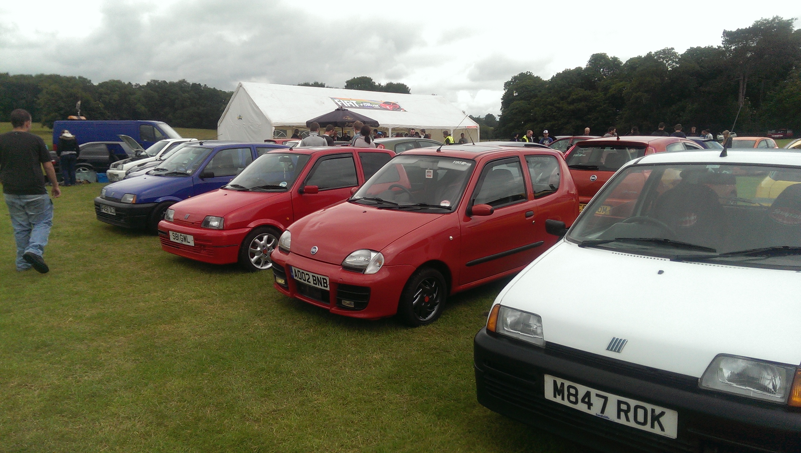

We went to Stanford Hall yesterday, it was bloody brilliant!! :D Met a bunch of new people and got some bits. I've now got a set of barchetta/PGT calipers which will be in for a clean up, paint and probably some new seals too. Also thanks to @Razman for the gearbox side poly insert (y) Just need to get a cambelt side one to match. I got roughly 48mpg on the way down but considerably less on the way back. The car did well and survived being totally thrashed :)

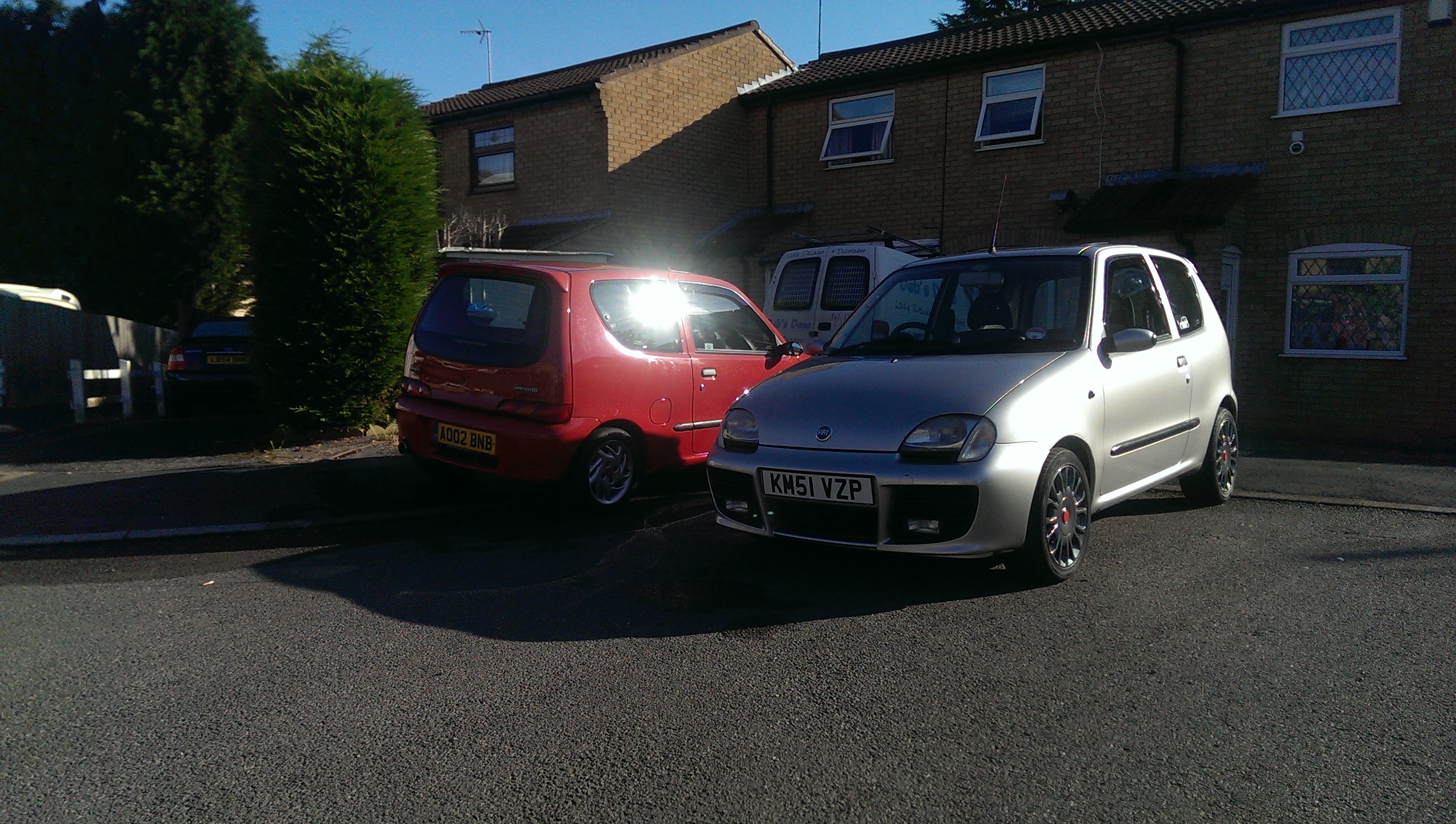

Of course I had to pay a visit to @seicentoceeney and have a little hoon before Fiona the sei goes :(

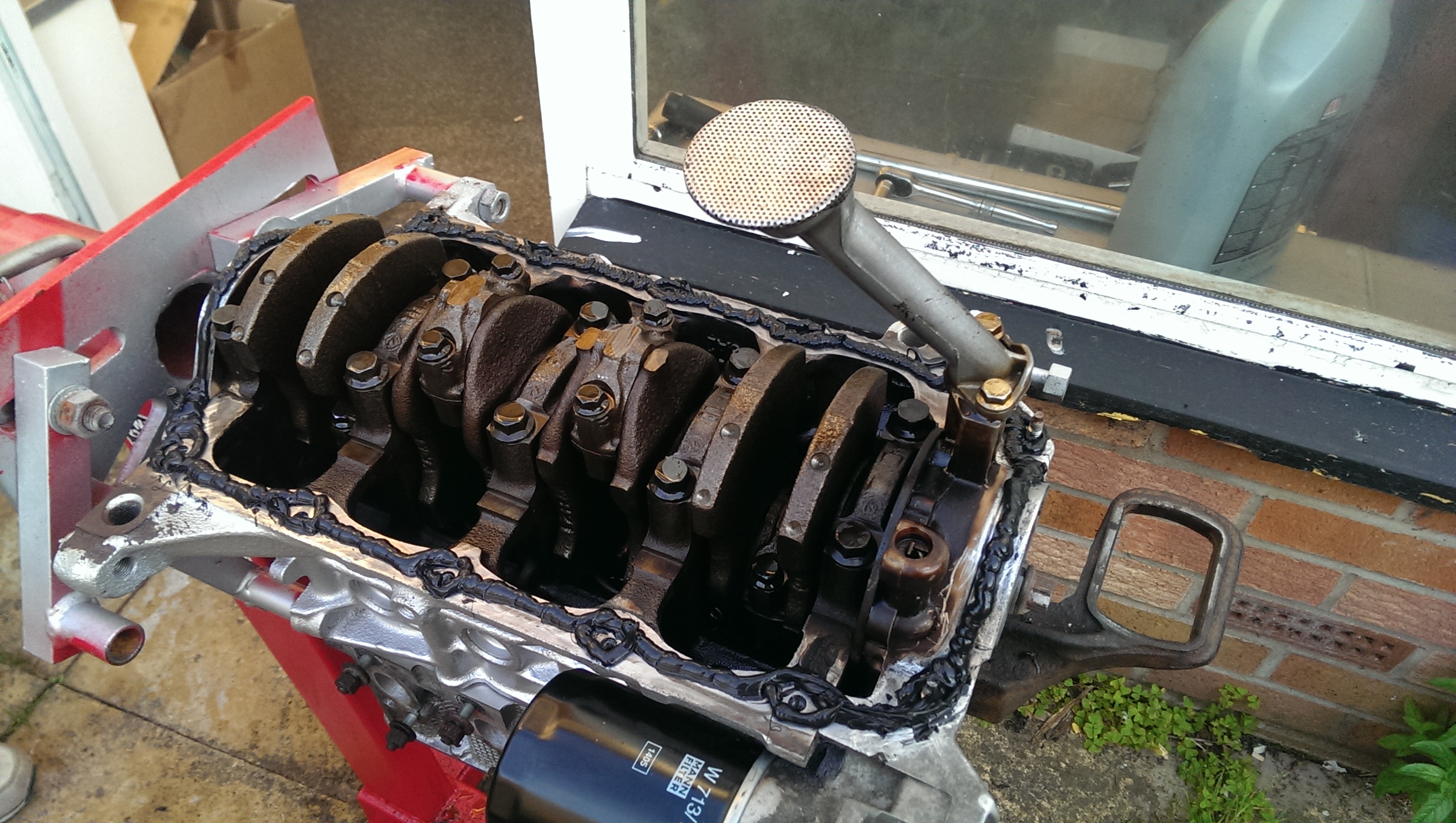

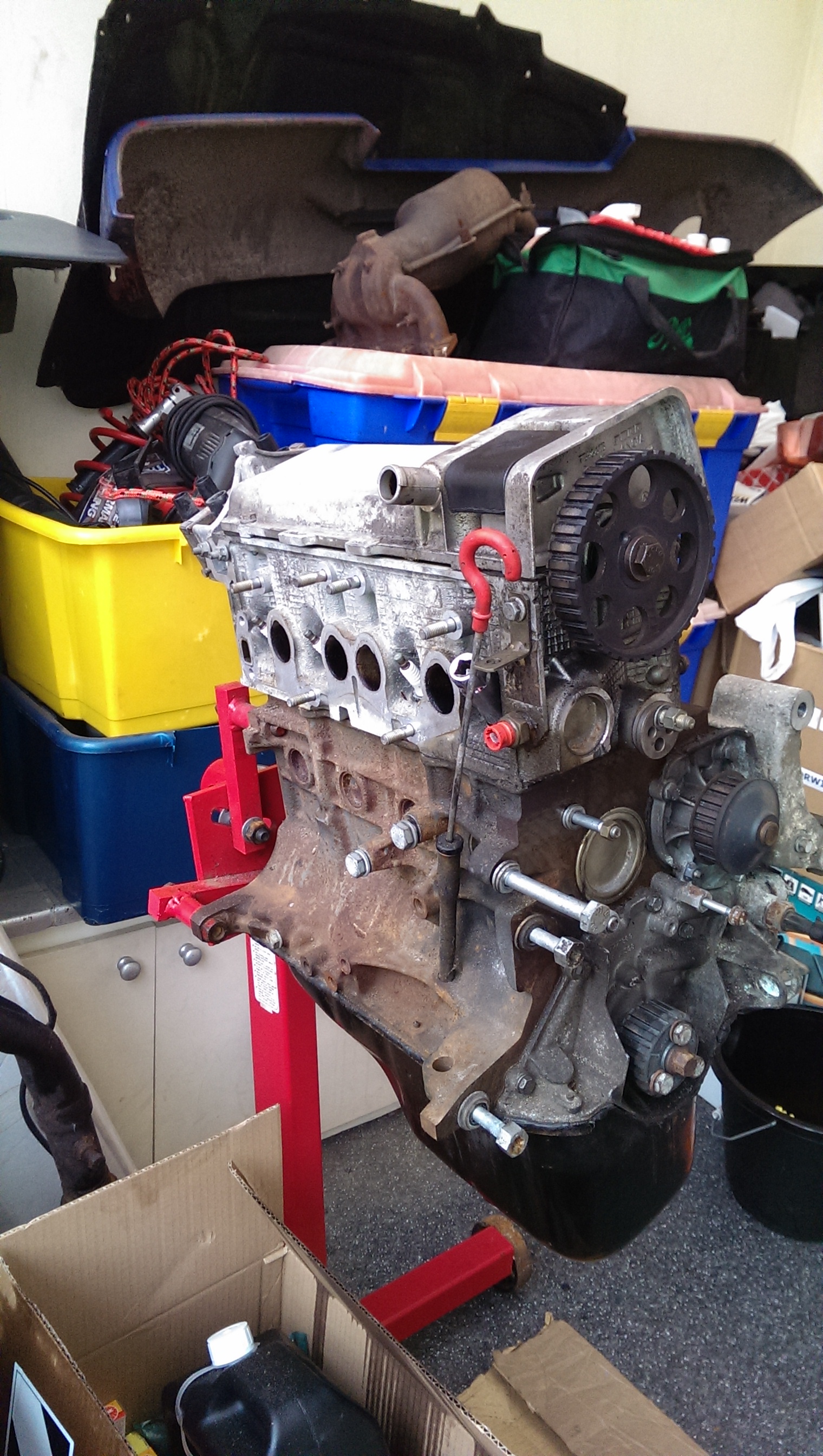

Not much has happened with the engine so far, it's mostly stripped down but still in one piece. I skillfully drained the rather clean oil out earlier on, making quite a mess :eek: The power steering pump bracket needs to be forcibly removed, the sump needs resealing and the head needs to come off and go away for a big skim :devil: hopefully some of that will be sorted at the weekend.
Thankfully the P75 down pipe has two lambda plugs so hopefully there will be no problems there but I expect connecting it to the existing exhaust may be a challenge. Having the large mpi ecu (instead of the micro ecu) hopefully it will run it without any issues, of course there is no knowing until it's in and I turn the key...
Once the block is cleaned up it will be sprayed silver and have some new core plugs as the current ones aren't looking fantastic. A red powdercoated rocker cover will come but it's not a priority.

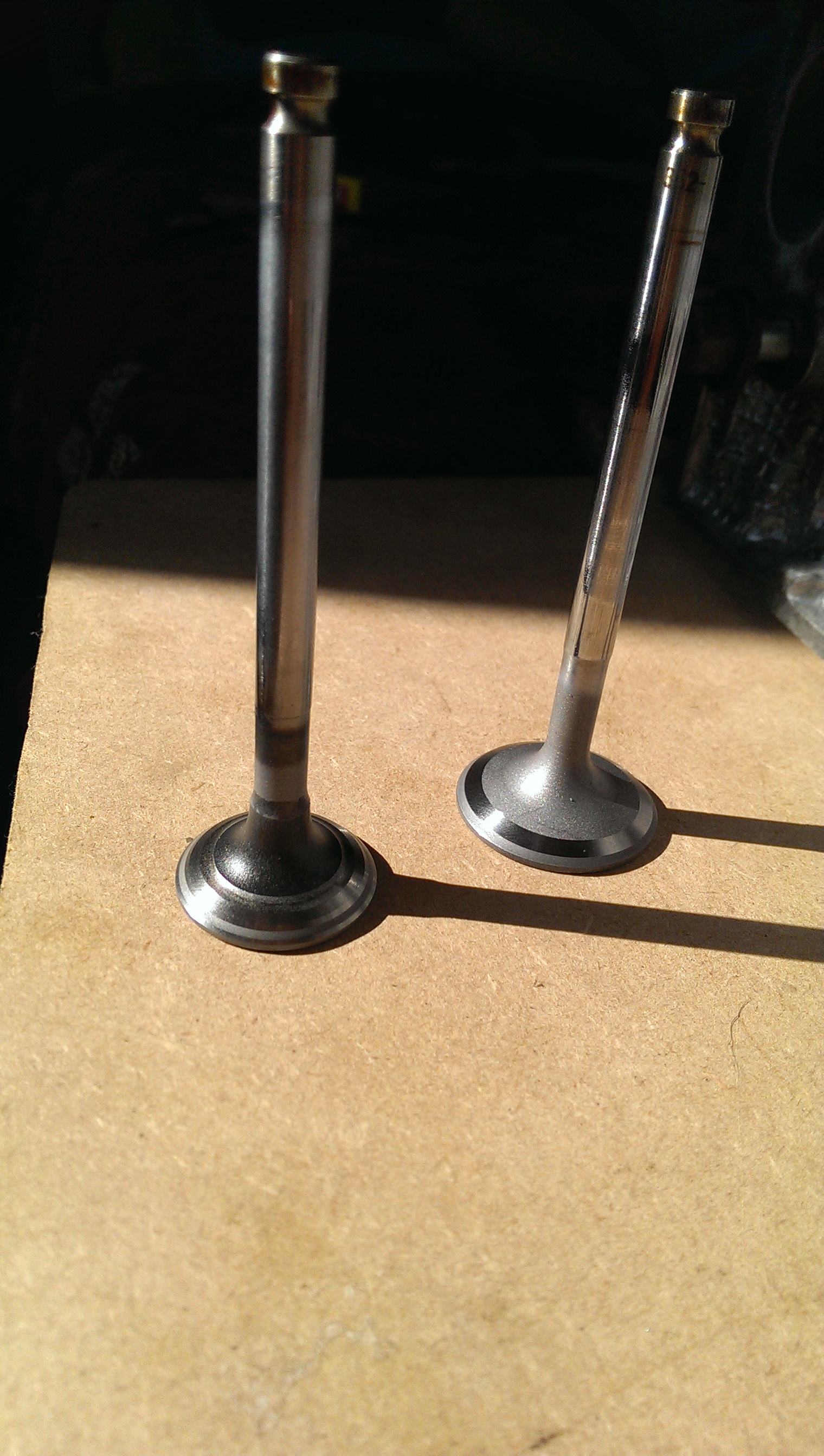

In the end the head went to TMW Engineering down the road, it's had a good clean, big skim and 3 angle valve seats with a backcut :) Thanks to Lecook for sorting that in the week for me (y)

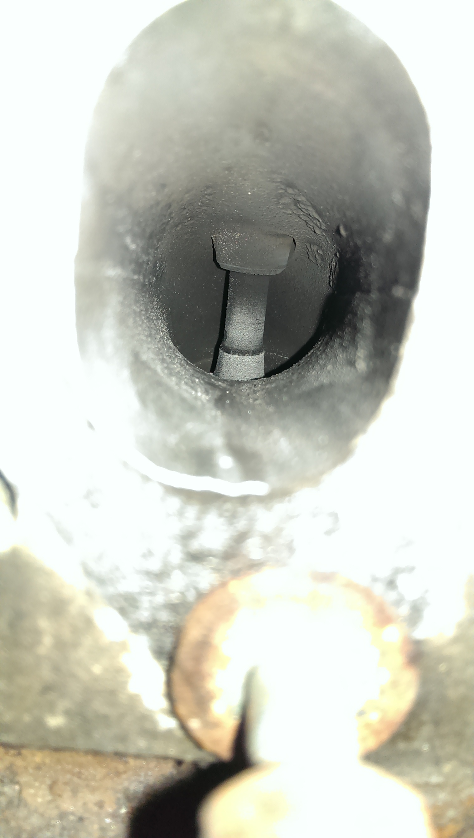

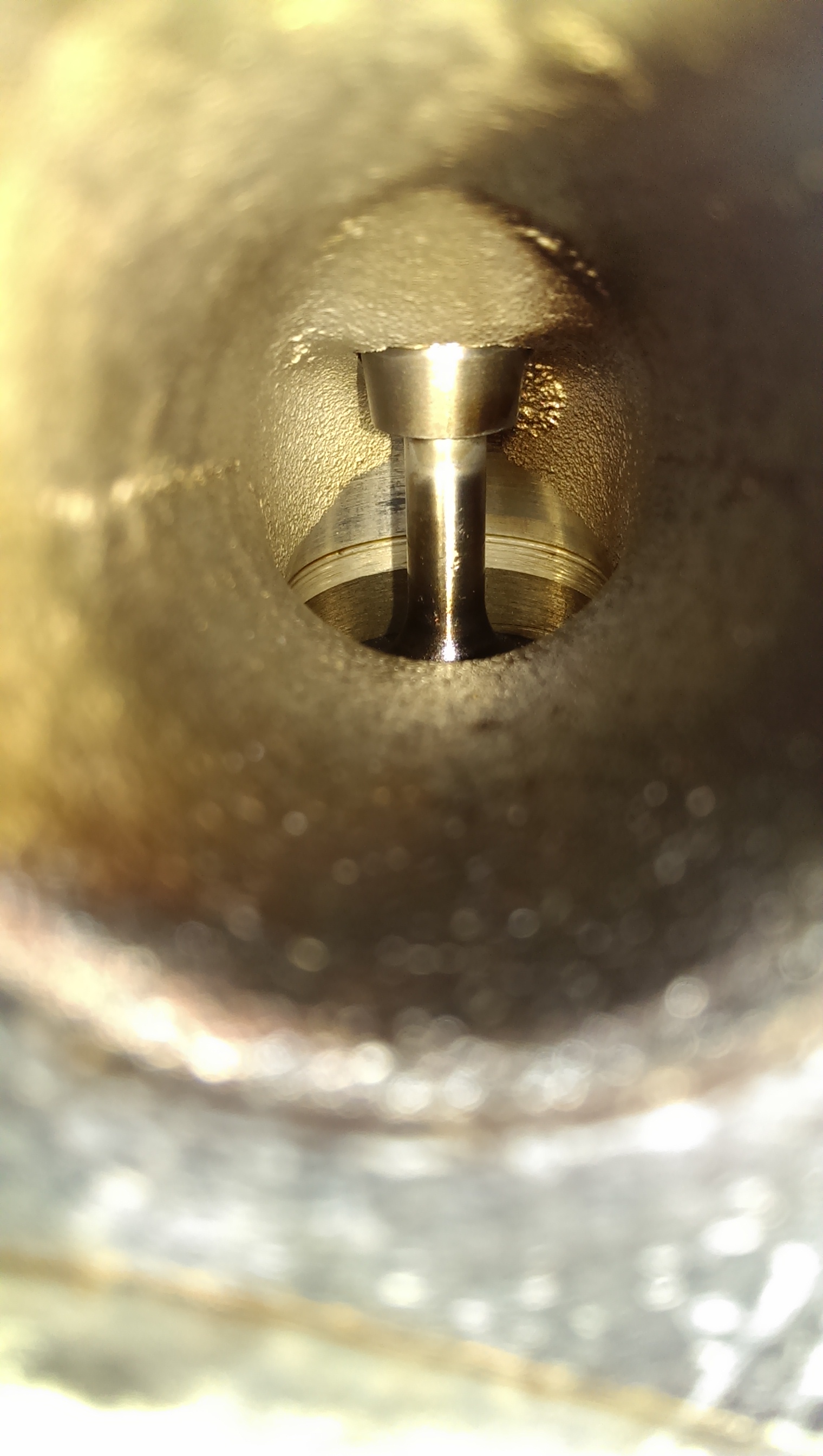

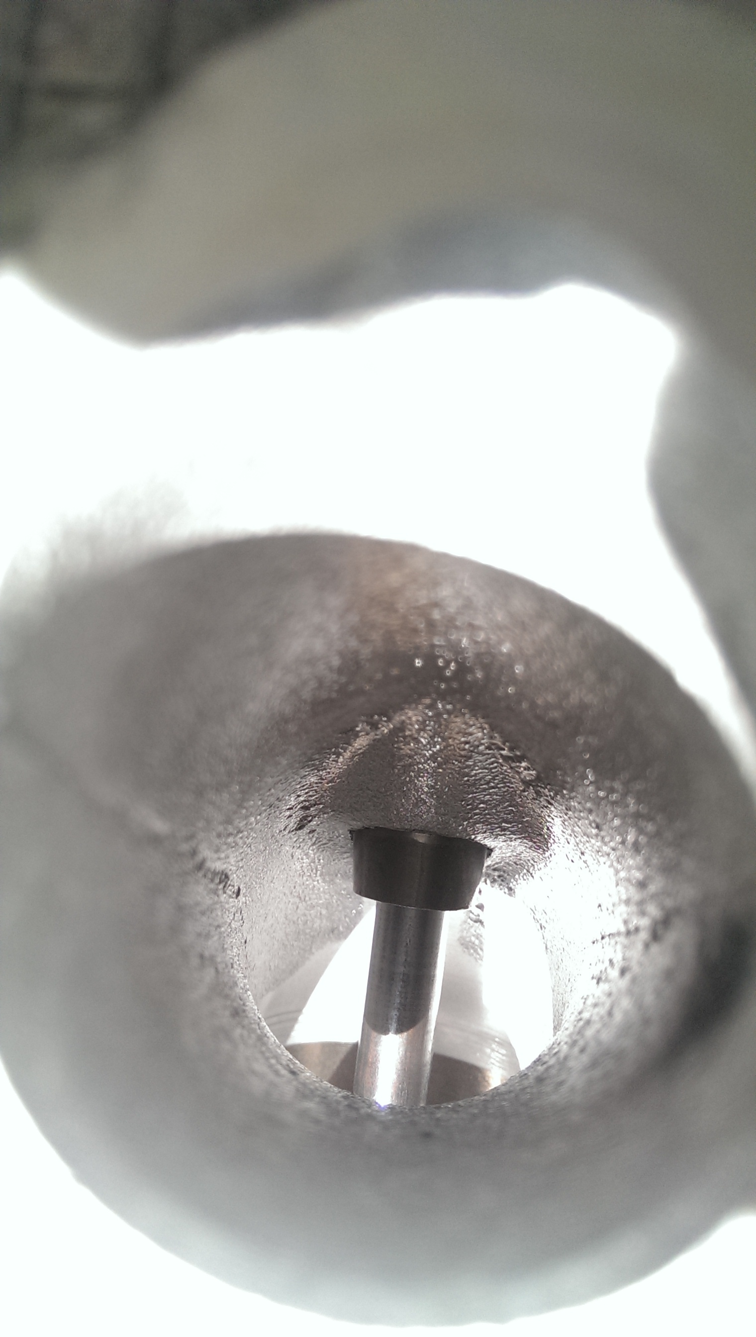

Did have a quick look when the sump was off to be resealed and it appears there are no oil jets :confused: Is this just a myth? or am I missing something?

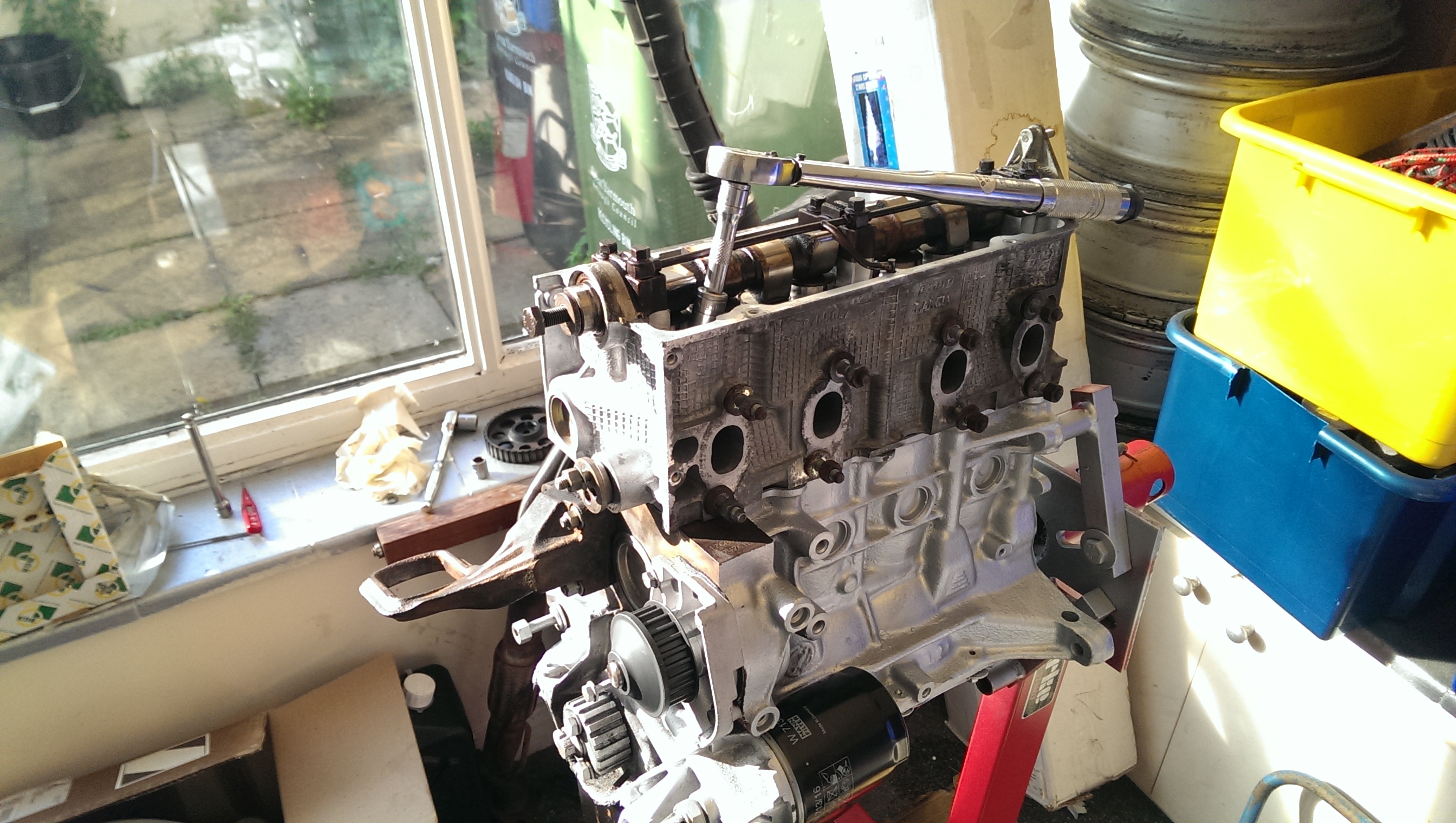

The engine is starting to go back together now, there isn't too much left to do until my engine is out so the pulleys can be swapped etc...

Never has a 1242 engine open, but I've a memory of seeing a diagram of oil flow which showed some kind of squirter. Still, the easiest way to see them on most engines is to look down the bore, piston(s) out.
The pump bracket bolt had seized and rounded off, a go with the grinder soon sorted that!
Whereabouts we're the squirters in the bores? We had it upside down and had a good look but couldn't see anything.
What is the little pickup/hole/breather or whatever it is on the oil pump beside the actual pickup?
