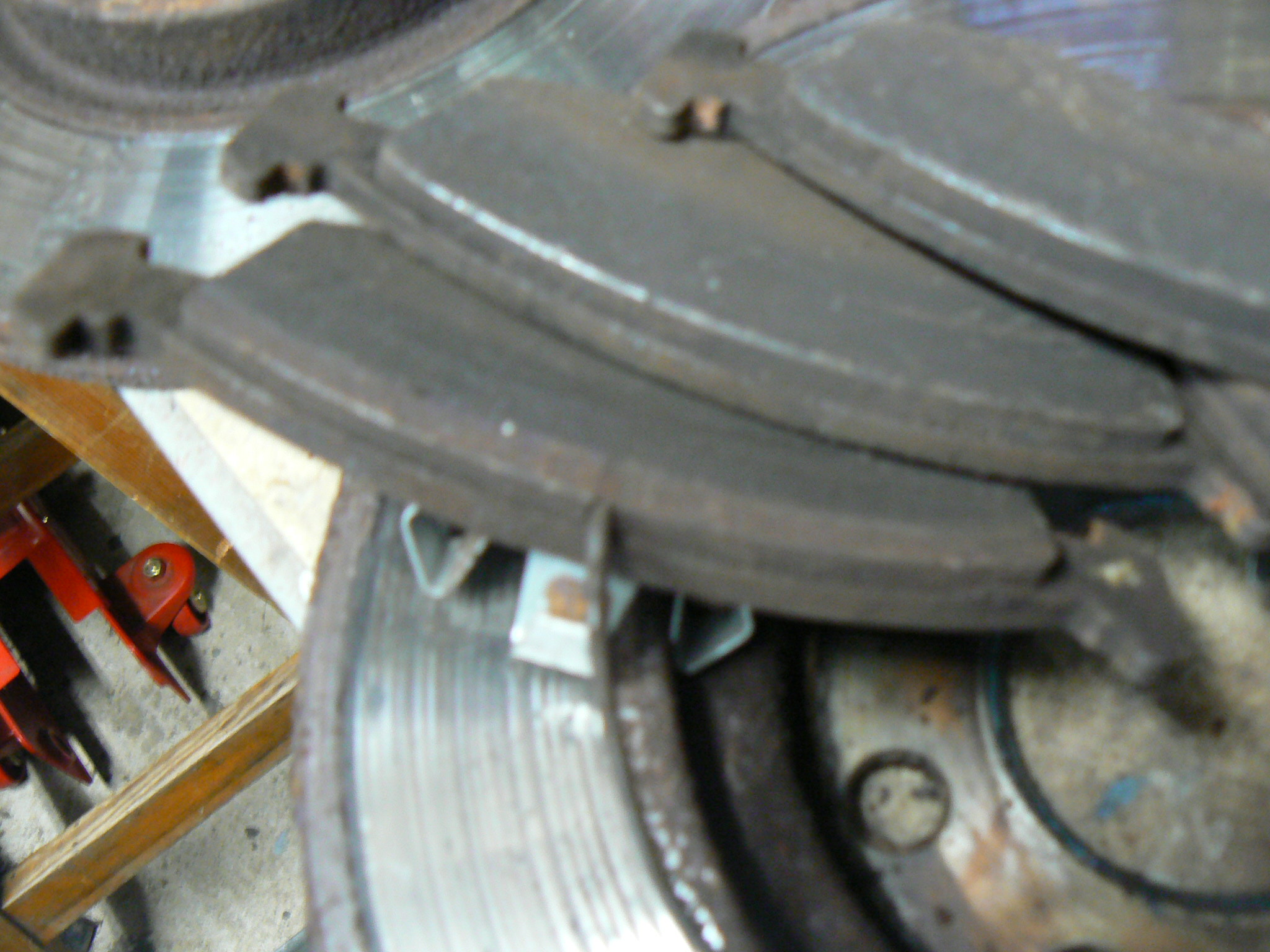

Looking at the pads they had about 2 mm still on them and were showing no signs of separating from the metal backings:

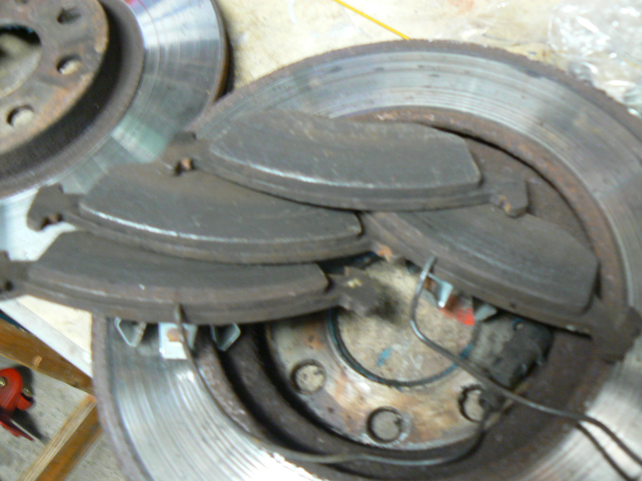

closer examination of the N/S/F inner pad shows it was just about to break through into the depth warning wire:
Unfortunately this wouldn't have done him much good as the wire to that sensor, on the vehicle side of the plug, is broken off. I found this at the summer service and asked Kenny - he of Fiat indy fame - whether this was MOT failable. It's not and the repair looks awkward as the wire has snapped off inside the molding of the plug leaving no wire "tail" to solder too. So, in the meantime I've just taped off the plug and cable tied it out of the way. In fact I think I'll just leave it that way as I'm going to catch pad wear at service intervals anyway. Note to self. Find out if there's an alternative pad available without the warning wires. I've had this in the past and found a considerable saving can be made. Wouldn't affect the warning light either as it only comes on when the wire is earthed - by touching the disc.

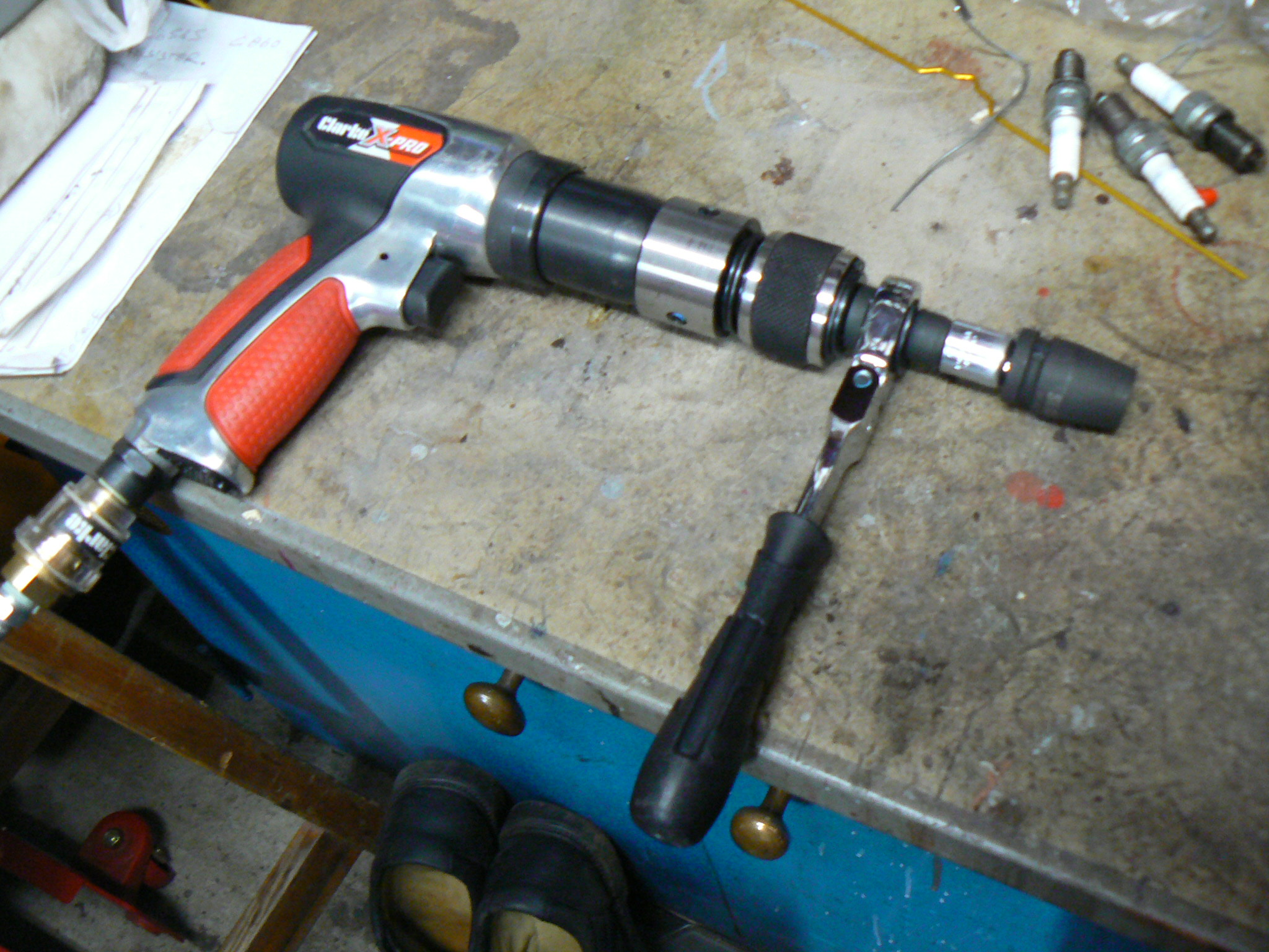

All good so far then, now to remove the caliper carriers - held on with "silly" Torx bolts. Luckily I have a set of female Torx sockets so this should be easy? However the heads of the bolts are VERY crusty with rust. So crusty in fact that I at first thought they'd take an E18 socket, which I had to hammer on over the rust. but it went on and felt quite firm. Put my power bar on it and heaved. Oh dear, great big crunch and I think I've rounded it off! Well, it does look rounded, but no, maybe not? Let's try the next size down - E16. Several strokes of the hammer needed to seat it, but actually it seems to have gone on pretty well. So I knocked it sideways off again, take a look at the bolt head, and realize that E16 is actually the right size, it was just the crusty rust which was fooling me. Ok, back in we go with the powerbar on the socket and, Oh dear, this is so tight. I could put a length of scaffold bar on it but I don't want to round it. Then I realise the shape of the Torx bolt head and the E16 socket are such that if I use the Vibroshock tool it can transmit the shock loads directly into the bolt. So this is an ideal job for Vibroshock! Here is the socket assembled onto the tool:it is ready to fit to the air hammer:

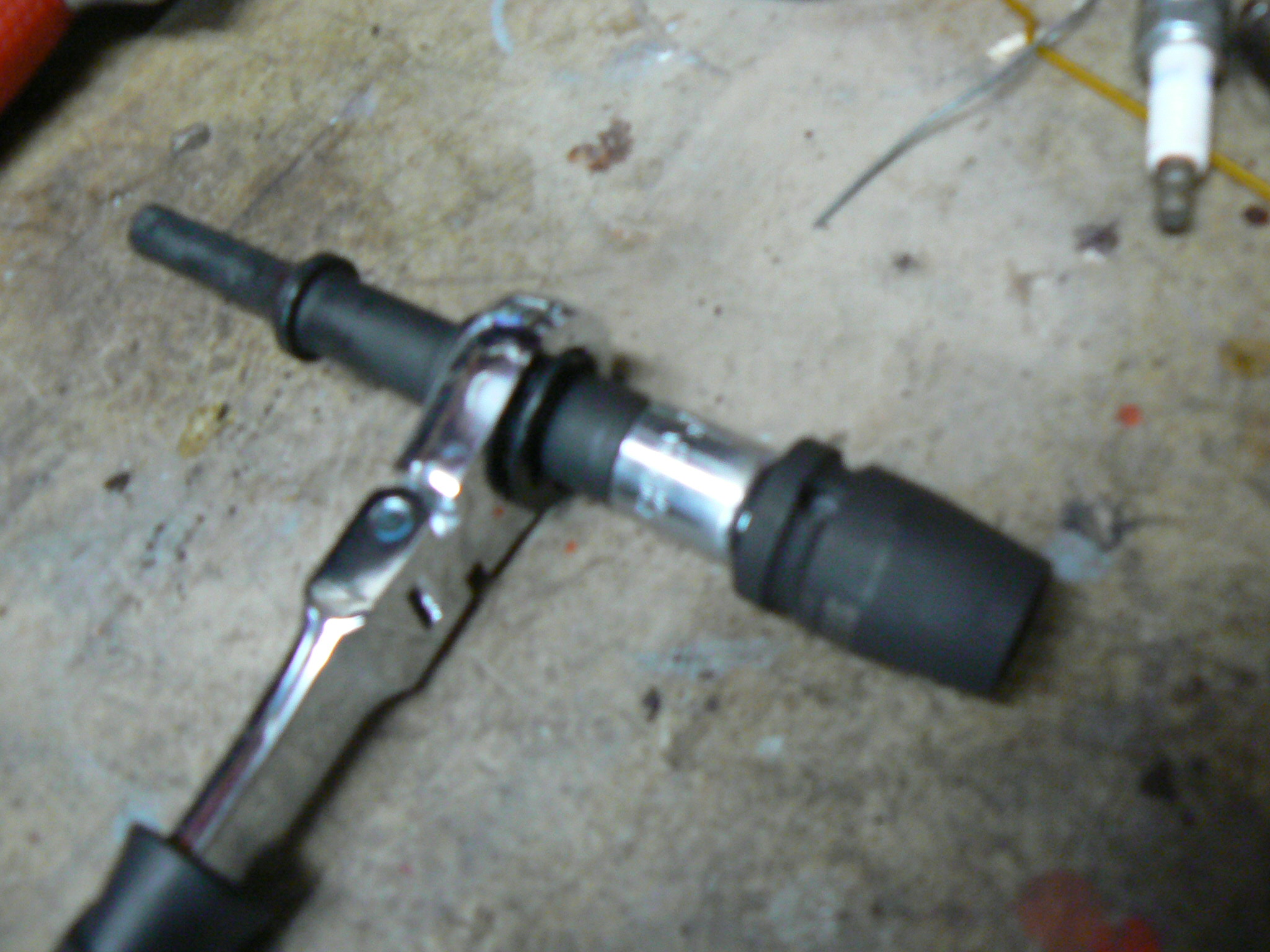

and here's the whole shebang ready for action:
Gave it a good rattling, less than a minute, and the bolt comes free quite easily. Hurrah!
All 4 bolts were in similar condition, were given the same treatment and all came out not much the worse for wear.

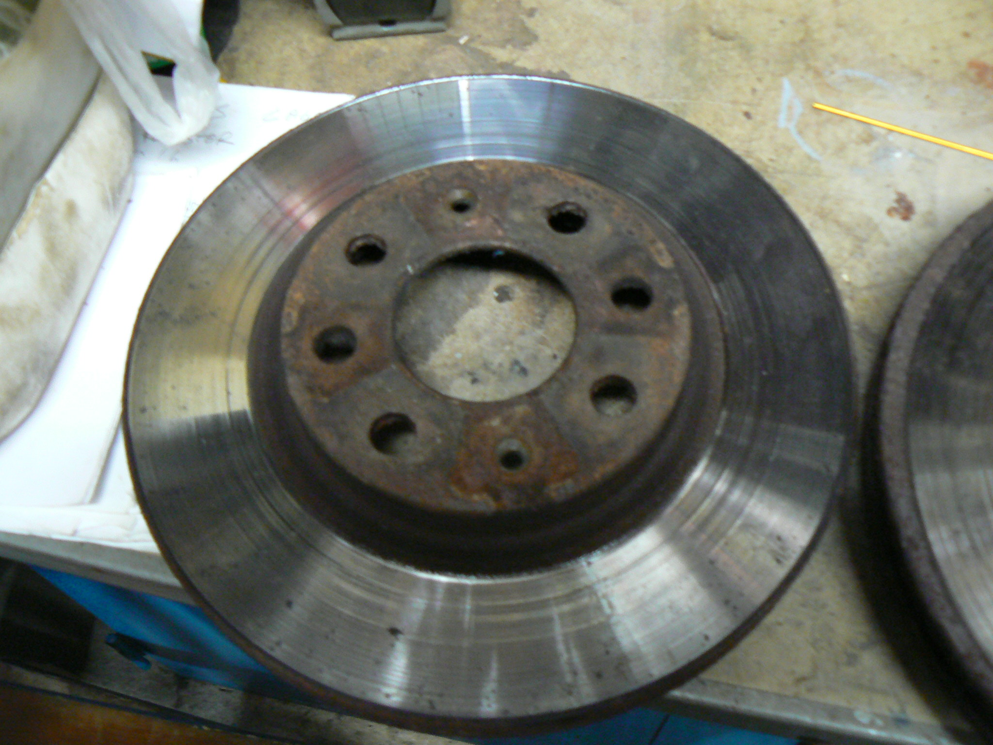

Now on the bench I could see that deciding to renew the discs was definitely the right course of action. Although looking not too bad on the front - outer - faces, bit of surface unevenness and some rust on the edges of the pad contact face:
The inner faces were somewhat worse with deeper scoring and more rust, some actually beginning to reducing the effective pad contact area:
If money had been a critical factor I think you could have just done pads without changing the discs and I'm sure it would have reached braking figures which would have satisfied the MOT - Due next month - but a year or so down the line? No, better just to do the discs too. Also there's one very long and steep hill - Church Hill - on his route to work which gives the brakes a good work out.
