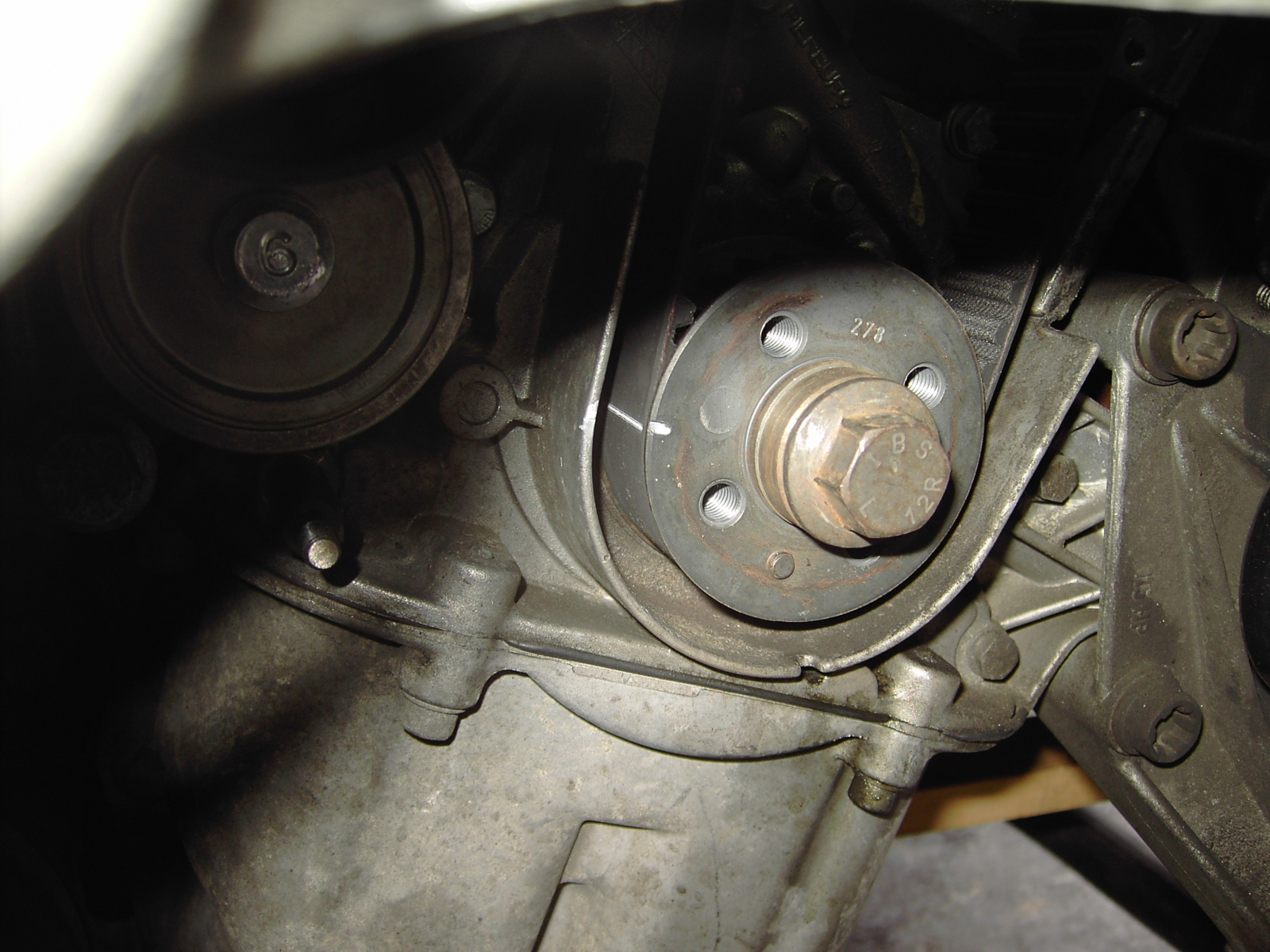

multipla 1.9 jtd help help ??????? today car was making funny noise sounded like belt slaping removed top cam belt cover and all was ok so though it may have split a bit off the edge so wound the nut on the end of the cam shaft to move the belt around a bit to have a look and the bloody belt jumped :bang: anyway cut a long story sort it was the crankshaft pulley rubber fell apart and thats what the noise was The cam belt was mega slack so i got a new belt but there's no lower timing marks and the top one god known s as one thread said line the two mark s up and the other said seven teeth in front of the mark. help i confused . com:slayer:

There's a special tool to lock the crankshaft sprocket in position but if your new belt has the three lines marked on it, you may be able use the appropriate line and the crankshaft sprocket mark. The crankshaft sprocket goes in the position shown below but there is no mark on the cover (I painted the mark in the picture) so you would need to decide which is the appropriate line.

hi davren thanks so much for the help that s just what i needed to see i will give it a go tomorrow turning by hand first (y) from the bottom this time :idea:
Only turn it clockwise by the crankshaft sprocket nut, never anti-clockwise or the same problem may occur.
EDIT: Turn it gently and slowly, the crankshaft sprocket nut is a lefthand thread.
