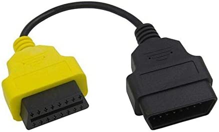

OP OP M mwp Member Joined Mar 26, 2023 Messages 18 Points 60 Location stevenage Mar 31, 2023 #5 can any one tell me these will be ok to use foe flashing mileage on fiat 500l from amazon. Attachments 81oJhQC2jYL._AC_SL1500_.jpg 162.5 KB · Views: 32 3147lL-+flL._AC_.jpg 10.5 KB · Views: 29
the green vanper Established member Uploaded a resource/download Joined Feb 7, 2023 Messages 421 Points 190 Location Silesia Apr 2, 2023 #6 mwp said: do you know if a dephi will sort this out,,,,,,,,,,, Click to expand... As far as I know, only genuine MES. For the cables, no idea. I've got one cable + one bluetooth dongle, both apparently should work, but I had no occasion to test it yet.

the green vanper Established member Uploaded a resource/download Joined Feb 7, 2023 Messages 421 Points 190 Location Silesia Apr 4, 2023 #8 mwp said: tried a proxy alignment with elm327 and it keeps saying failed Click to expand... Full version genuine MES? I had to buy a special dongle that works with MES. The one I was using before, some kind of universal one was not working, too.
the green vanper Established member Uploaded a resource/download Joined Feb 7, 2023 Messages 421 Points 190 Location Silesia May 10, 2023 #9 Just tested the Proxi alignment procedure with my set: genuine MES + Viaken STN1170 OBD bluetooth dongle and it went fine.
