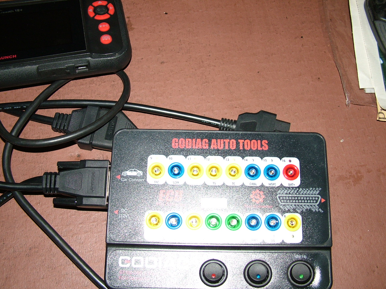

Another point I use a "breakout" box to plug the OBD port to as it can tell if the two lives and two earths required at OBD port are working as that can be an issue.

Re the port connections , if you zoom in enough on my photo you can read them.
