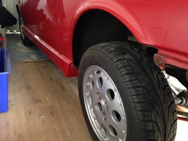

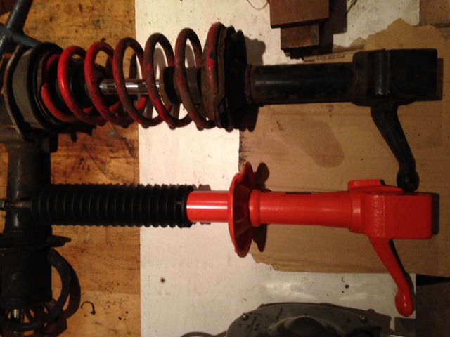

Interestingly the new front shocks have a smaller distance from the base of the strut to the the base of the mounting plate for the spring. Around 20mm. I have tried to show this in the photo below but it hasn't come out great unfortunately.
So by my calculations 20mm from the new shocks plus 40mm from the Jamex springs means that the Y10 should be 60mm lower than standard at the front :devil:
Might need a sump guard at this rate :idea:

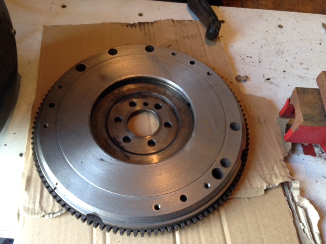

Lightened flywheel weighs in at 4.6kg. Not sure what a standard one is but hoping this will make quite a difference to the engine performance :D

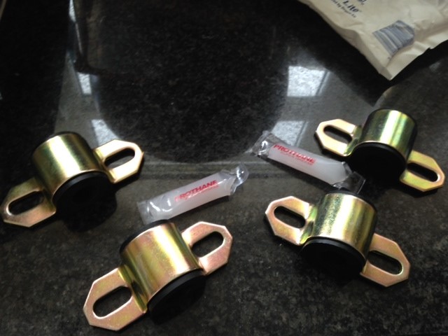

The poly bushes for the anti roll bar have also arrived :D 16mm internal diameter for the ARB itself and 17mm for the reaction rod.

Wow lots been happening. Good work :D I see what you mean by the shorter shocks. What make are they? They look a lot like Delphis. Loving the look of the ARB bushes and clamps. You prob already know but the reaction rod clamps will require 4 13mm bolts & nuts. The studs are an integral part of the original clamps that go round the reaction rod.

Looking forward to sheering some bolts when I install the bushes on the ARB. I have change the bushes once before and a few bit the dust that time so expecting the same this time around.

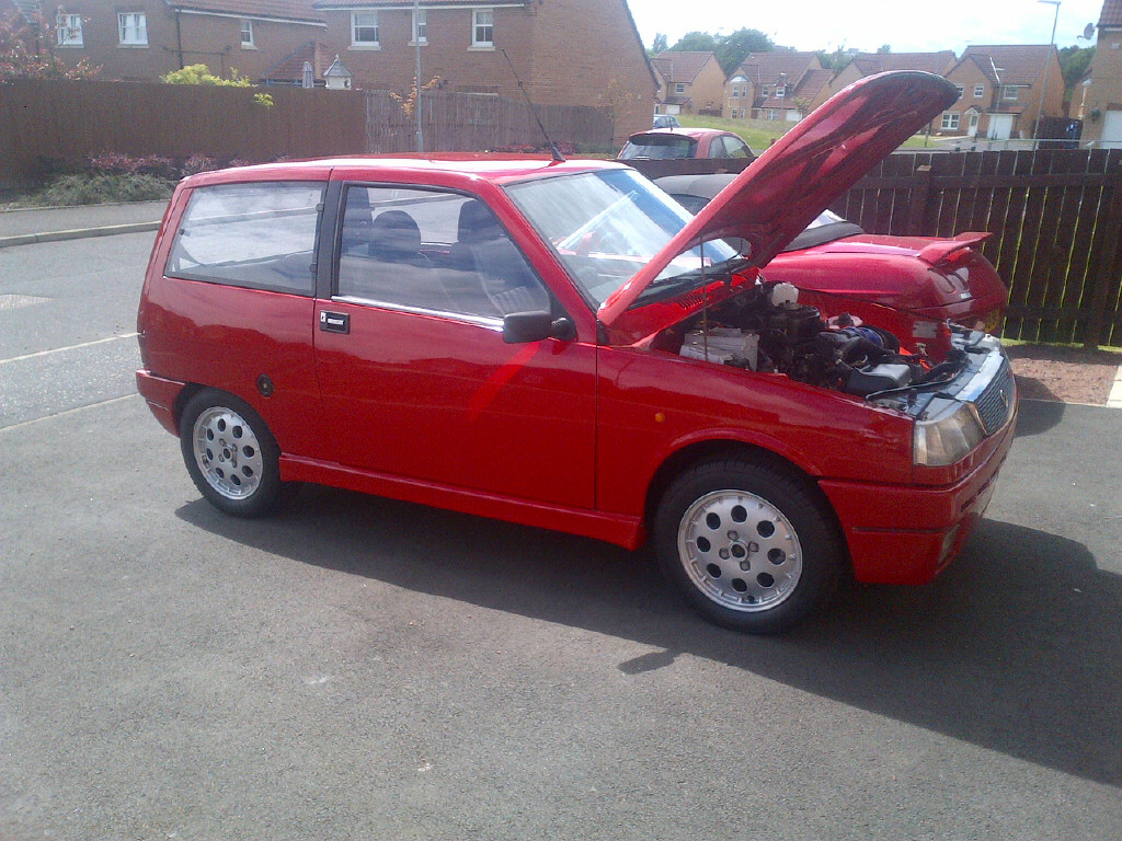

The photo below is from last summer before leaving for Panda Camp 2013. Will use this as a comparison photo for the front suspension. This is standard shocks and springs. Should be 40-60mm lower once it is all back together :slayer:
I think the suspension may be heading in the wrong direction...
The fact that the engine is still out might have something to do with it :D

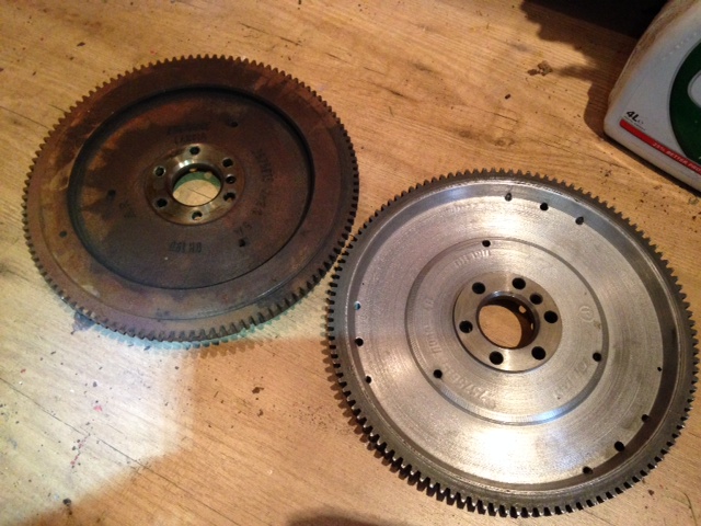

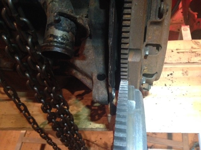

Just about to fit the lightened flywheel and thought I would try to show a comparison with the one that is on at the moment. I will put them on the scales to see the difference.
