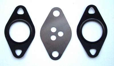

There was a Fiat modification for the EGR valve gasket that involved using a swirl plate to mix the exhaust gas better. I believe this was supposed to keep the valve and manifold cleaner.
Part number for the swirl plate is 71751469........ £13.32 +VAT
Part number for the normal gasket is 46773082..... £1.72 +VAT

1. If you're as tight as me it's dead easy to make a swirl gasket from a piece of sheet metal: cut it to the same shape as the original gasket (I did it with an angle grinder) and drill 2 holes for the bolts to go through and 3 holes (approx 4mm) for the swirling effect.
2. Fit the original gasket with the "lip" against the corrugated pipe side (not against your new gasket) . I say this because I noticed when I once used a thin bit of sheet metal to temporarily block off the EGR I had the lip against the gasket and it started to cut into gasket after a while. The danger then is it might cut all the way through and go down the inlet manifold:eek:
