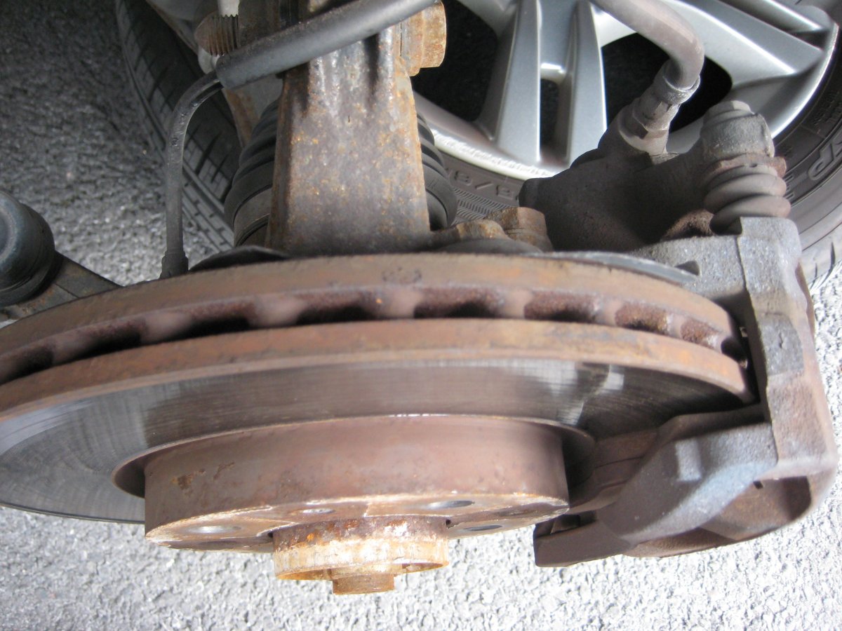

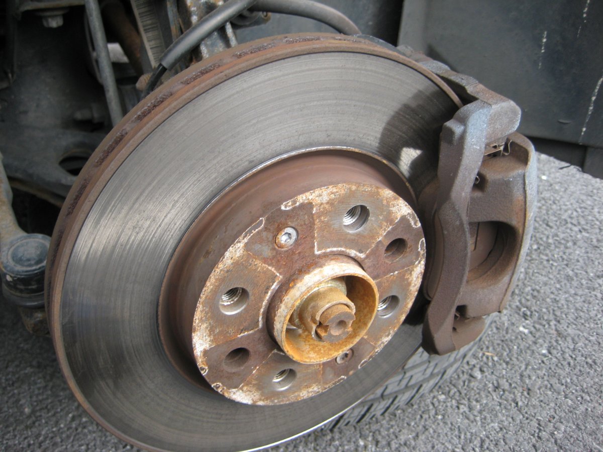

The car is an '06 and it only has 24000 Km. I honestly don't know if the pads have ever been replaced... what I do know is that the car was parked for 3-5 months at the dealer's before I bought it. Could it be the it built up dirt or rust? I suppose I'll know once I take the wheel off.

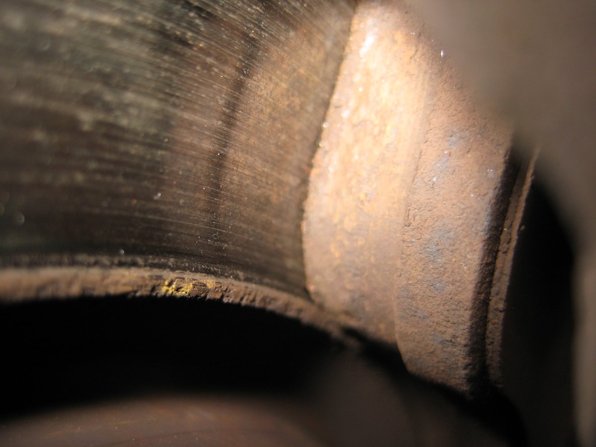

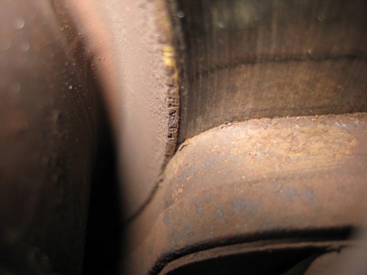

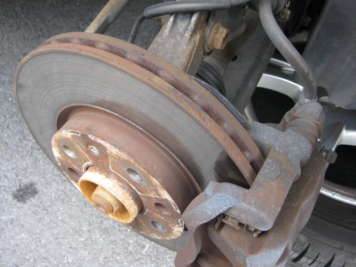

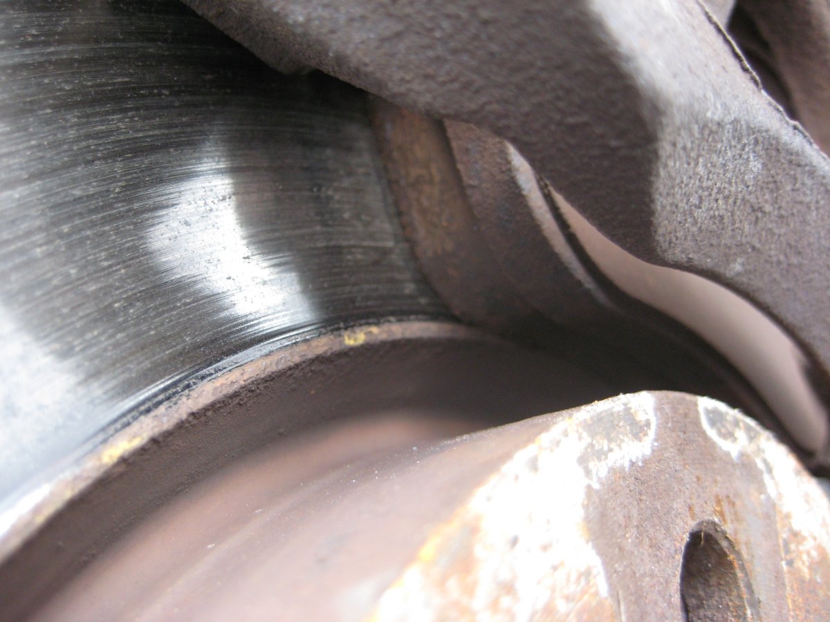

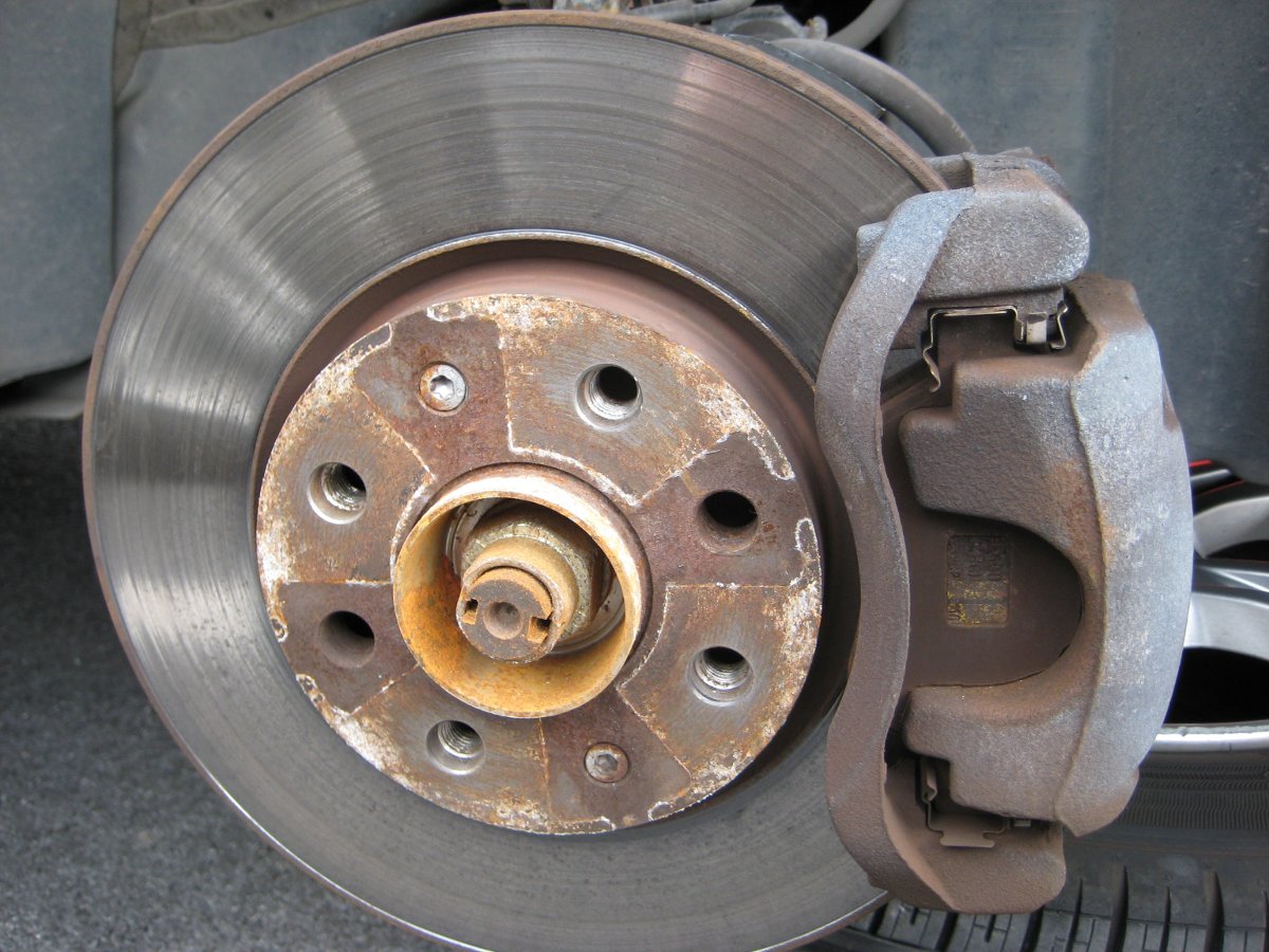

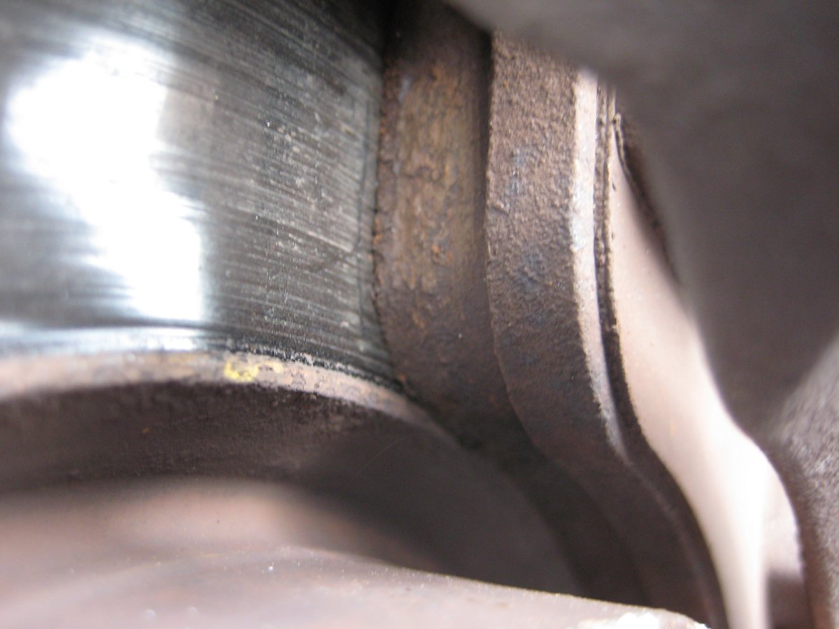

So I took the wheel off and it doesn't look bad to me but I'm no expert so I took a few pics and I'm going to post them here so the experts can judge better.
Thanks!
