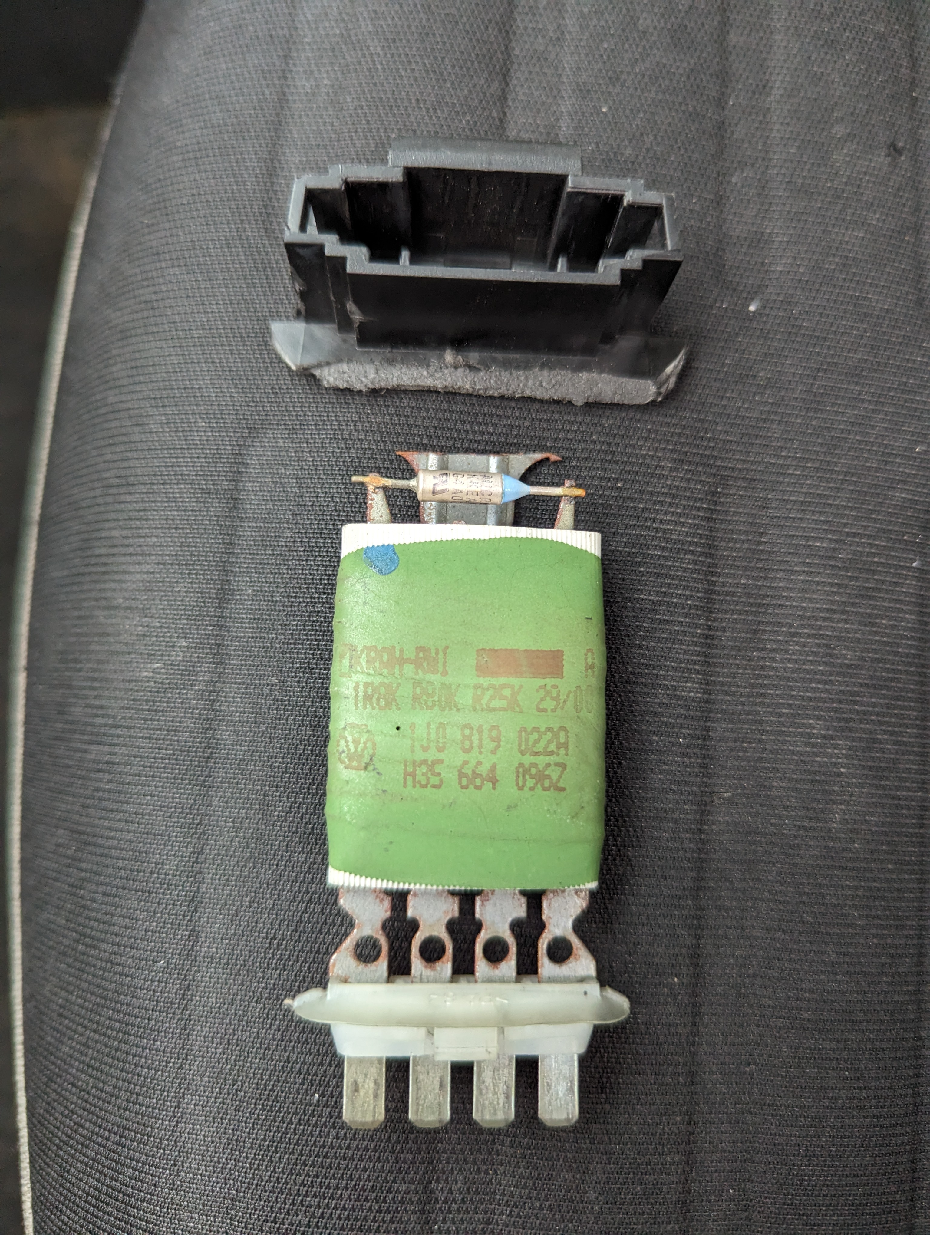

Picture 2 - This is the current resistor that in place and looking at the part number, its from a Golf mk4. As you can see, it only has 4 x male pins.

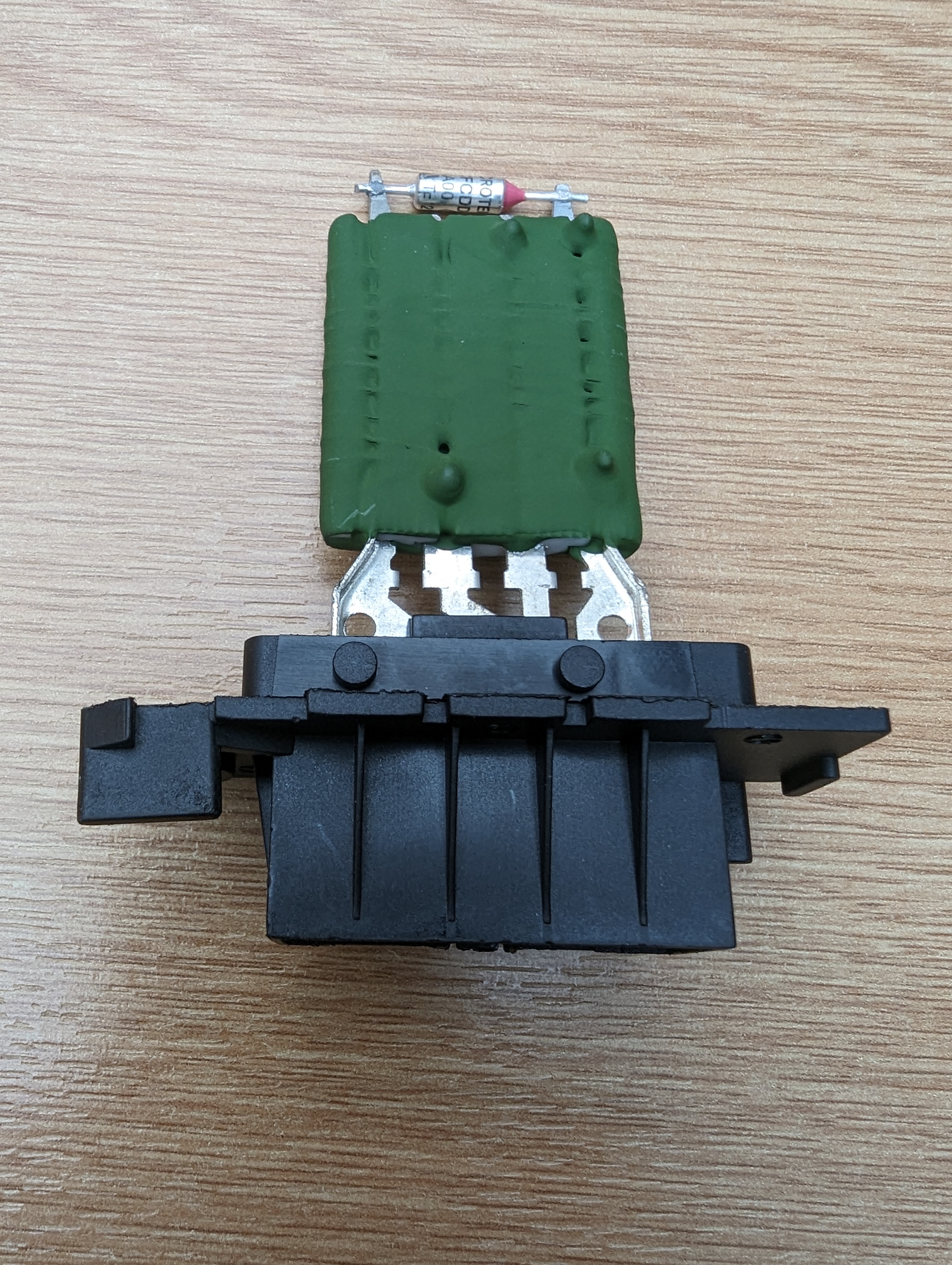

Picture 3 + 4 - This is the new and correct fitment for my Punto.

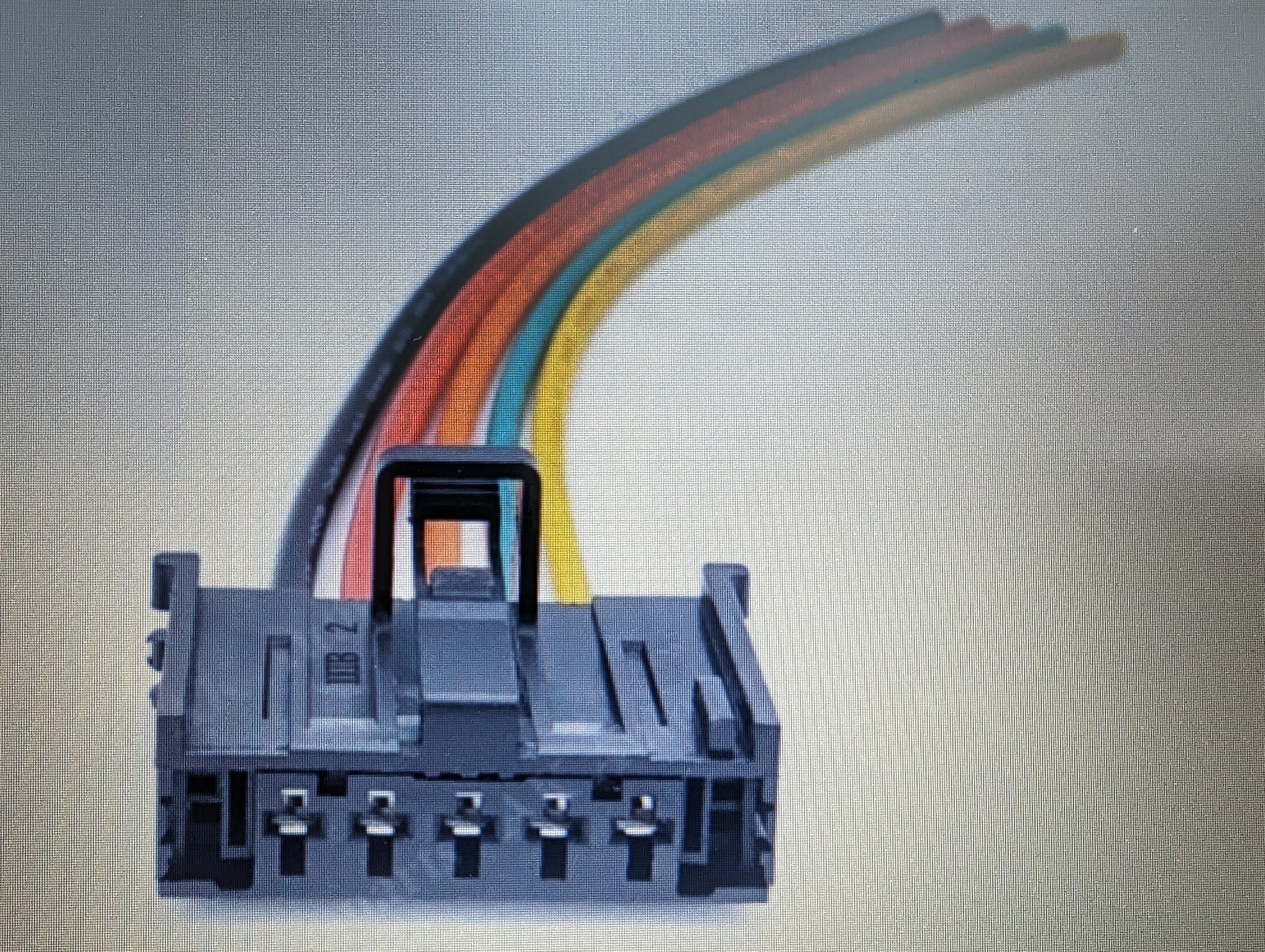

I could purchase a new wiring loom to replace this Golf one but the ones for the Punto come with 5 coloured cables and I only have 4 currently. How would I wire the new "Punto" Resister to the DIY wiring as I have an extra wire?
