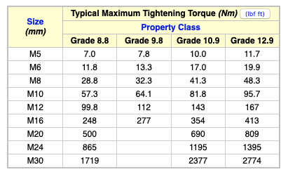

Generic MAXIMUM specs for M5 to M30 from https://www.engineeringtoolbox.com/metric-bolts-maximum-torque-d_2054.html
I would use grade 10.8 but tighten to 30 Nm. Its more than enough to clamp the bracket and well within the bolts limit.
2774 nm
Guess that a 10 tone excavator digger arm needed to tighten 😂

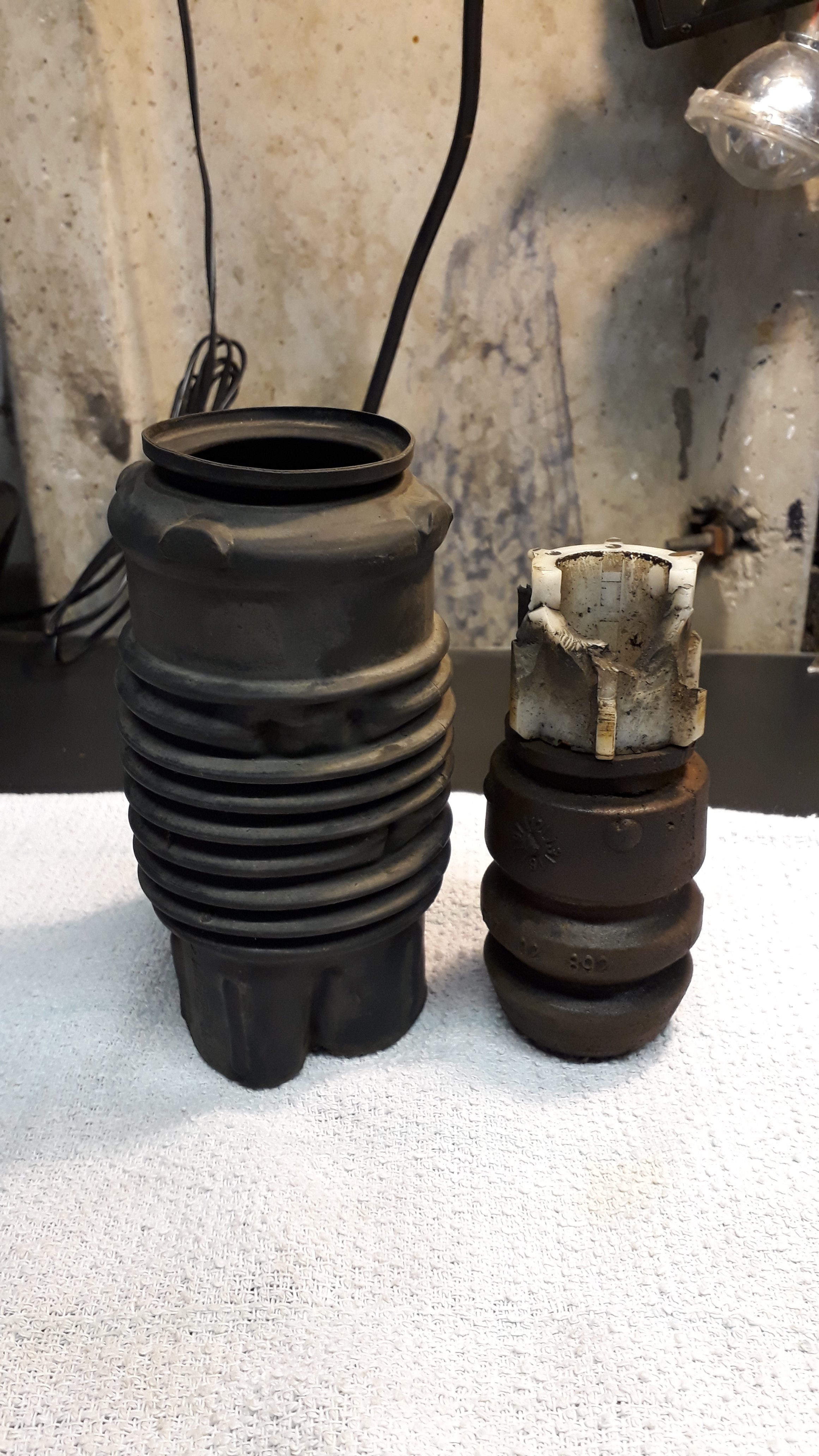

Thank you. Without a detailed diagram of of the front strut, I think I'm going to need.
Top mounts x2 (are the bearings integral)
Bump stop & gaitor x2 ( N/S has broken up )
Spring seats I'm not sure about as I can't see them on any diagram when googled or where they fit.
M10 bolts x4
If anyone has or can direct me to a detailed diagram I would be most grateful.
OK. To add to my post,the bump stop and gaitor I refered to according to Shop4parts, is called a front strut buffer on the 2 wheel drive car (which mine is) and Front shocker cover on the 4x4 So the parts are now ordered. This is where a exploded diagram with part names would be extremely helpful when ordering. If anyone has one, please post. (y)
i simply got Febi-Bilstein bump stops from eBay. The originals were not bad but for the price I just replaced them.
Personally I’d be happier if they had rubber bellows gaiters that clip to the top of the shock. They would do a better job of keeping the seal clean.
Did the job today as you can see the bump stop was in a sorry state. The the top mount didn't look all that bad after the spring pressure was released, however the ride height is the same on both sides now 61 cm so it must have been on its way out. The top mount came with the bearing but the old one looked and felt fine so I'll keep hold of that.
Thanks to all for the help on this matter. (y)
