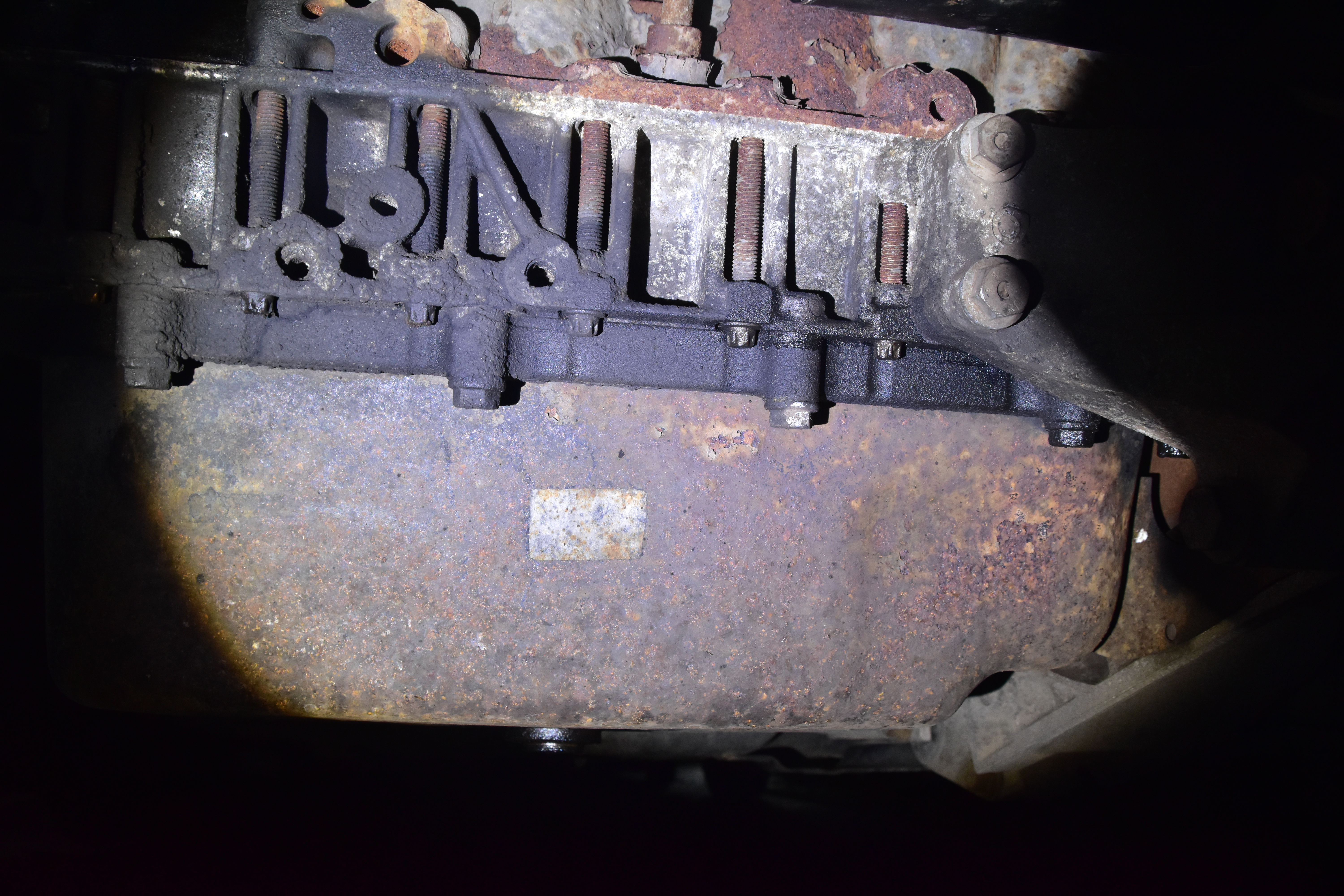

In general if a clutch judders badly on trying to pull away particularly up a a steep hill, the first thing I would check for is any oil around the bellhousing of the gearbox, often if parked on a slope with the gearbox higher than the engine, or if gearbox oil level to high or merely of the oil seal and/or the bearing on the first motion shaft starting to fail, then oil can run onto the clutch plate.
This can start as a slight judder gradually getting worse, in extreme cases the oil will cause the clutch to slip.
