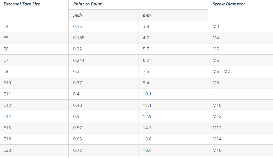

Busy doing some small jobs on the g/f's 2014 Panda, but when I went to remove the lower bolt from the rear shocks I was delighted to find that Fiat had stopped using a standard bolt to retain the lower part of the shock...!
Before I spend £££ on a full set of suitable sockets to fit this External E-Torx bolt - would anyone know what specific size Fiat have used for this rear shock assembly bolt?
.....and, did they also replace any other standard bolts with E-torx types, as I need to do a couple of other small repairs so don't want to be backwards & forwards to the autoparts dealers to grab more tools.
