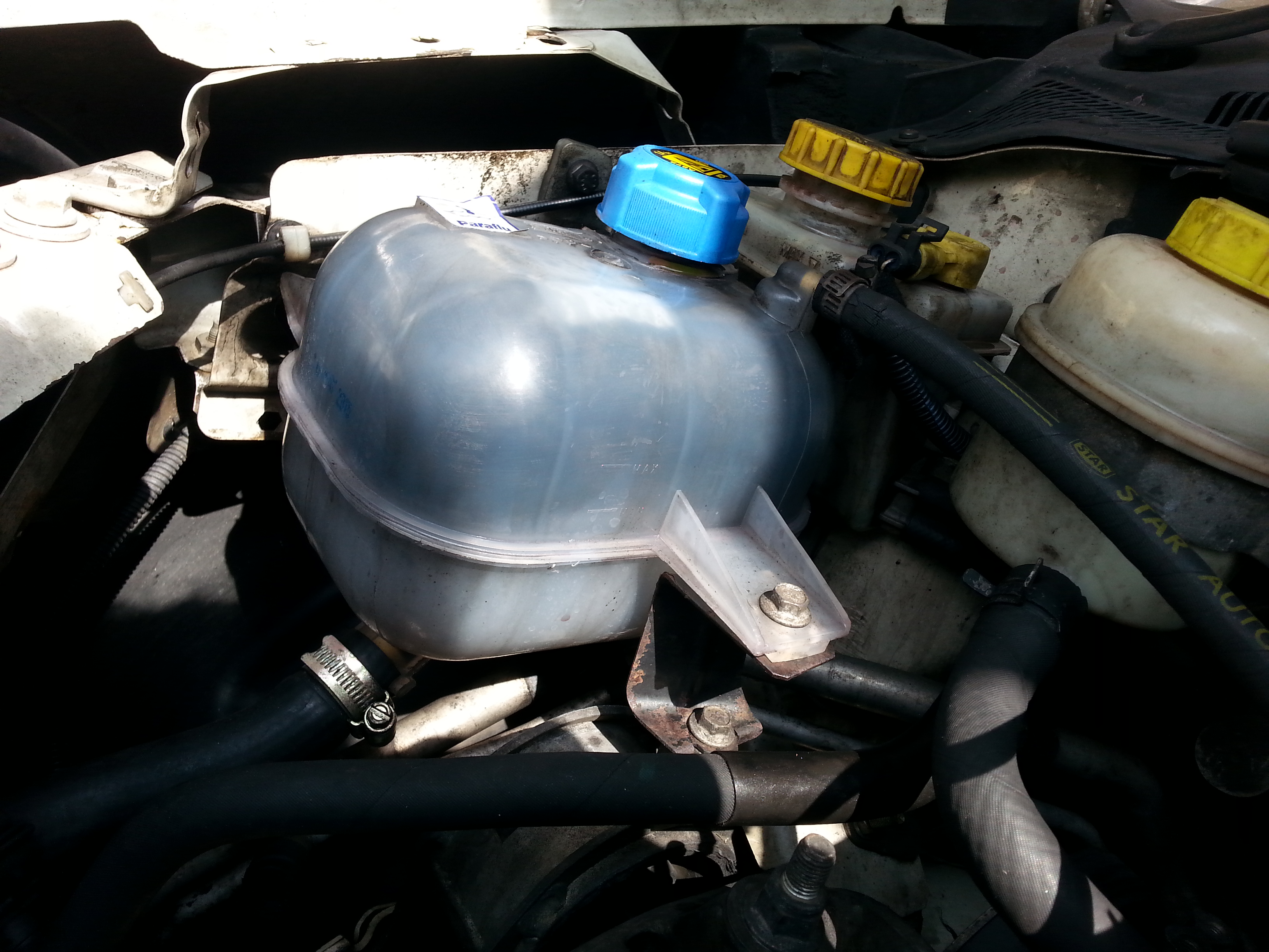

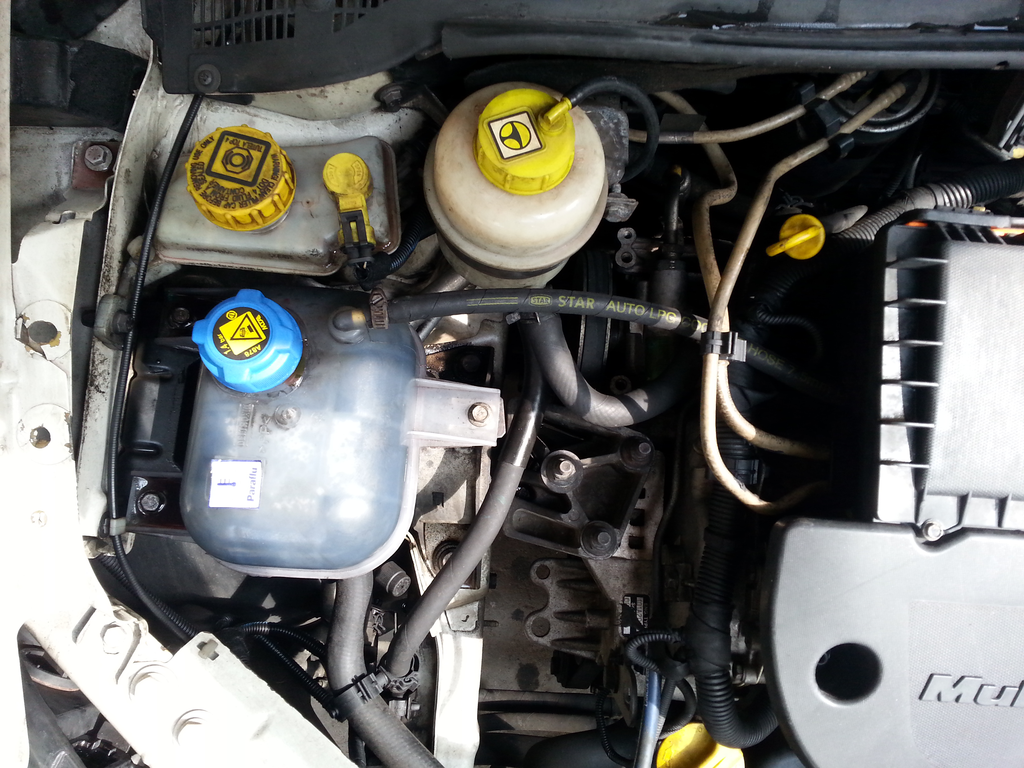

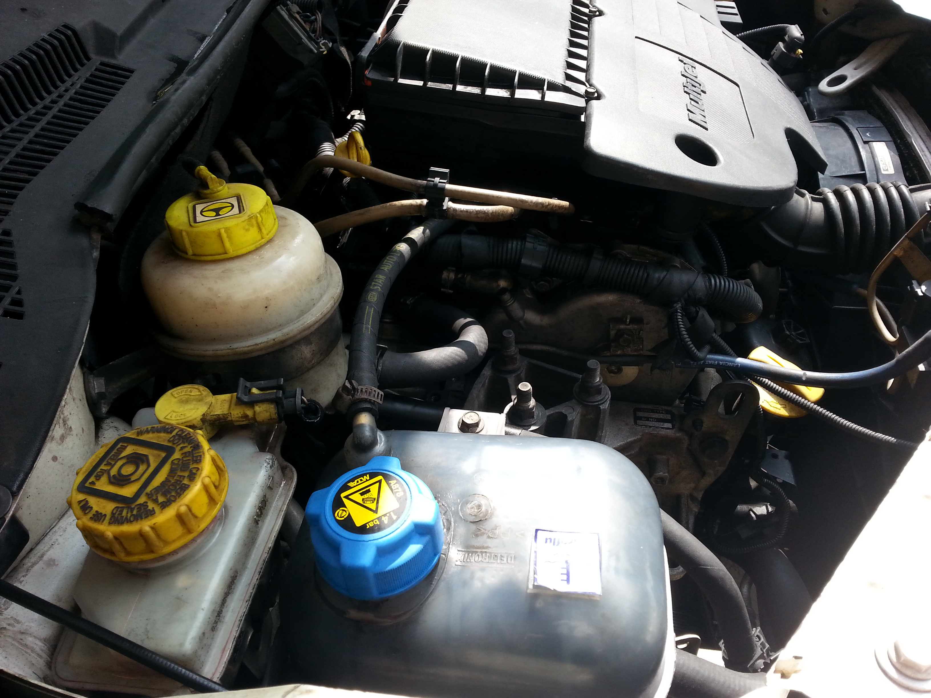

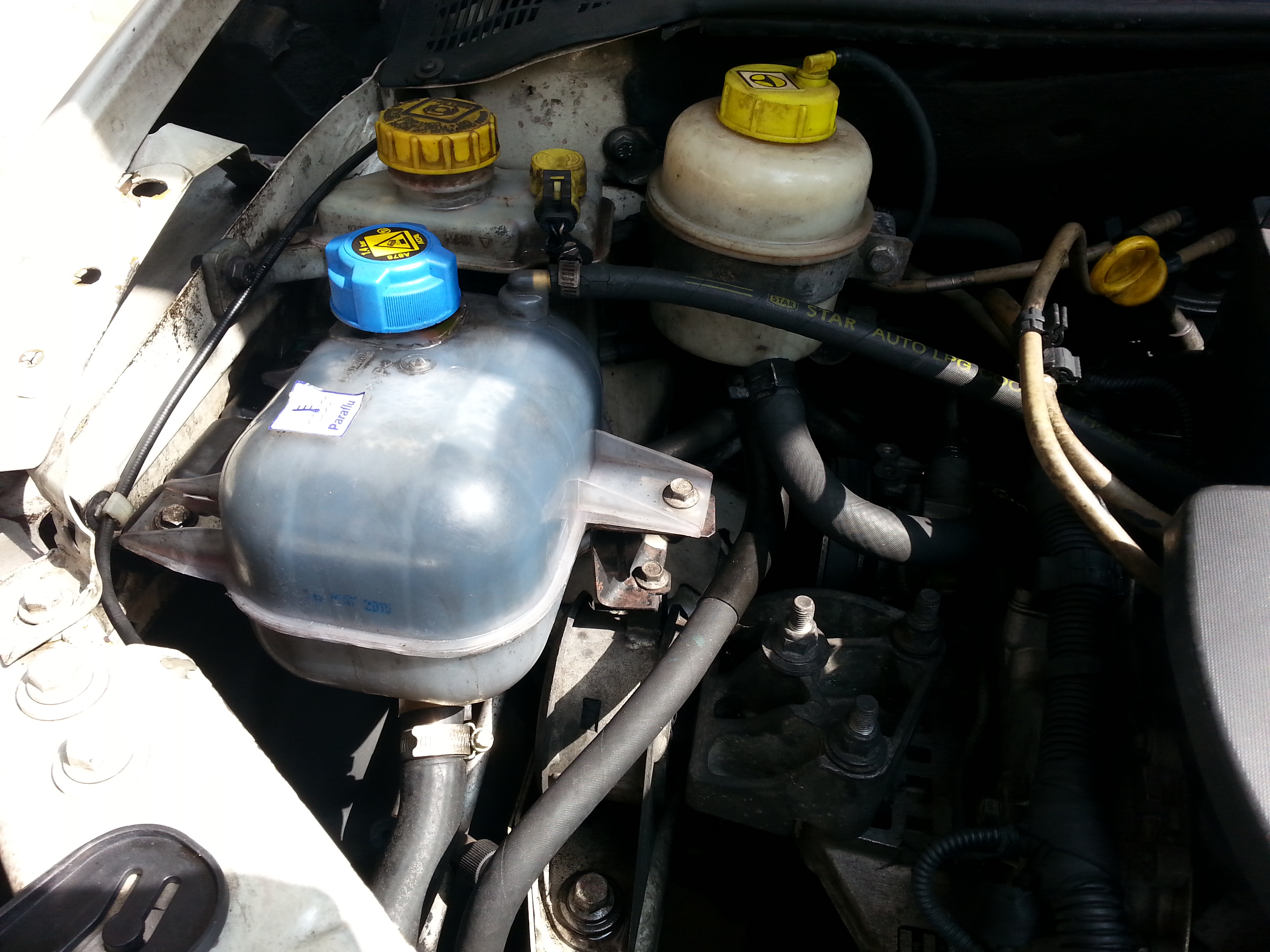

The container with blue cap is oil coolant and as you can see it turned black and it's because of engine oil back flow into the oil coolant container, when ever there is back flow there is so much of pressure built inside the oil container and insufficient oil pressure message is popped ad error message in the display. So what do u think is the faulty guy here? The Fiat guy is suggesting me to change the head or get the engine bore done. So who would be the faulty guy for making engine oil flow back into oil coolant? How can it be fixed? Thanks much in advance.

Hi again, :)
still looks like a cylinder Head Gasket fault,:(
easiest test;
get a cooling system pressure test done,
that will be uneffected by cylinder bore wear;)
until you can attest to a sound cooling system - there is no point going further(n)

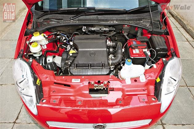

Also one question, why Fiat cars made in India have hydraulic assist steering system and not the electric power steering like EU cars have?
more akin to PALIO than punto I believe..,:confused:
Charlie
Even the classic Grande Punto in India use hydraulic system :confused:
New (latest 2015) version too.
(notice the power steering fluid tank in the picture, this is a GP with a starjet 1.4 16v)
