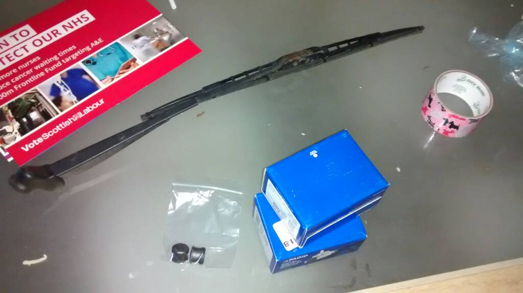

So here is what is still required as a bare minimum for driveability and ultimately an MOT:
Complete Brakes overhaul (got all parts on order, seems to have been completely dry of brake fluid for some time)
Gear linkage bushes replacement (got bushes)
Front wiper motor bolt conversion and cinq arm etc
And as far as bare minimum goes, I think that's it.

I can send you the parts I have again if that would be acceptable?
Yes everything but the calipers as you say :) it has been dry of brake fluid.
