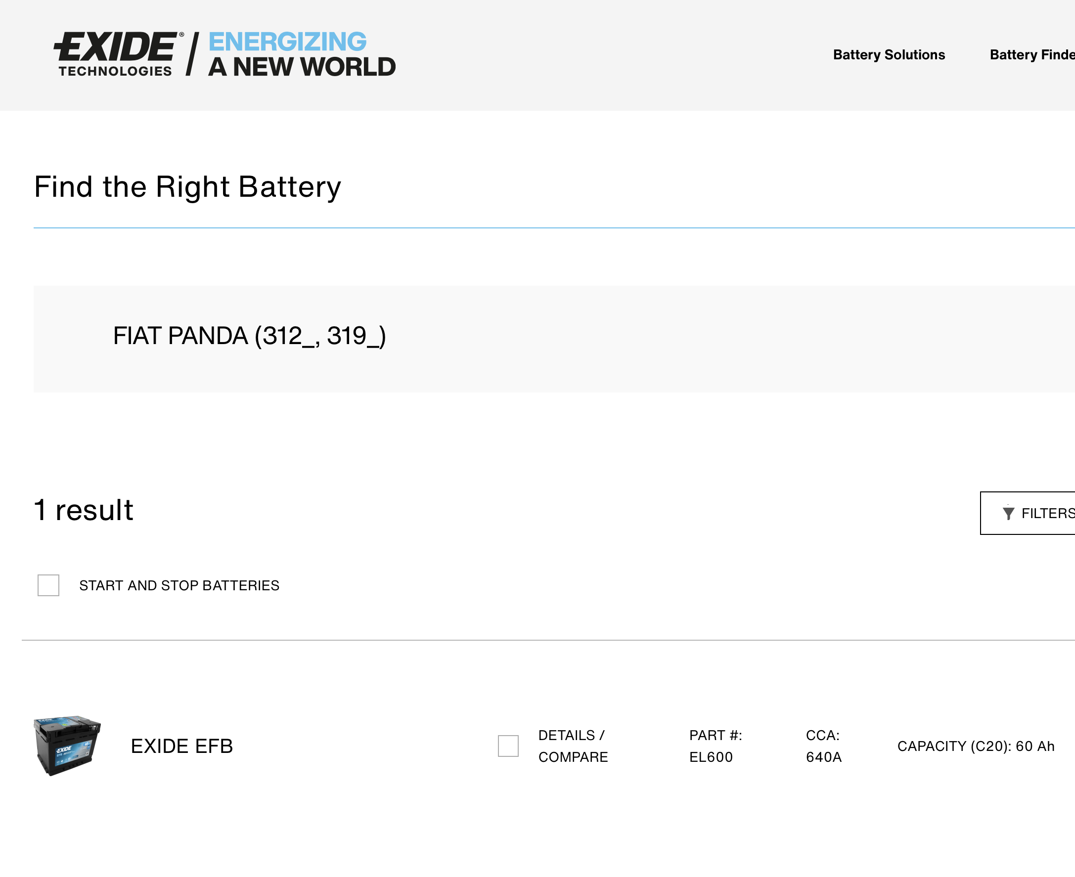

According to Exide's own website , the battery should be an EFB version.. (in which case, here's a new link to Tayna - https://www.tayna.co.uk/car-batteries/exide/el600/ )

Screenshot from https://www.exidegroup.com/eu/en/battery-finder/technical-specifications
I understand what you're saying, but also suggest Fiat wouldn't factory-fit a battery that wouldn't work? I assume all the electronics related to charging (including the voltage sensor connected to the battery that is part of the stop/start system) is all designed to work with the alternator battery and computer in the car.

According to Exide, the battery I provided a link to is an EFB version... https://www.exidegroup.com/eu/en/battery-finder/technical-specifications
Thanks, that is why I was trying to find out what the factory fiited? will stick with the EFB. ( Even Tanya failed to realise that the charge voltage was the key characteristic, rather that physically trying to match the physical size.) Thanks again.

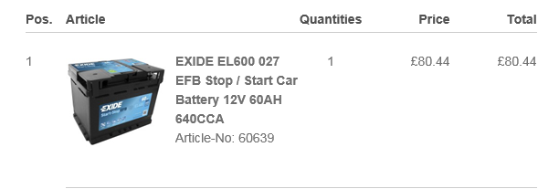

New battery from battery group, arrived next day. Fitted this morning, stop start now functional and touch wood no errors............. interesting the old battery at 12.62volts, ( and ceased to give faults the last few days) new at 12.51volts, so it is depth/capacity rather than voltage than critical, or the fact that whilst changing battery used a AGM ( with higher nominal voltage) to save the radio codes etc. See how it goes with another week of commuting
