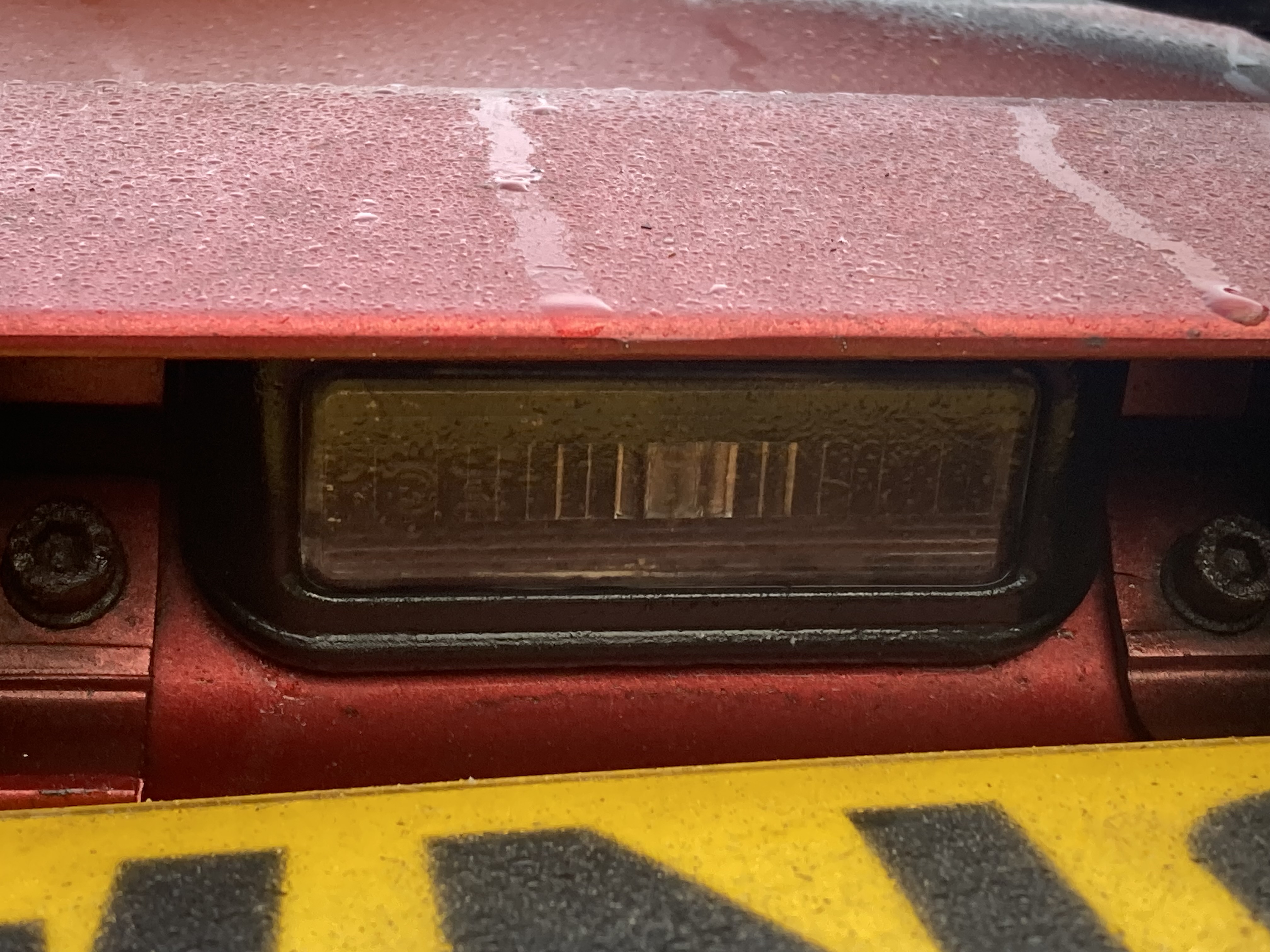

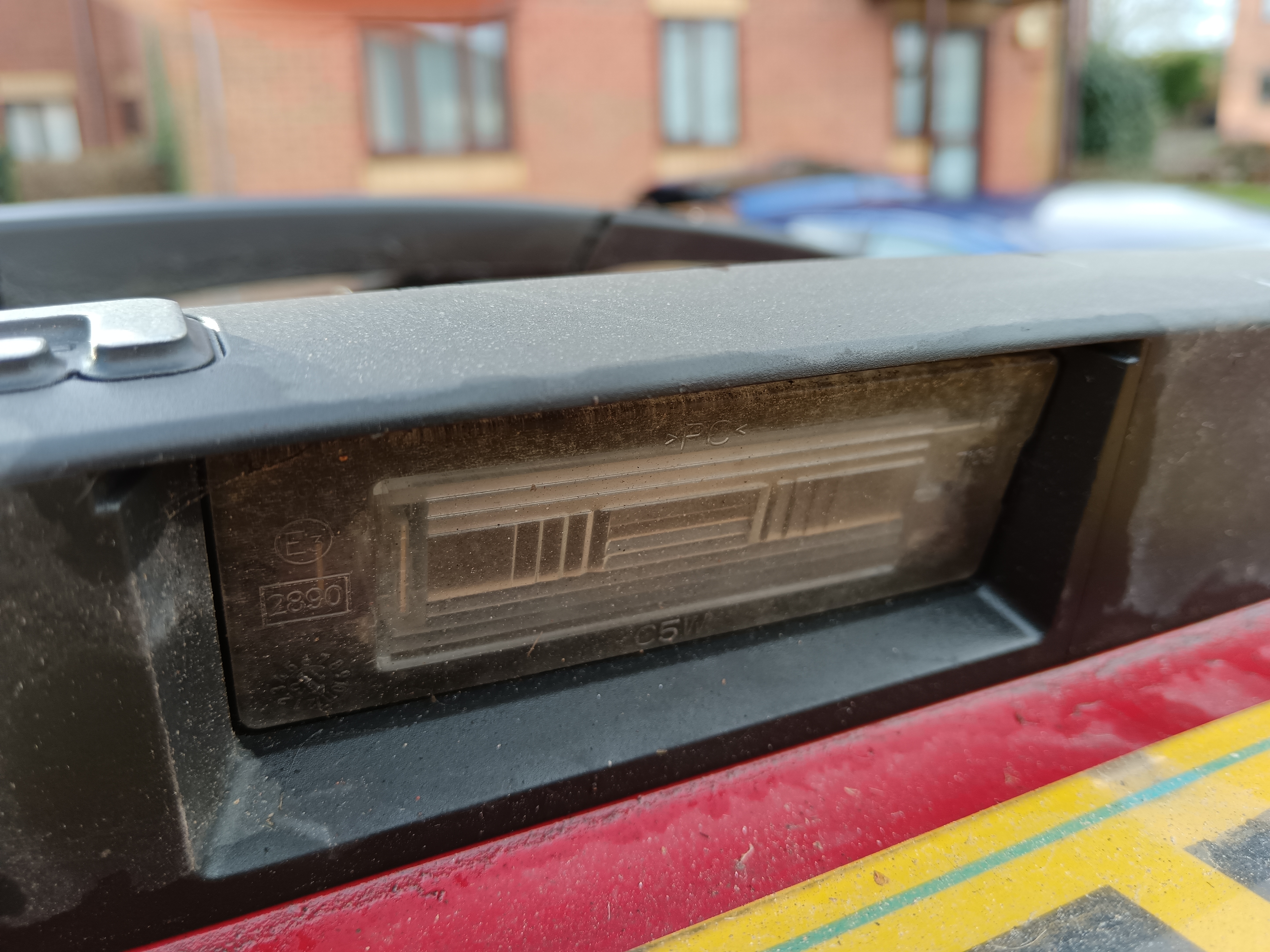

Hi new to owning 2007 Doblo. Trying to replace numberplate bulbs. Can slide bulb glass in black holder a little to left but struggling to then remove. Is there a trick I am missing to get them out of the hatchback door panel? Thanks for any help

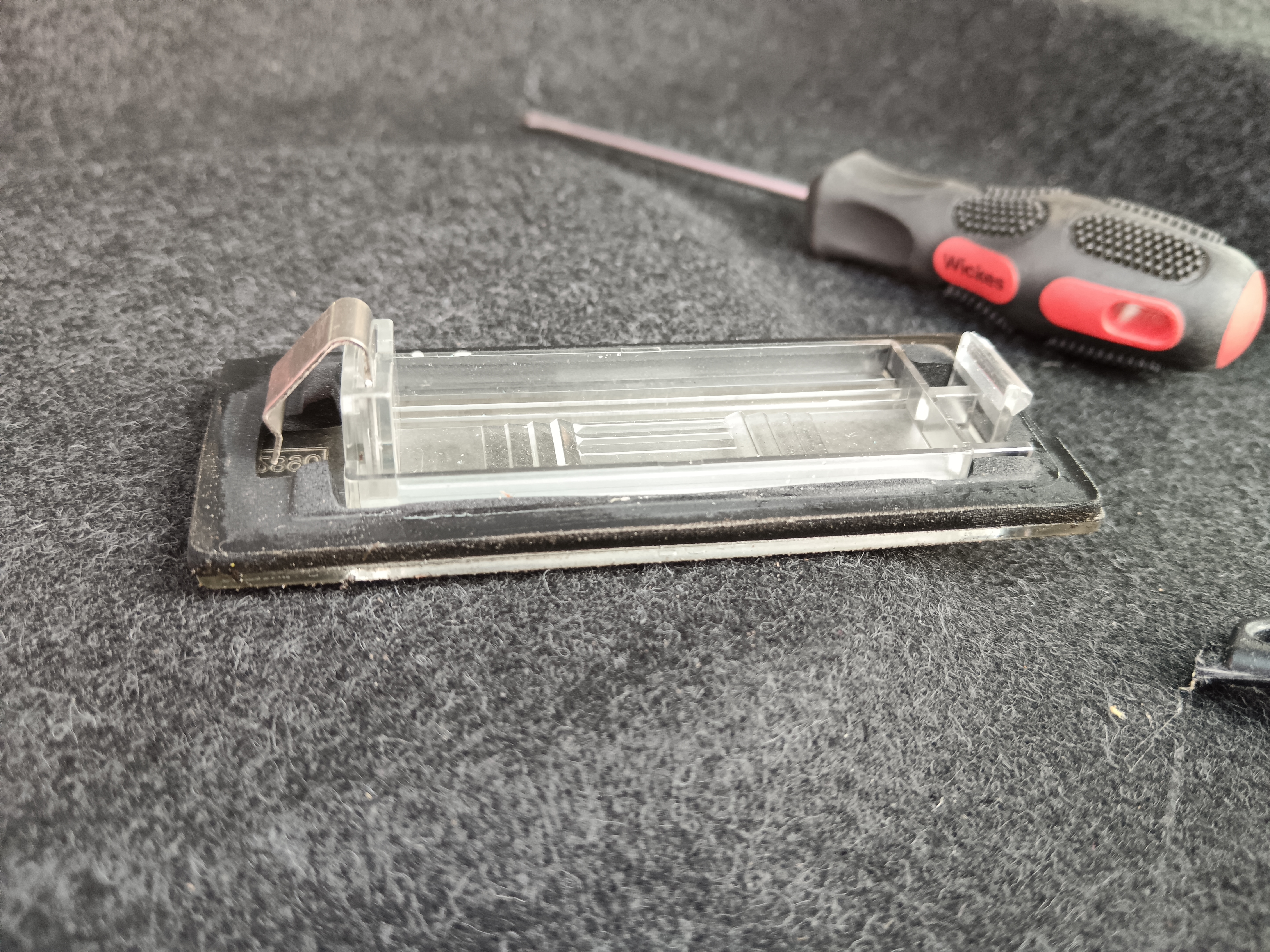

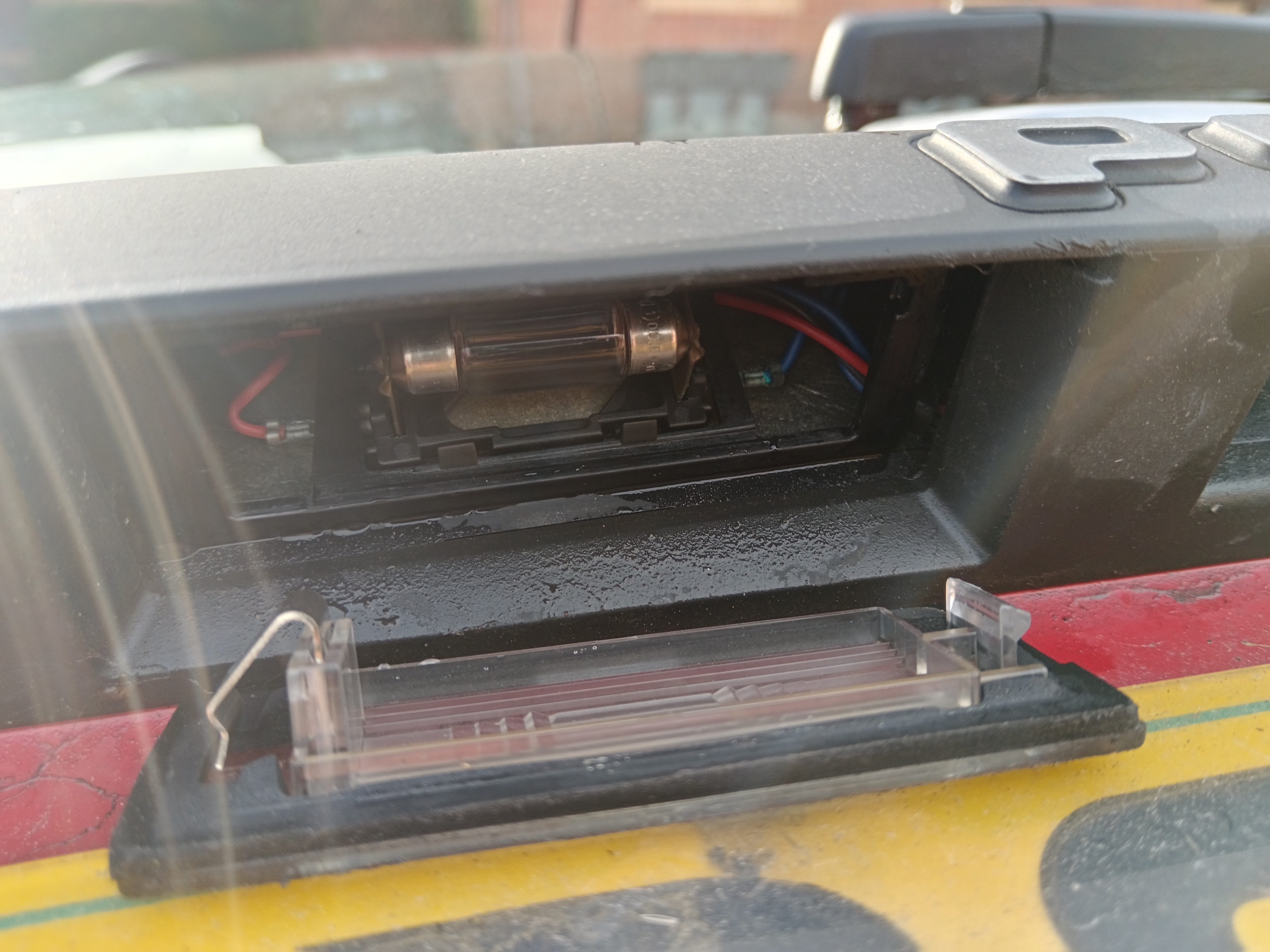

Here you go:
Images of the lamp assembly
Spring clip on the lens
So you need to lever the lens Across the Out
As that compresses the spring enough to let those little tabs

If you struggle, post a picture of your bulb holder 🙂
Hi, these photos are fantastic, thanks. It looks like the spring is on the left hand side not the right hand side. I have been trying to push on the right hand side to release the spring. My car is with my son at the moment but he is back today. I will have another go when he is back later today. Thanks a lot :)

The slot is only on one side,
So insert a flat screwdriver,
Twits it a little to compress the spring,
Then try and prise it out..
Hope it goes well 👍
Feel free to ask more.. Or post images of what you discover
