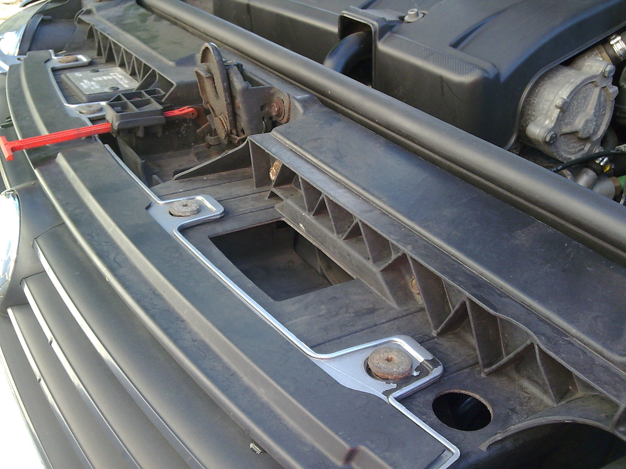

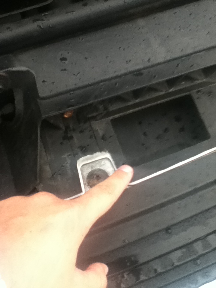

1- open your bonnet and have a loot at the rite side of the grill on the top
under my finger is the plastic bit, you have to look from the engine bay outwards to see it

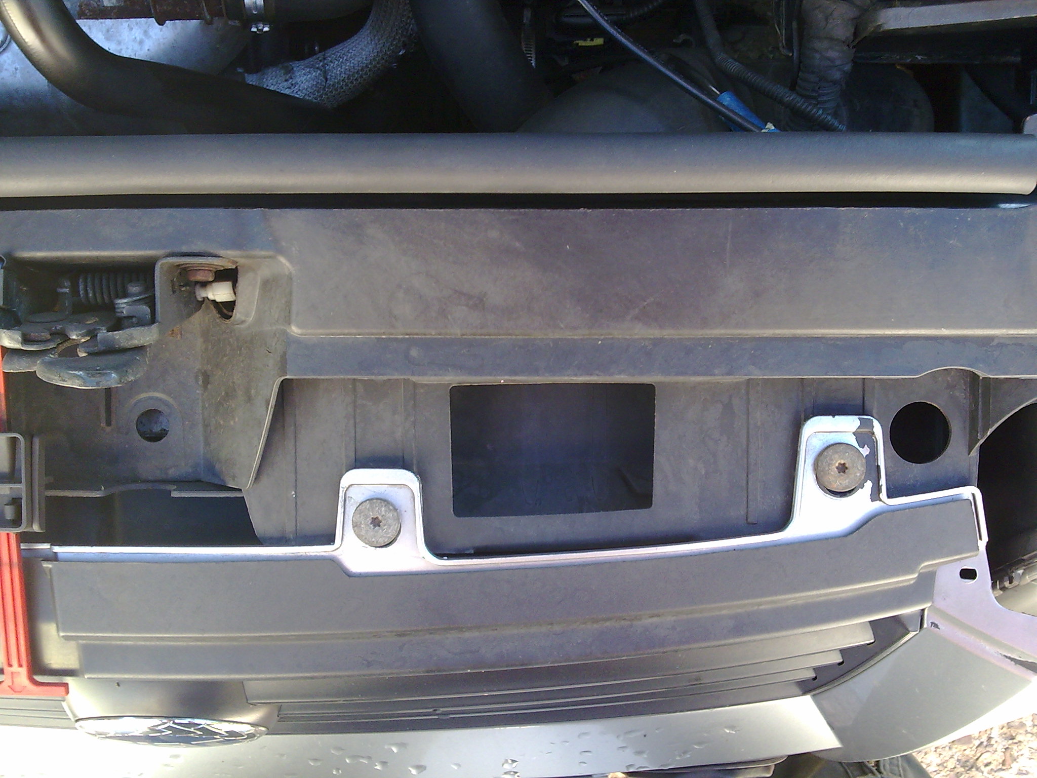

2- you notice the circle where the air goes into
3- you notice in-front of the circle whole you see a plastic plate, easiest way to see this is to look through the grill to find the circle BUT you wont be able to as there is that plastic plate there.

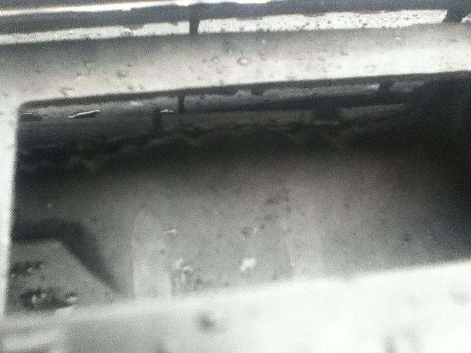

4- buy using a pair of snips and a small hack saw or anything you can cut it out.

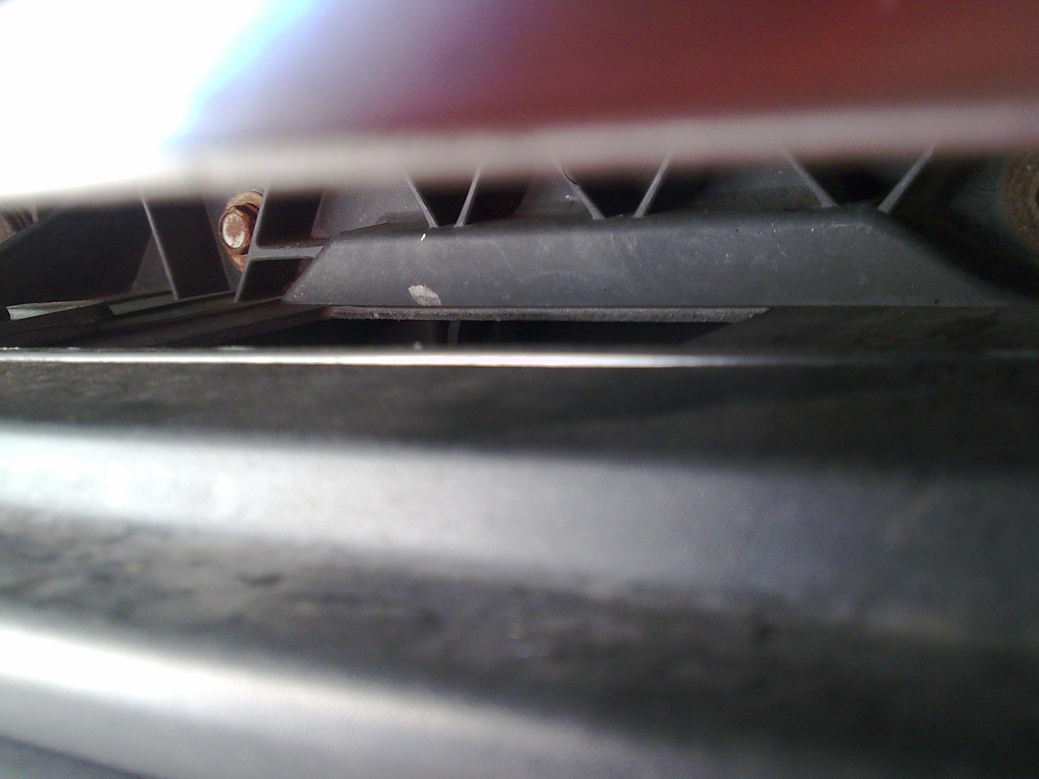

5- buy looking through your grill you will notice the hole you have just made and then there was no restrictor.
Sorry for the guide being rubbish but its always the simplest things that give you more power.
This has only been done on my JTD and not sure if it can be done on a petrol version.
