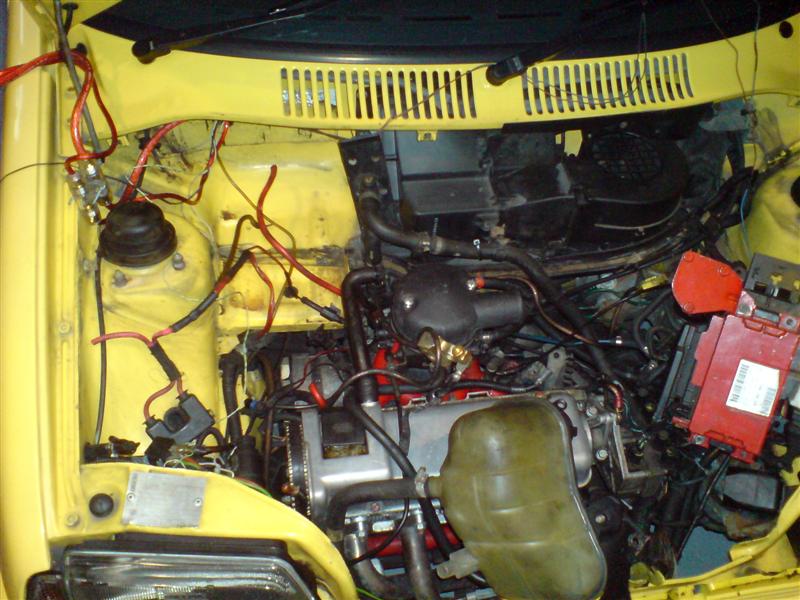

to use the standard mpi ecu, i'd have to had found an uncoded punto75 ecu or used the keys from a coded one. It would but suitable to running a standard engine, and my engine aint standard. The standard ecu is mappable, but not easily and therefore expensive to do. Ultimately it would need bodging to allow me to run boost eventually. And would def need mapping again after that.
Megasquirt on the other, much better ECU. A lot more features, like boost control, water injection, dual tables, knock sensor etc etc and i have a wideband lambda controller to help it out.
Other plans, new rear radius arms and powerflex bushes, new front wishbones, UT front calipers, GT rear calipers, and any other bits i spot on the way!
Interiror is not staying stripped.
I wouldnt use welding wire if I were you...Its not rated for continuous duty at high current i understand.
A typical Welder will run at 50-80% duty cycle at 130A ish...not 100% Duty Cycle at that current.....
ive ordered battery wire.
welding wire would be fine though, it wouldnt be under continous load - most load is when starting the car, and that'd be it.
