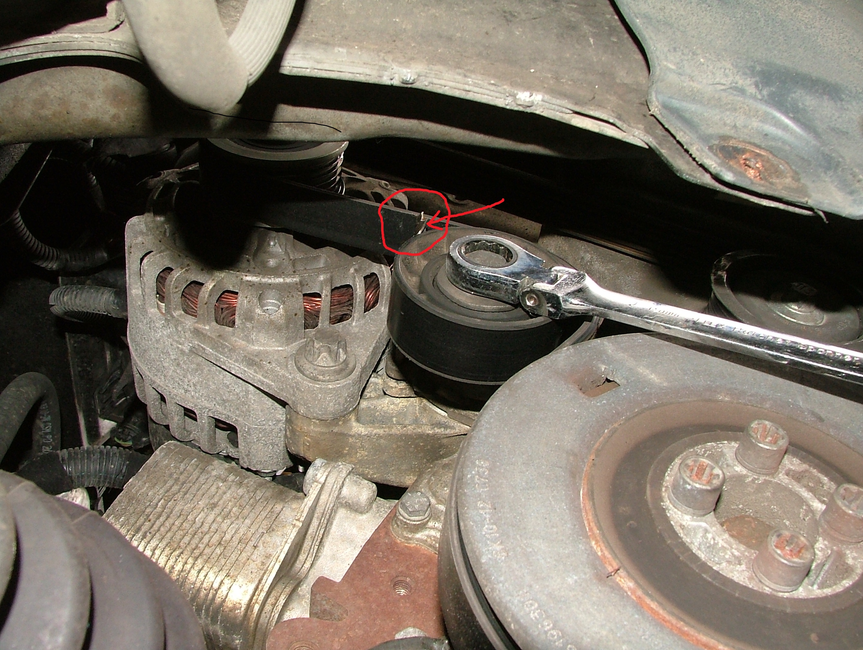

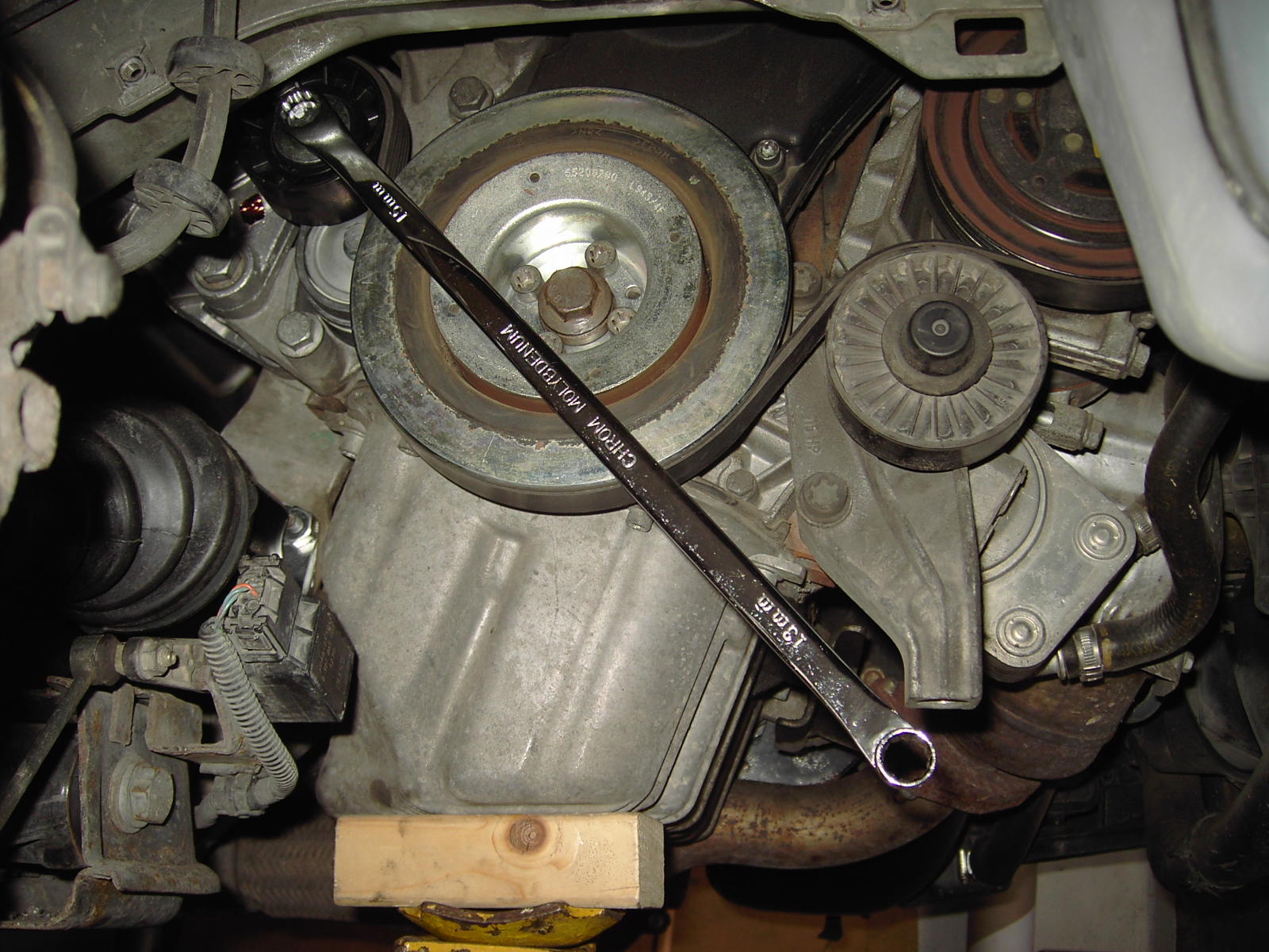

Looks bloody tight, I'm guessing that after I take drivers wheel off and plastic covers it becomes easier to do?
You need a long 15mm spanner to hold back the auxiliary belt tensioner while removing/replacing the belt.
Belt was £15.30 from euro car parts using xmas as discount code, didn't lock it, used torque wrench and held it in place as I put belt on.
