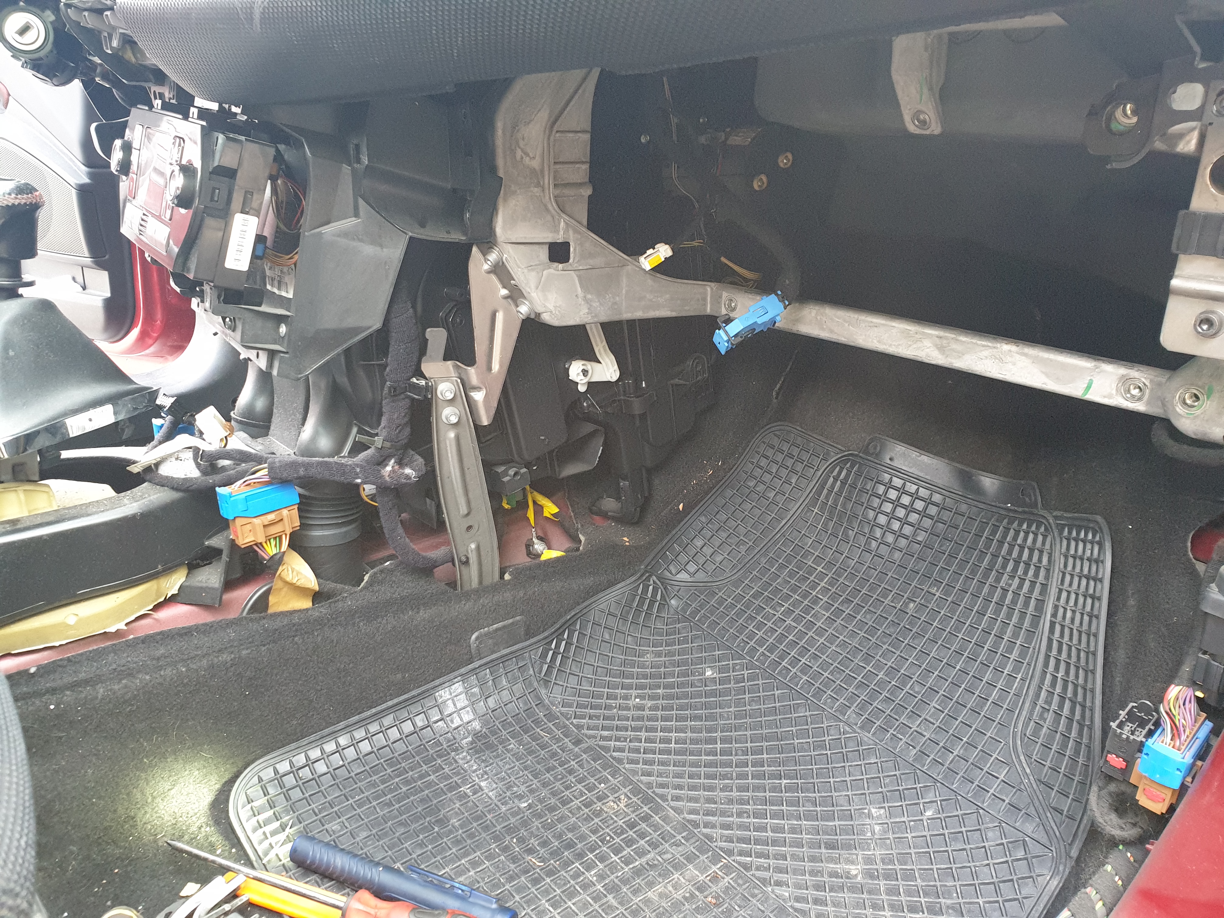

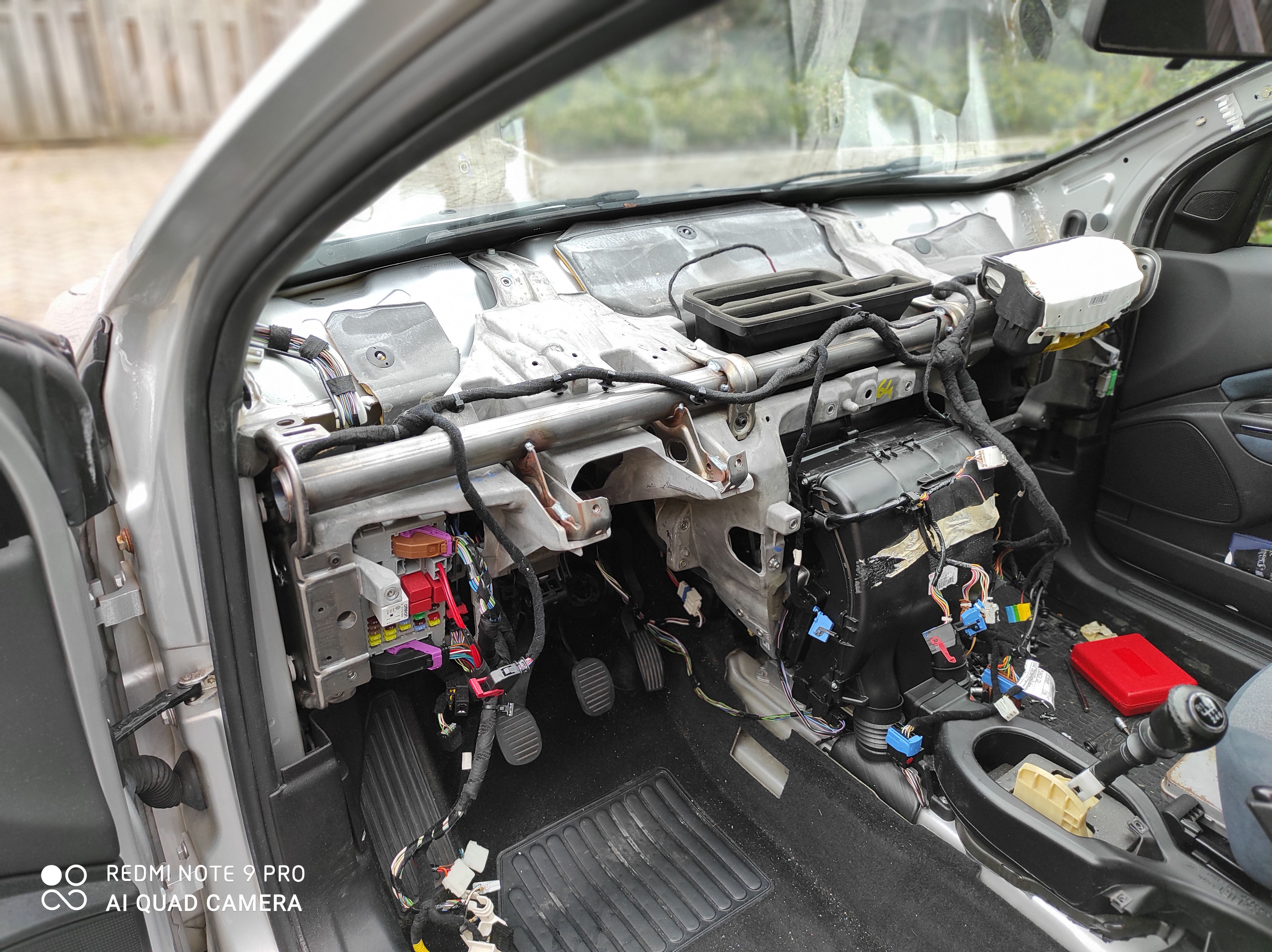

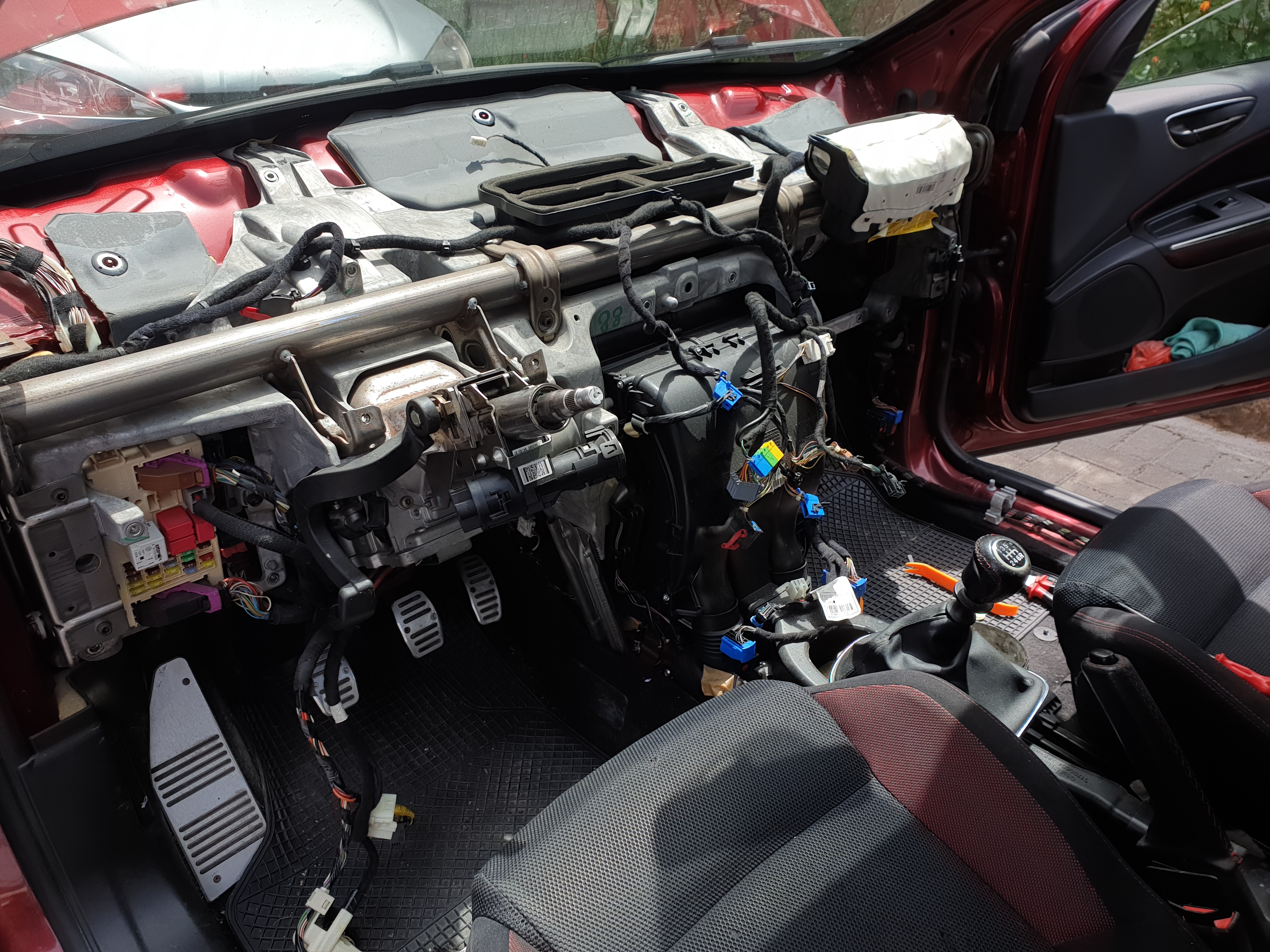

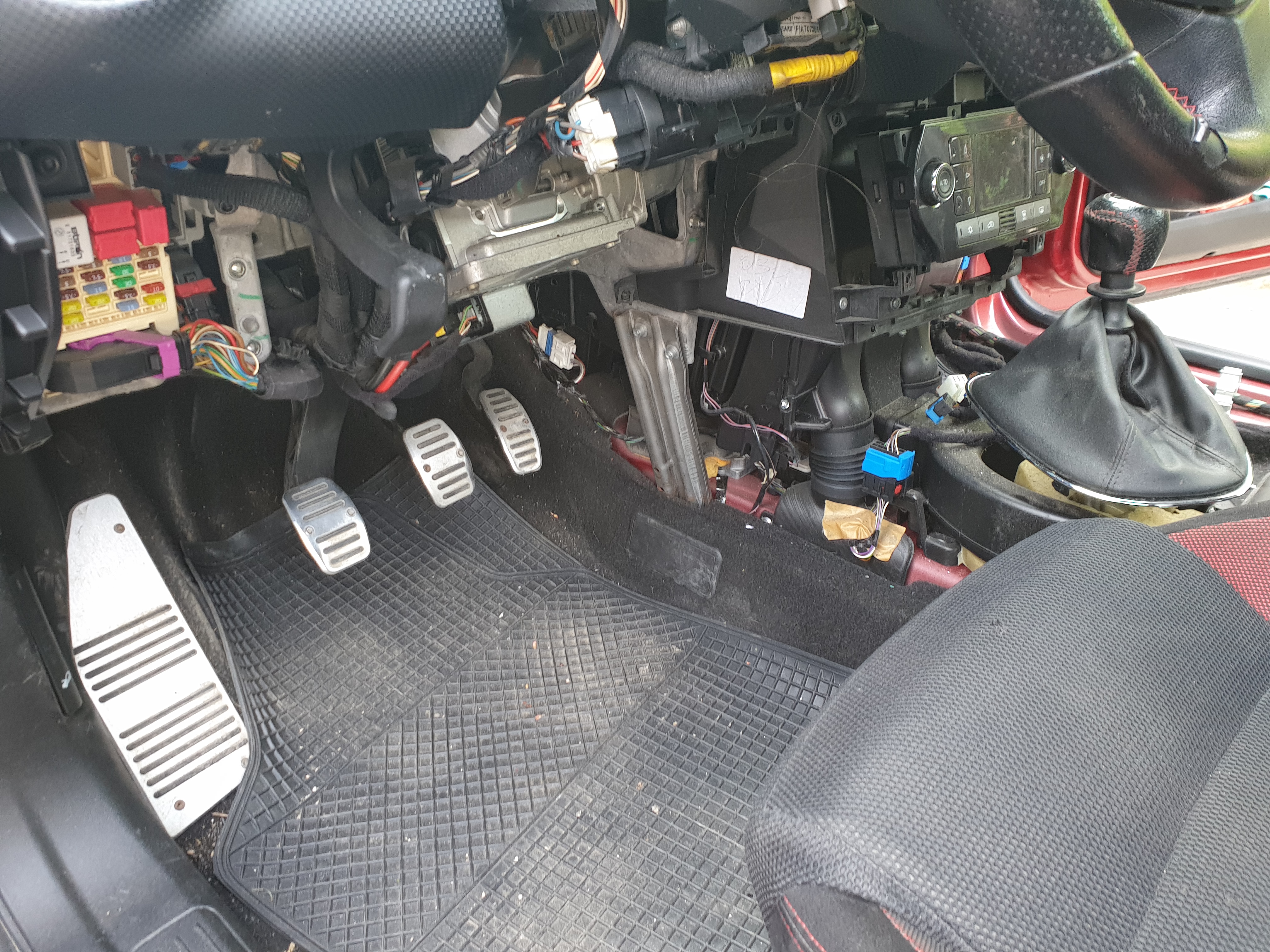

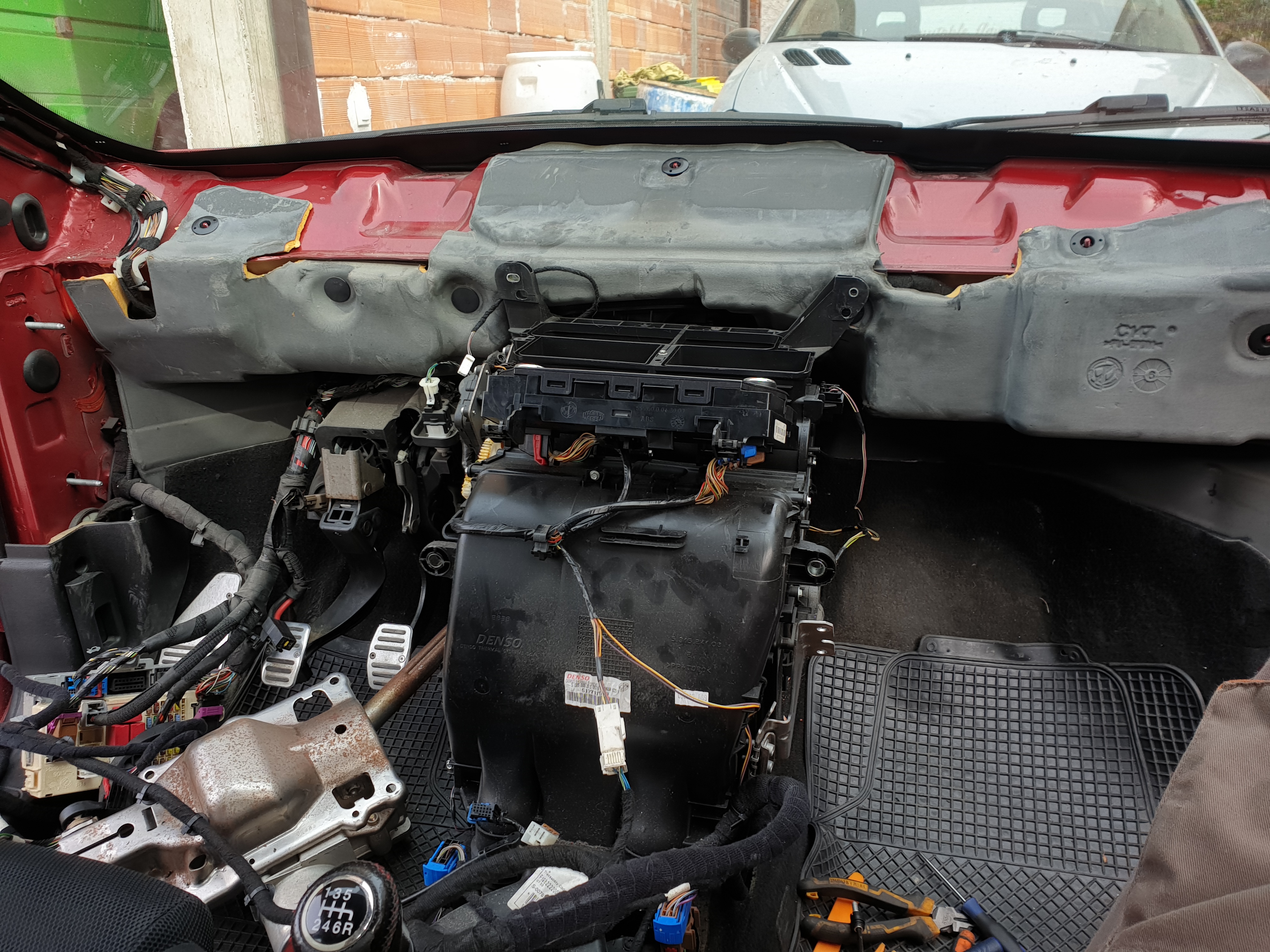

Hello guys i have Fiat Bravo Sport 1.9 jTDm 16v 150hp. The problem that i have that on the driver side the (left side) it blows only hot air but on my passenger side it can be tuned how do you want. So today i completely removed the dashboard and tommorow ill see where the problem is. I'll put some pics from the work and inform you guys tommorow whit new updates.
Here is some pics that i made working on my Bravo the only thing you need the most is patience.

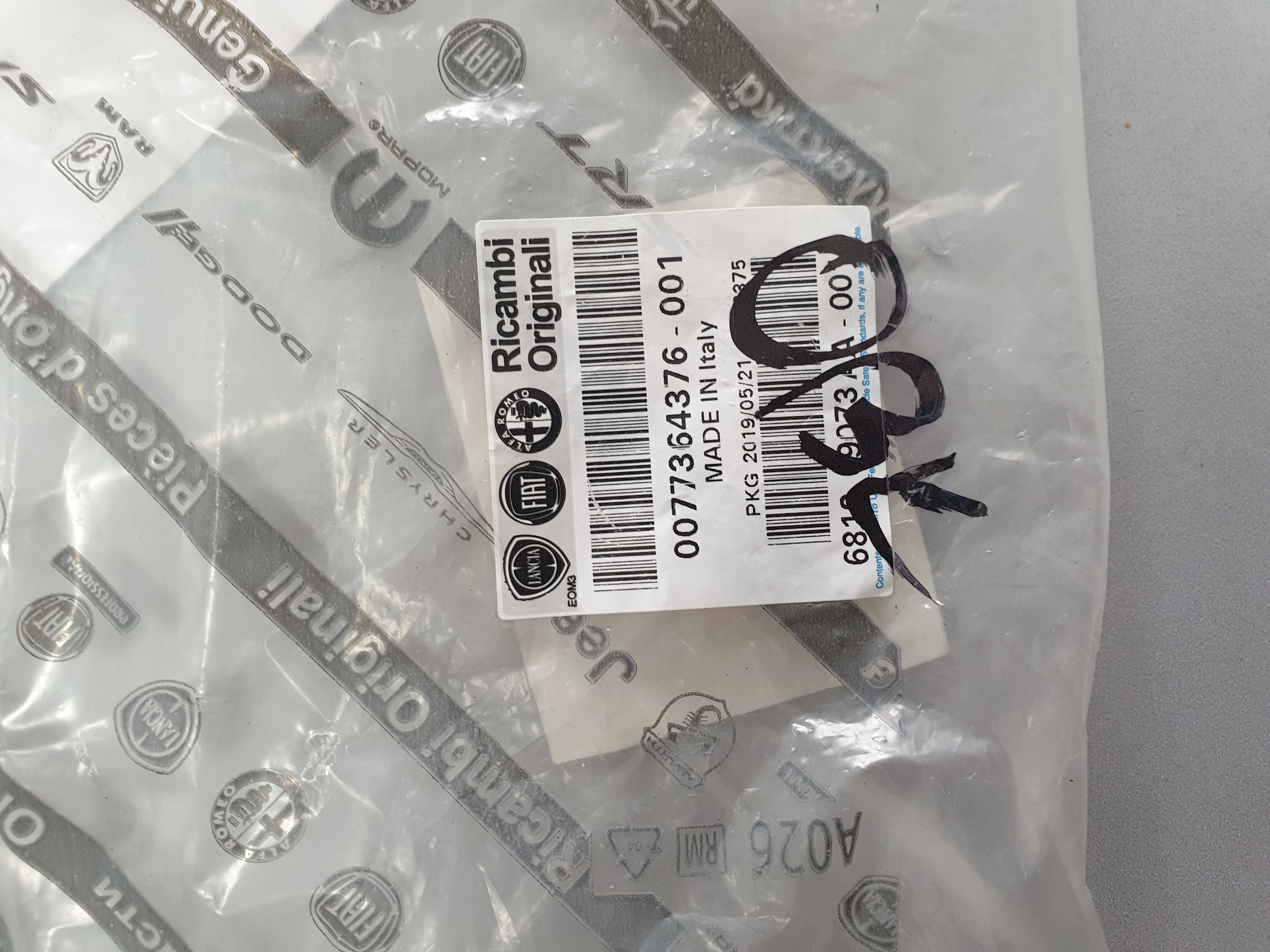

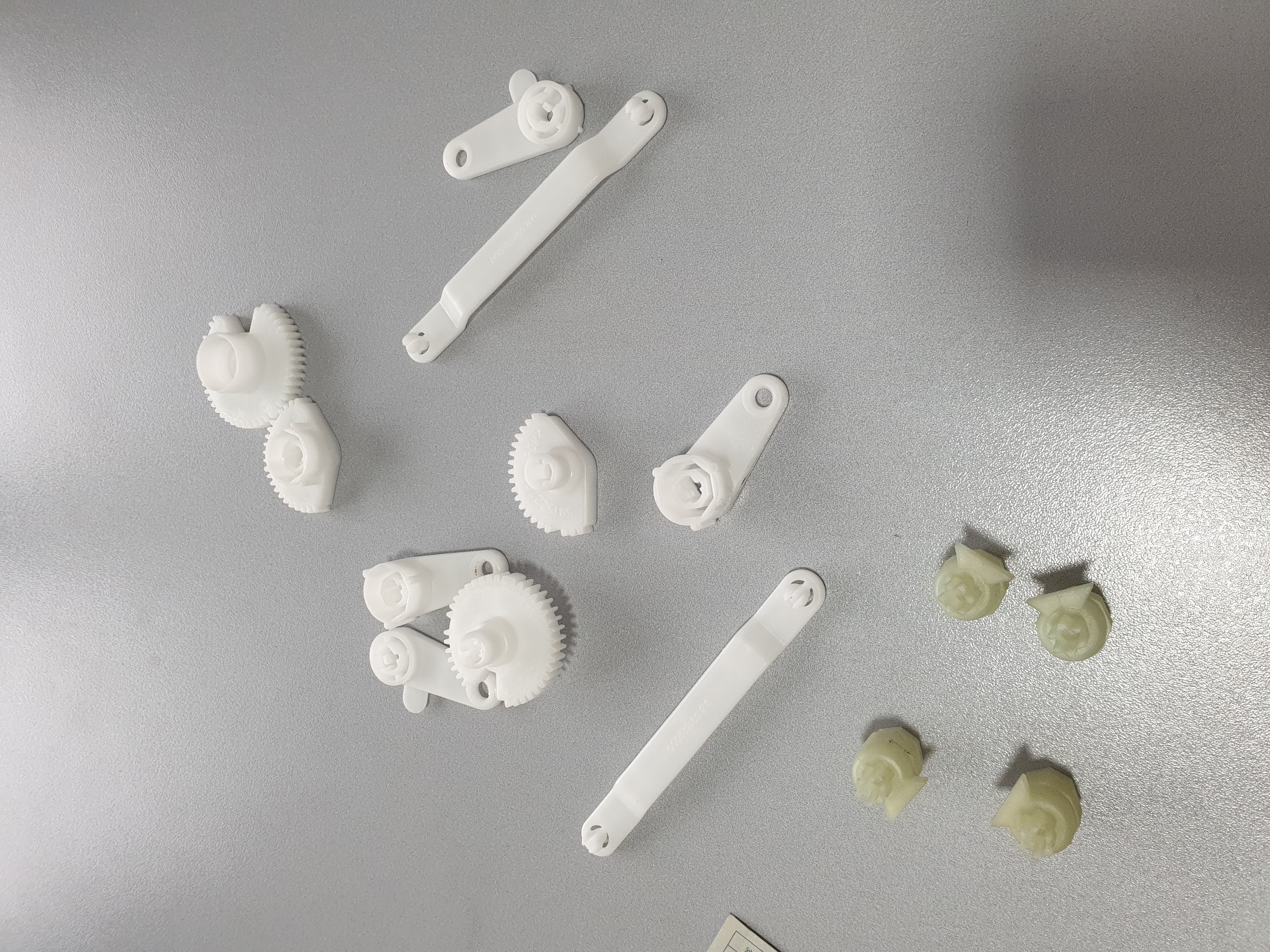

Sry all the motors were in great condition so i only got the full pack plastic peaces and replaced it. Ill upload pics from the parts but i cant tell you for sure the numebrs of the motors

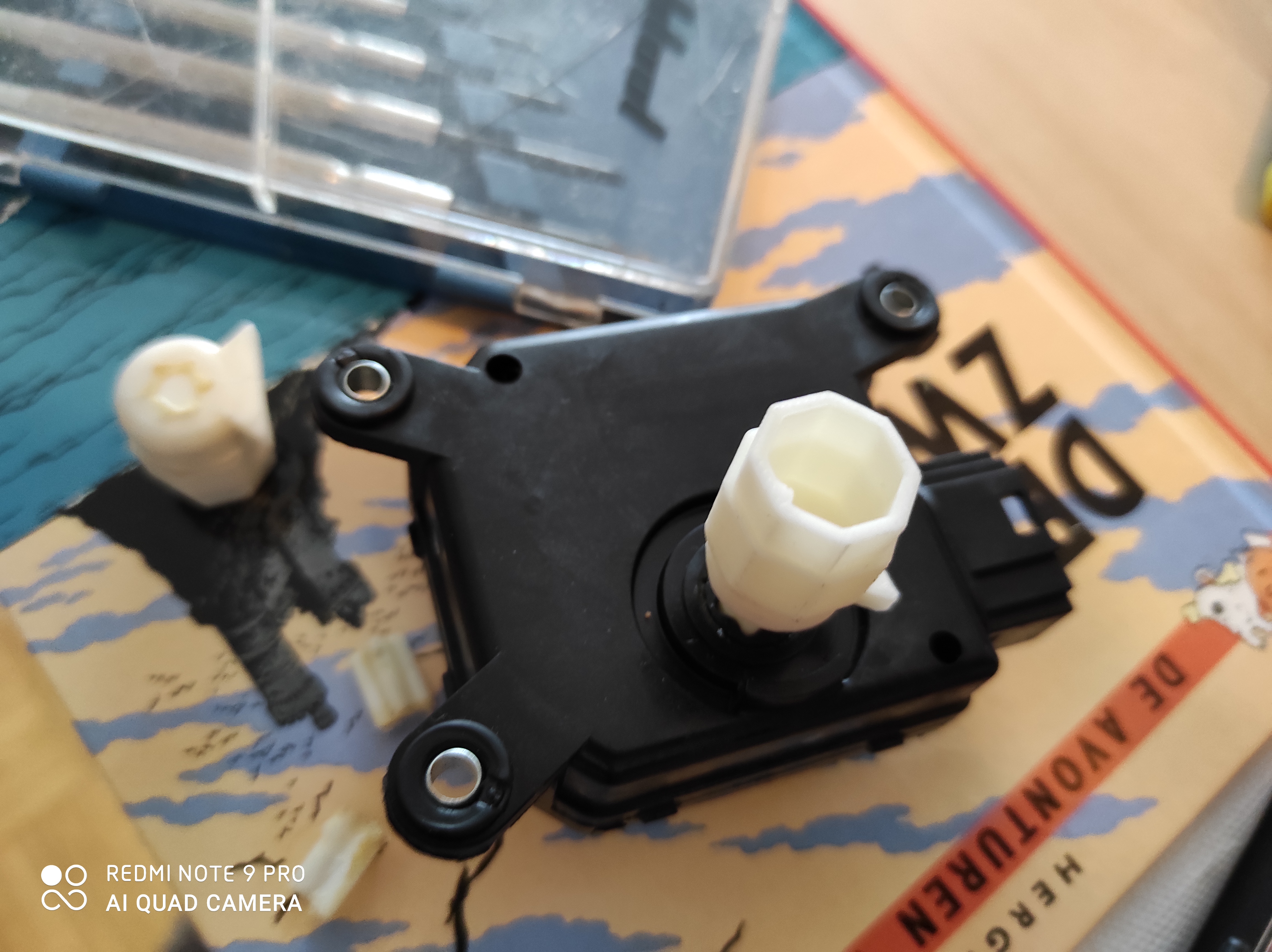

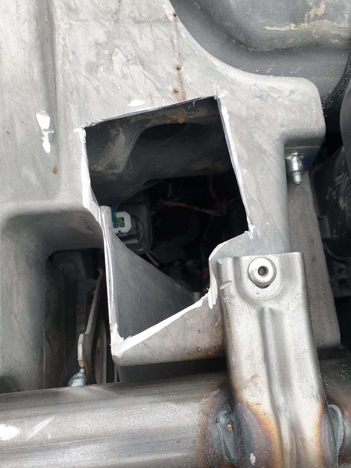

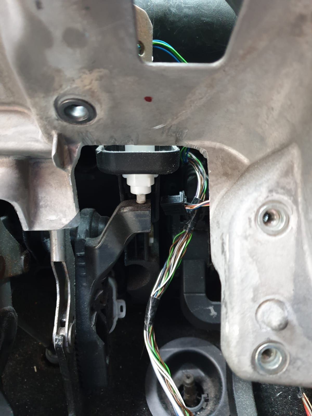

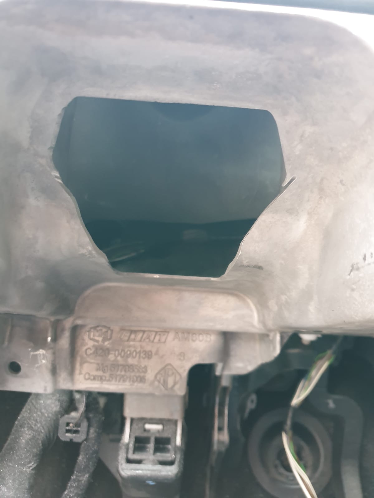

So... We tried this on a LHD Bravo. Bought three cogs of E-Bay. They are 3D printed instead of glued like the original ones from FIAT.
Took us (my son and me) the better part of four days. We removed the complete dash and steering and even then access on the three motors on the leftside was impossible. To get the metal under the dash away would require removing the doors as well we thought, so we carefully (as not to struturally damage it) made a few holes in the metal part.
Then changed the cogs (all three broken in two) on the leftside and checked the one on the rightside (already replaced by the previous owner, accessible in minutes) which was in great shape.
Put everything back together electrically and did the self test (auto and mono simultaniously within second from turning the key to MAR). No more faults:D
Then connected it to MES to clear all old faults.
According to the chatgestation it needs a secondhand compressor now before it can be recharged, but we hope the daughter and son in law are happy now.
