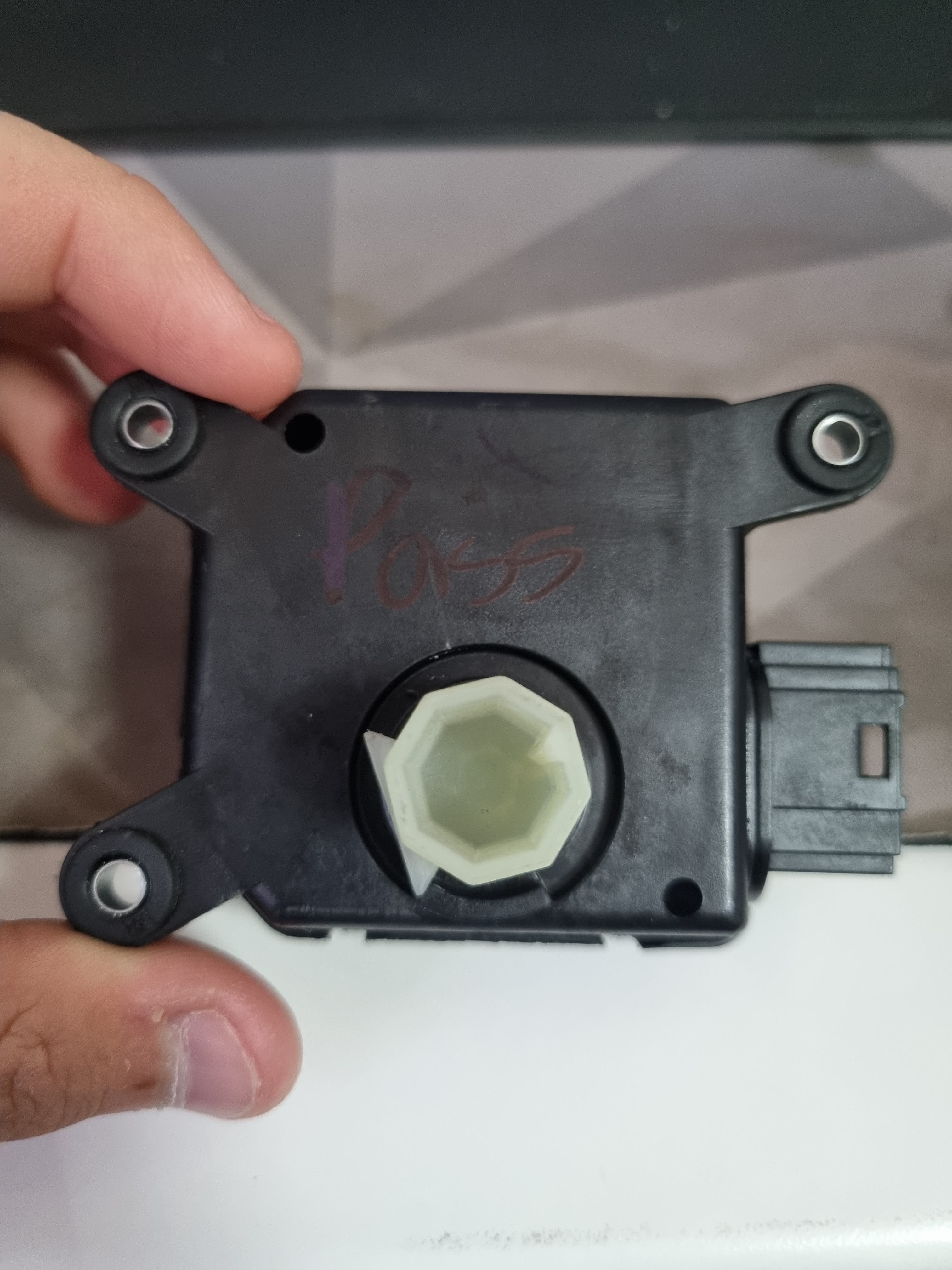

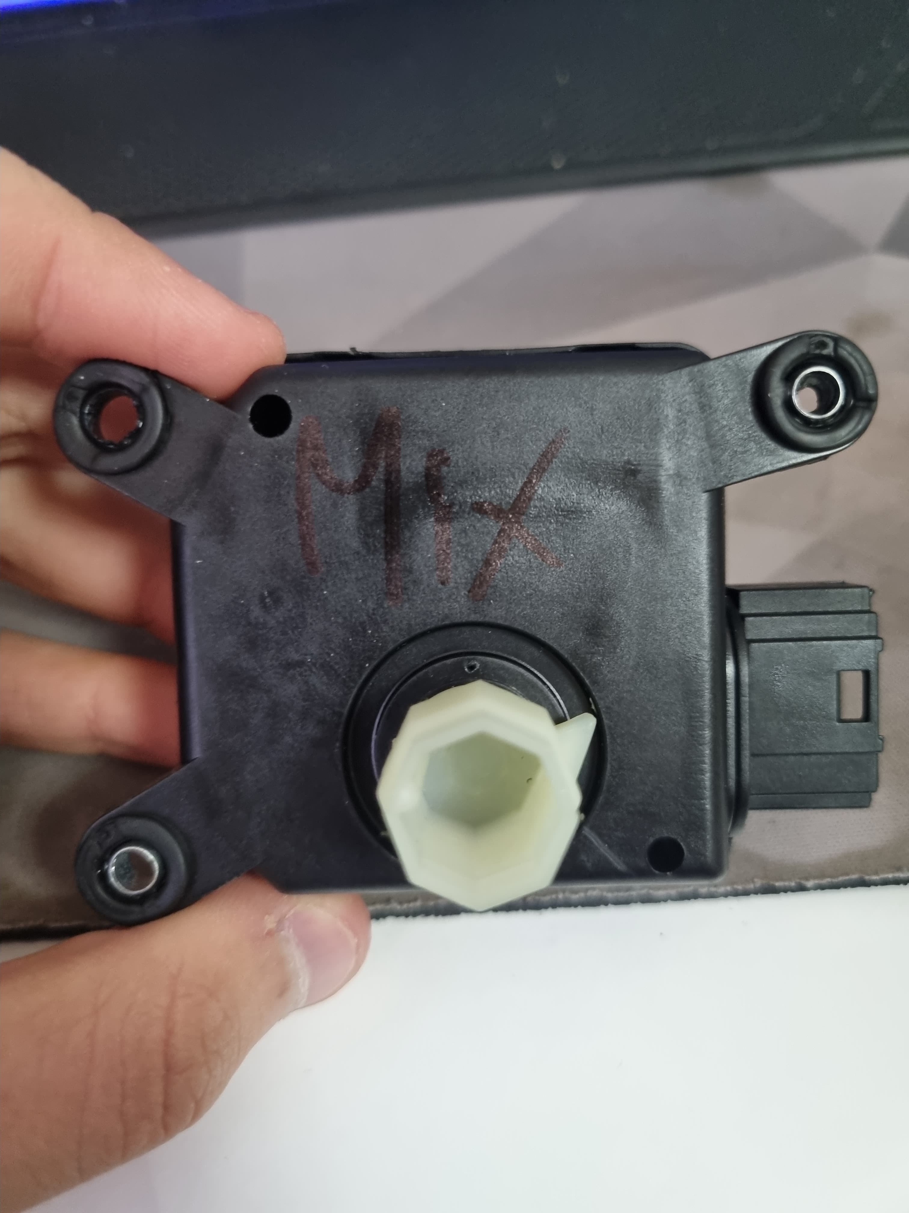

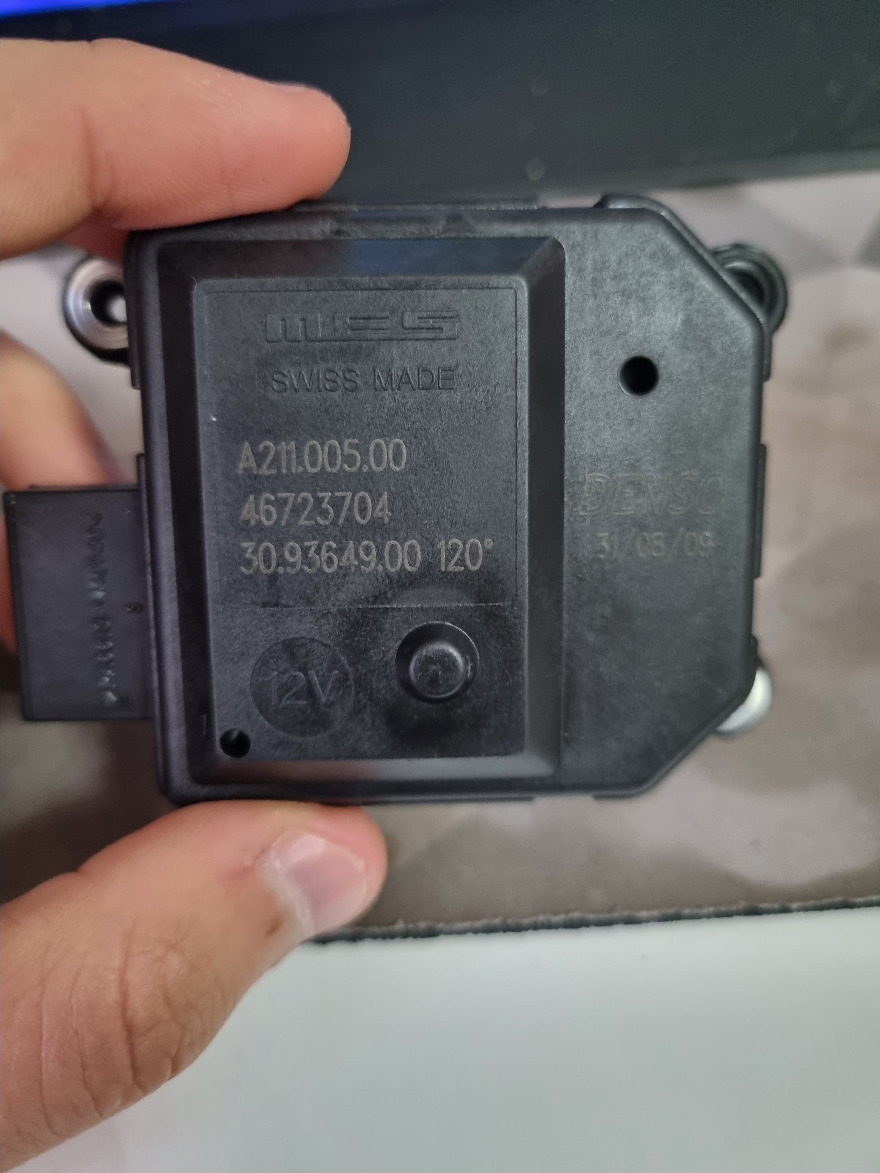

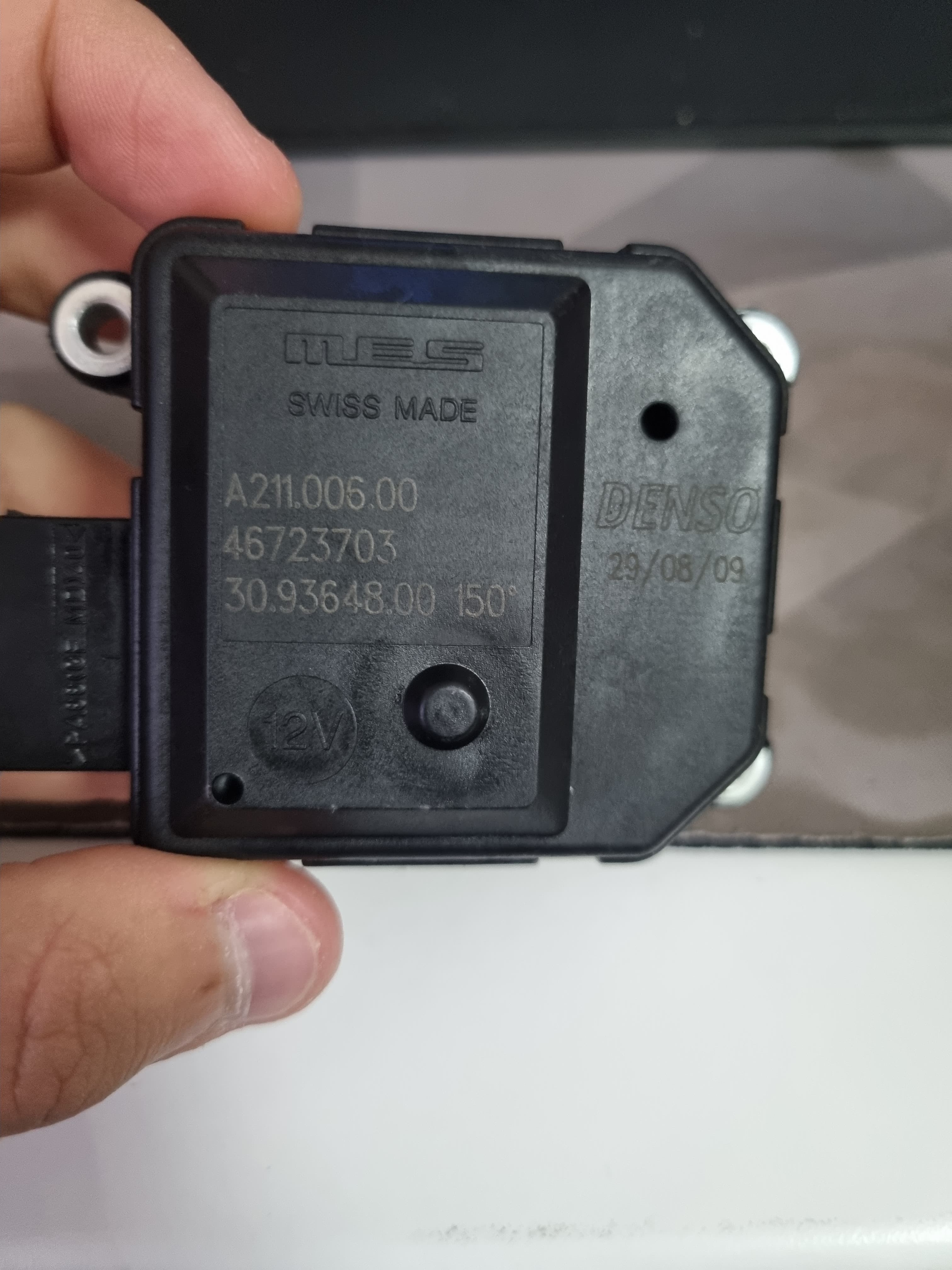

Hello, I've got a problem. I replaced the actuators inside the motors of the passenger motor and mixing motor, but they still don't work. I decided to check it with Multiecuscan, and it turns out they both show outrageous numbers such as 130%. I decided to take out the motors but leave them plugged in and tried to control them with Multiecuscan. The chest/foot vent motor worked fine and rotated the actuator, however the passenger motor and mixing motor do not seem to rotate the actuator. I would like to add that when I force the motors to re-calibrate through Multiecuscan they do indeed rotate and the passenger motor works, but when I switch off the car and switch it back on again the whole motor gets reset again and it doesn't wanna work. Has anyone got any idea why this might happen? Do I have to get new motors or is there just something wrong? I attached the pictures of the motors beneath - there's nothing wrong on the outside and when taken apart, it seems like there's nothing wrong on the inside too?
