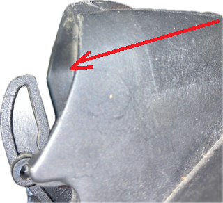

Anyway, back to the job at hand. It is just about possible to twist unlock your switch, or twist engage it, with one hand. My hands are big but luckily I have long fingers. However, never force it, just be patient and reposition it or yourself slightly and try again. If you get it into the exactly correct start position it will rotate and click in position quite easily. If not quite in position or slightly out of line it can be remarkably obstinate! The switch goes into place in the direction of the red arrow in the pic below i.e. from the front of the car with switch plunger headed towards the back i.e. towards that lever which is an extension at the top of the pedal. If that lever is allowed to go too far forward (which it can't normally do unless forced, or if the pedal is part disconnected and yanked upward) then that lever extension can easily cause damage by punching back the plunger and switch right the way through an inadvertently enlarged hole!

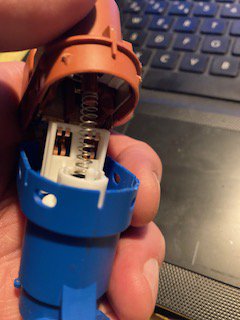

So what's inside the switch and could I get the plunger to spring out further and calibrate it somehow so it works as advertised? The answer seems to have been yes I could (because I did!)

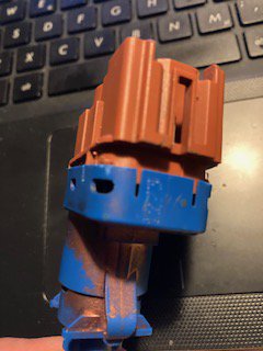

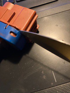

I opened the switch very carefully by using the edge of a thin sharp knife. The switch is not glued - it is a clever click fit, but as it is all plastic and is closed against a spring, you need to tease open the six click nipples without breaking anything otherwise you'll never get it to close properly afterwards.
Here are some pics of how I teased it open:

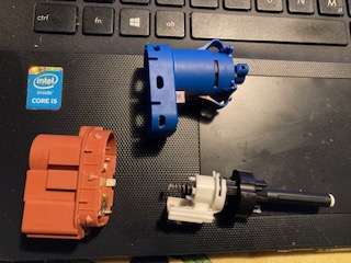

Careful not to let it all pop open or lose the spring before you can see how it all fits together. It isn't overly complicated but it is always best to keep the parts in the right order in respect to one another!

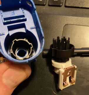

Here is a pic of the main parts separated and one of the plunger showing a kind of saw tooth ratchet:
That ratchet reveals part of the secret of how the plunger can be calibrated according to the actual gap it finds between it and the pedal lever extension when you are fitting it from new or refitting it after dismantling as I have done. That black collar around the plunger (adjacent to the white section in the switch) contains another part of the secret. The collar has guide rail prongs or splines that match some grooves inside another black part left within the blue housing. Suffice to say that the part inside the blue housing rotates 30 degrees and two lugs on it protrude outside the housing to provide´the "click" when the switch engages into position after twisting. And evidently part of that locking process also rotates the splined collar which in turn engages and locks along the ratchet teeth on the plunger!
This now gives some meaning to the advice I have read in another thread somewhere that before refitting the switch, you make sure you hold the brake pedal depressed as far as possible. That way when you first offer the plunger through the hole, and if you have extended it out a bit (or a lot!) from where you found it before dismantling, it will not get pressed back in too far by the pedal lever. If you forget to depress the pedal until after the switch is rotated and clicked in position, the plunger will probably be locked too short, and you might well end up with brake lights on all the time. The idea if you have held the brake pedal down when you rotate the switch 30 degrees to lock it in position, is that the ratcheted plunger will also be locked in a supposedly perfectly calibrated position. That means it will just touch the top pedal lever extension part when the pedal is depressed, and when the pedal is allowed up, there will be definite depression in the plunger of what I estimate to be around 5mm or so, where when I started I seemed to have no noticeable movement until I took the switch out of position and pressed in what little remained of the protruding plunger with my finger.
