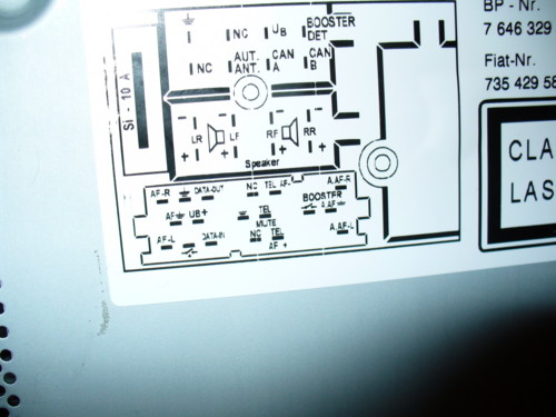

I appreciate this is an old thread, but my NON-MP3 compatible unit HAS the connections on the yellow ISO to accept a cable and it works fine.
My cars a march 2007 multijet, without the MP3 logo on the front and totally incompatible with MP3 cds (I know, I've tried countless ways of burning them with no luck!!!)
I'd suggest pulling the unit out and having a look on the rear, if it's got this label attached
then you're in luck.
I cannibalised the connectors and lead from a blue mini iso connector lead purchased from Ebay and it clipped straight into the existing yellow plug, it was very easy, cost me £9.
Hope this helps.

Call me Mr Thicko Thicky but where exactly do I plug my two mini connectors that I have removed from the blue iso connector into the yellow connector:confused:???? The two mini conncetors are attached to the 3.5mm jack by the way.
Is it AF-R and AF-L??
If you could circle them on the image or something that would be great!! My local ICE place wanted to charge me £55 for doing this!!!!
