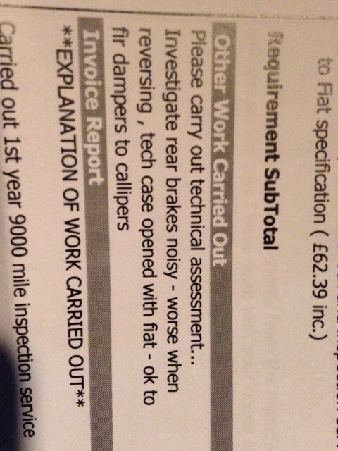

Here is the file the service technician gave me. It's in Italian, of course, but there's a part number at the bottom for the damper kit which should help anyone having trouble getting the dealers to order it.
