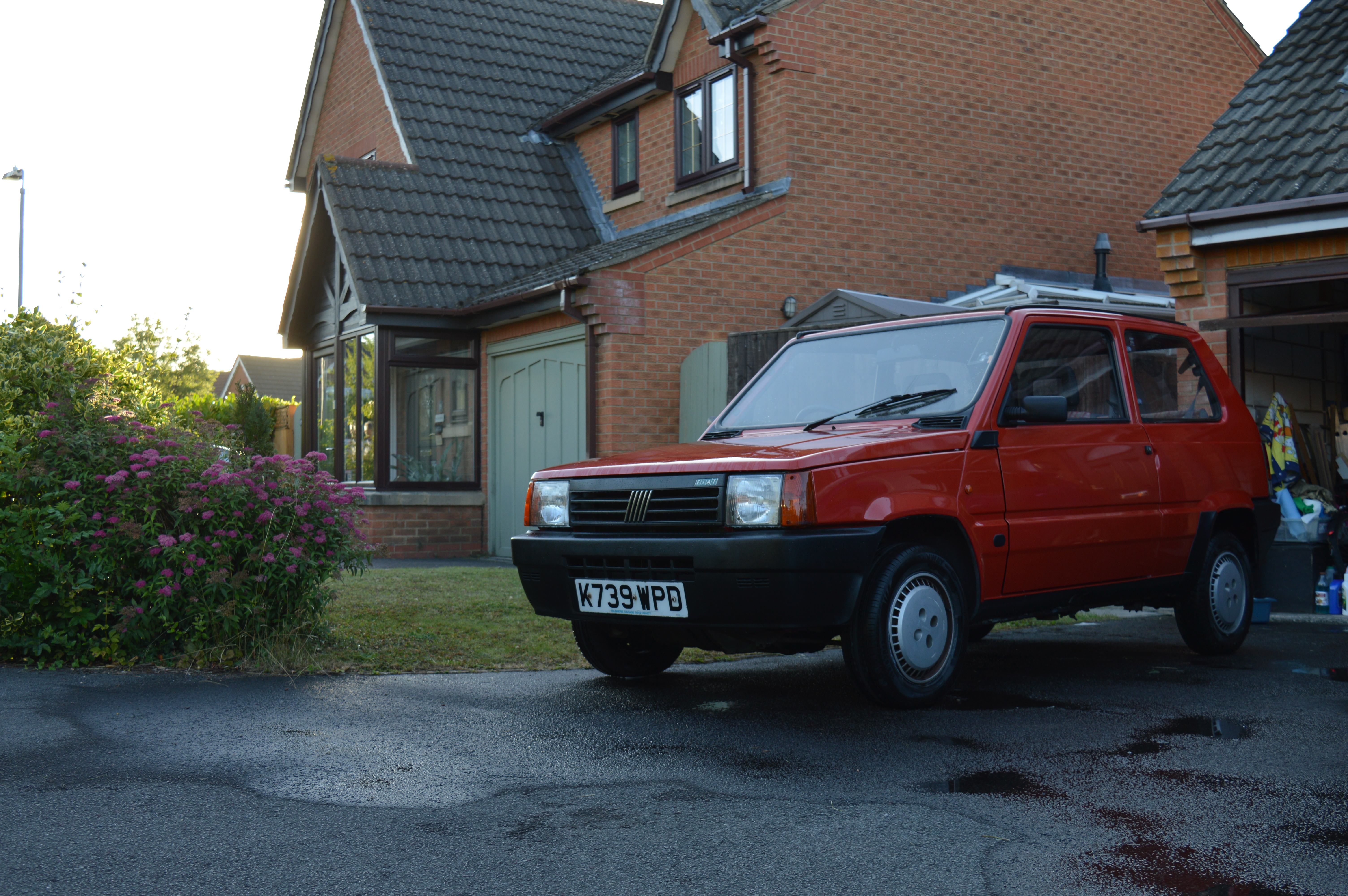

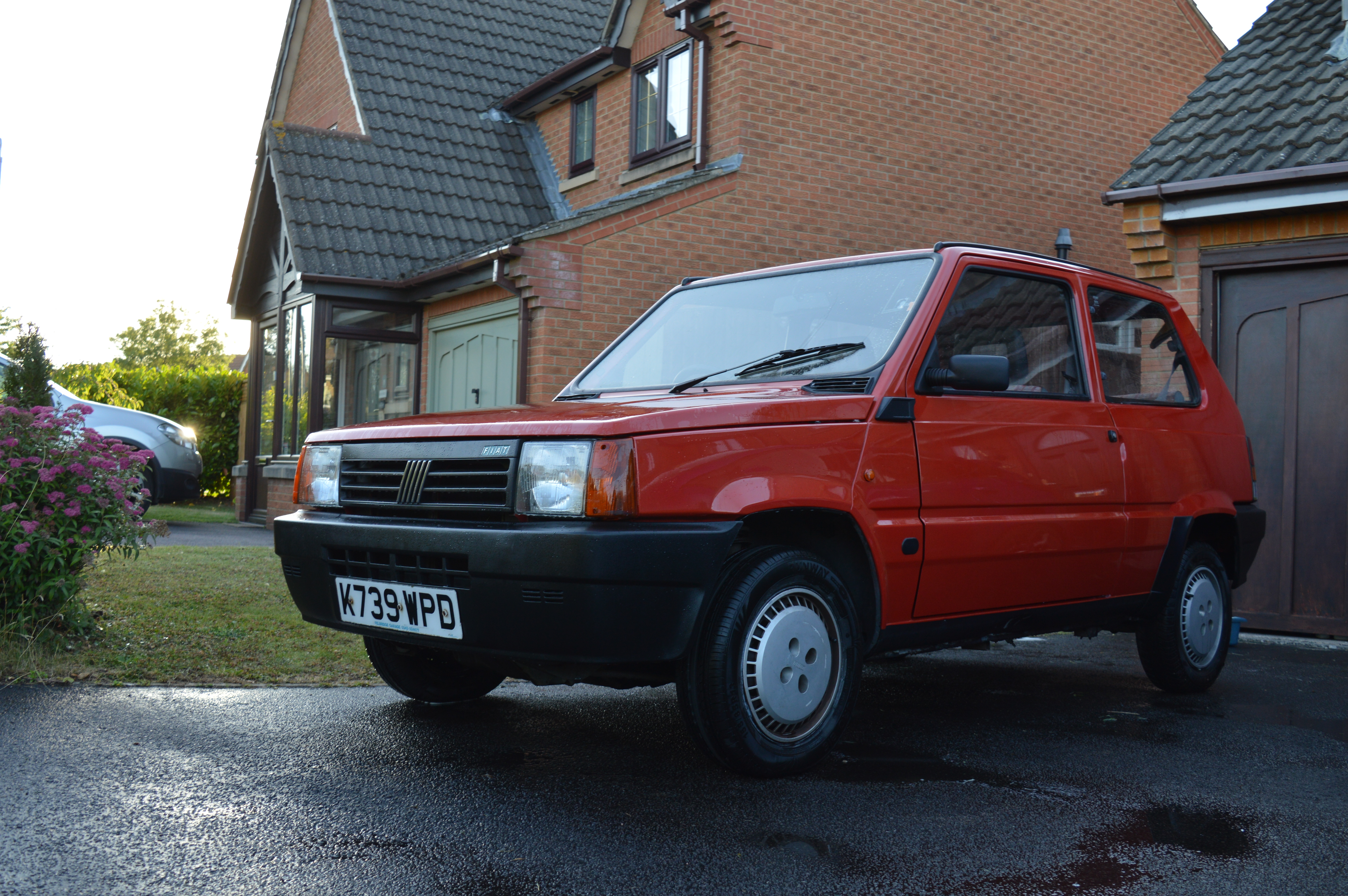

Finally got around to swapping the door/window seals/trims. Got the longer fits on the outside and the shorter ones on the inside now, so we're all good until the ones outside go bad again :rolleyes:
Gave the car its first "proper" clean today. Jet washed, shampooed and waxed, hand dried and polished all over, with some bumper shine and fabric cleaner to finish off. That ceiling is looking much better. Definitely going to need to get out that t cut for some scratches soon though, and need to get that touch up paint for all the countless paint chips :p Can still see where the Fizz decals used to be up close, hopefully I can get some done up one day, but that's not the priority - yet (y)
Oh, and also important - door has been bent towards the body now. It's not completely flush, but it now presses against the seal, so no more swimming pools when I get in my car after rain! I'm hoping it stays that way :worship:
Here she is, sitting pretty after the wash! Not sure what next, but the list is definitely endless... might have to get Fiat Forum stickers, eh :D
