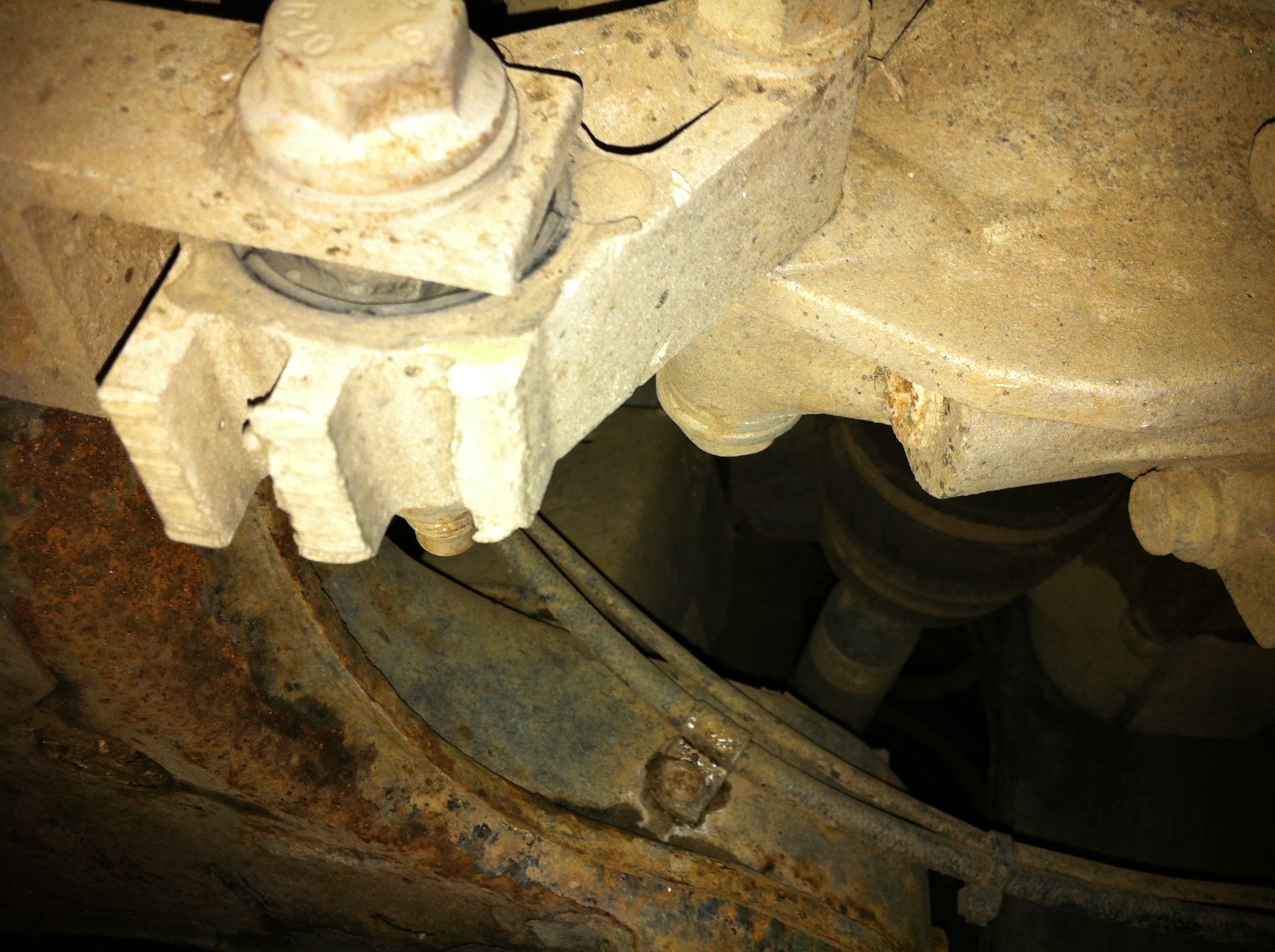

Fill I half way up the front, and drain rear edge pointing towards the bulkhead in a 45 degree recess
Thats brilliant thanks...do you refill until fluid runs from the fill plug or is there a particular amount from drained?
And if it's a job for this weekend, make sure you can undo the fill plug before removing the drain!
I know someone who got stuck with an empty gearbox cos the fill plug was seized!
Is that the drain plug?
