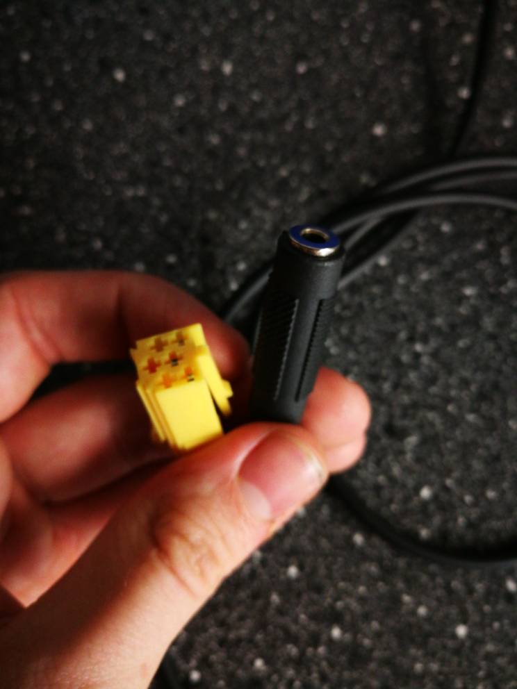

I tried fiting in this cable for aux in my 2003 fiat stilo with its original radio and the cable fiths but I cant get any aux mode or phone mode can someone please help me????FB_IMG_1503693279207.jpg
Unfortunately it will not work. There is zero chance to use normally these sort of cables with any of the original/stock headunit. You need to buy an aftermarket autoradio/headunit if you want to use AUX to get some noise out of the Stilos's speakers... :/
There is a way. Check this video. I personally did it myself and it works.
Credits to the guy Assis Fritas for the video.
