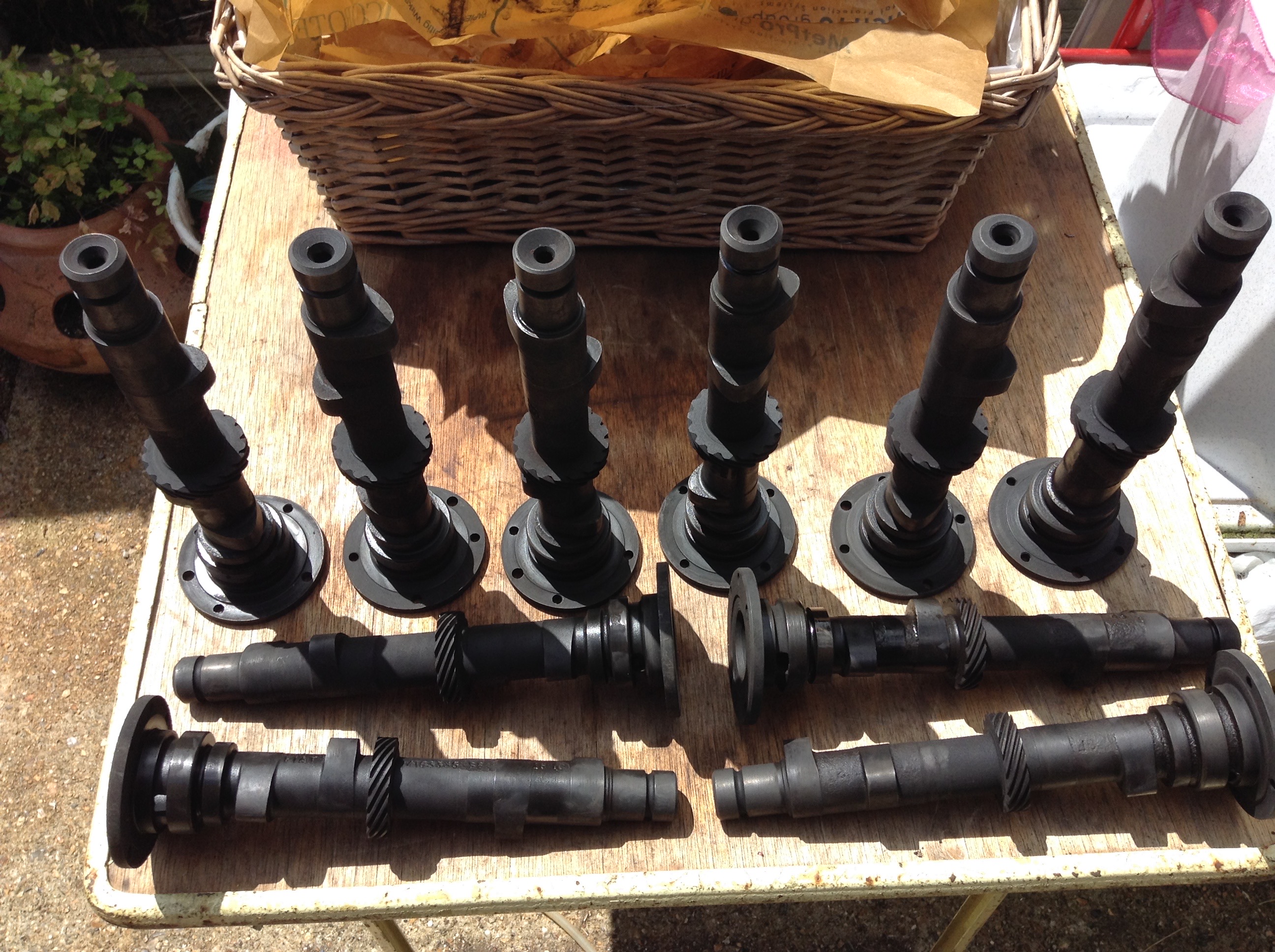

I can’t answer your question but I can tell you some of my experiences with cams. Some years ago I got together with a like minded pal to have a number of standard used camshafts reprofiled to a sport spec. Between us we had about 20 camshafts and initial inspection showed 3 had a very worn out lobe and we rejected those. They were all sent to the camshaft specialist and their inspection rejected another 3 so amazingly about a third were too worn mostly just on one lobe but also signs of wear on the fuel pump cam.
I have measured the lift on a number of cams from standard to Abarth and Alquati etc. 5.5mm would be a bit low as the smallest I measured was 5.7mm, a new Polish 126EL cam 6.55mm, a new Polish 35/75 cam 7.0mm and an Alquati 40/80 7.75mm.
I suspect that there are quite a few engines out there that are running worn camshafts on that evidence and I always recommend guys to inspect the cam if possible. The throw for the fuel pump should be 2.5mm I believe.
