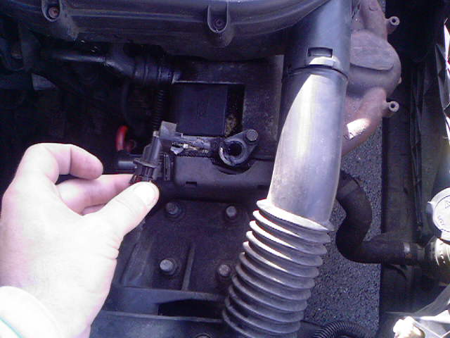

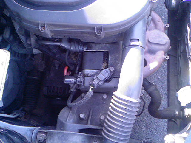

it is a 1.2 8vlooks like the crank position sensor, its a 1.2 8v right
A crank postion sensor would be on the crankshaft. Camshaft sensor- on the camshaft! As mentioned
its just the lastic housing tat has snapped, on tick over the engine feels like it is missing would ths be caused by the damaged sensor
thanks, i just put a new one on and its running better, thanks to everyone that gave advice much apprecaiatedHi mate,
Yes the cam sensor being broken can causing missing. Tbh, the condition its in, Im surprised the car is running at all. They are cheap and dead easy to fix.
Oh and its DEFINITELY the cam sensor.

It'll run without a cam sensor working- it just switches to batch-firing the injectors like the older Euro 2 engine, with less refinement and economy.
