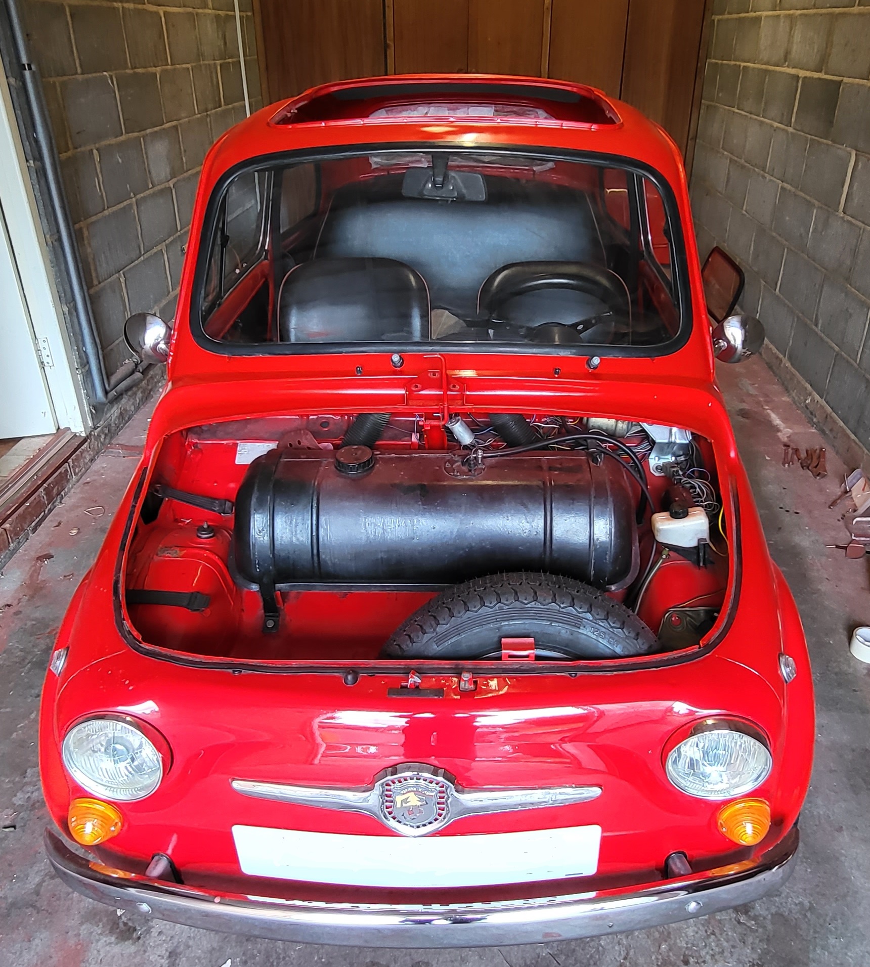

There are a couple of cracks in the paint on the roof of my new 500, and I thought I'd try touching them up a bit to keep the water and steel apart. A drop of thinners mixed with two of paint applied with a very fine brush and the crack wicks up the paint. It went quite well. A bit of fine sandpaper and polish and they should all but disappear. As they are very close to the sunroof, I thought I'd take it off so it doesn't get dirty. Oh. There's a massive crack with the paint peeling off hidden by the fabric roof 30mm by 20mm.
Ok, so chip out the old paint, fill, sand prime and paint. So far so good. Its the same paint I'd tried on the grille and it blended in nicely. But not on the roof. The new paint and the old are not mixing and no amount of polishing up is hiding the join. So what started as a small touch up job is going to end up as a full roof respray. Do you have any tips for getting out the windscreen and putting it back in again?

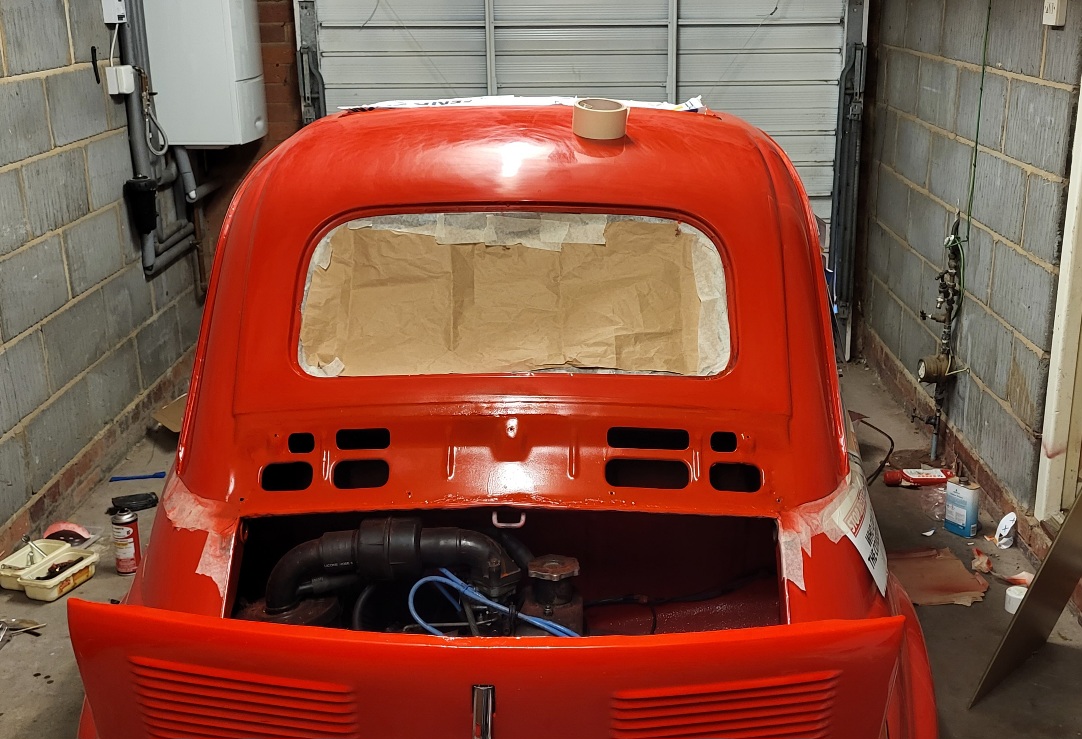

The rear window came out surprisingly easily. The front wasn't going to move, so I've masked around it. It has taken way more time than I'd thought to mask up the rest of the car.

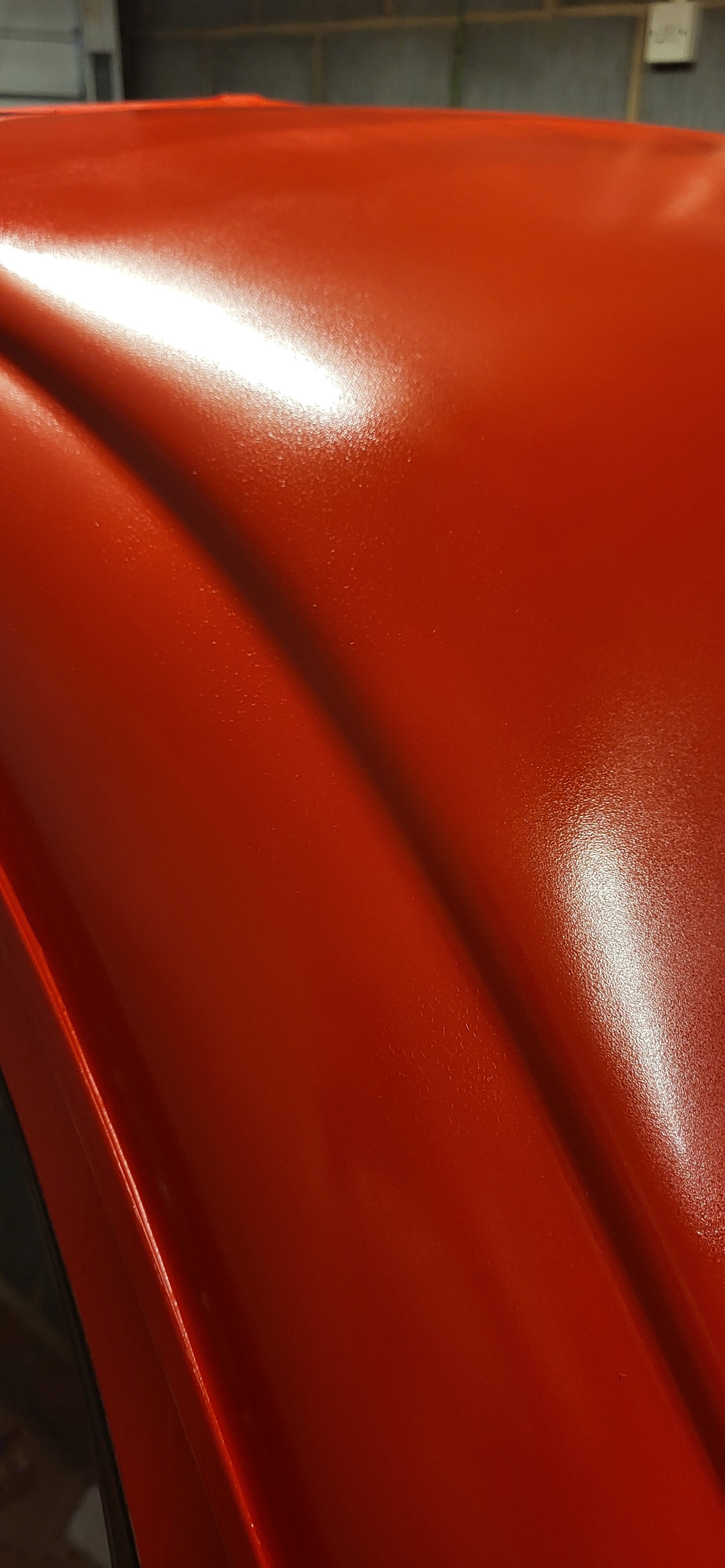

The new paint is on, with one or two spots that needed tidying up before the final coat. I'm fairly pleased with how it went. The surface is "textured" but flat which is almost as good as rattle cans get. There's a lot of flatting and polishing to do.
